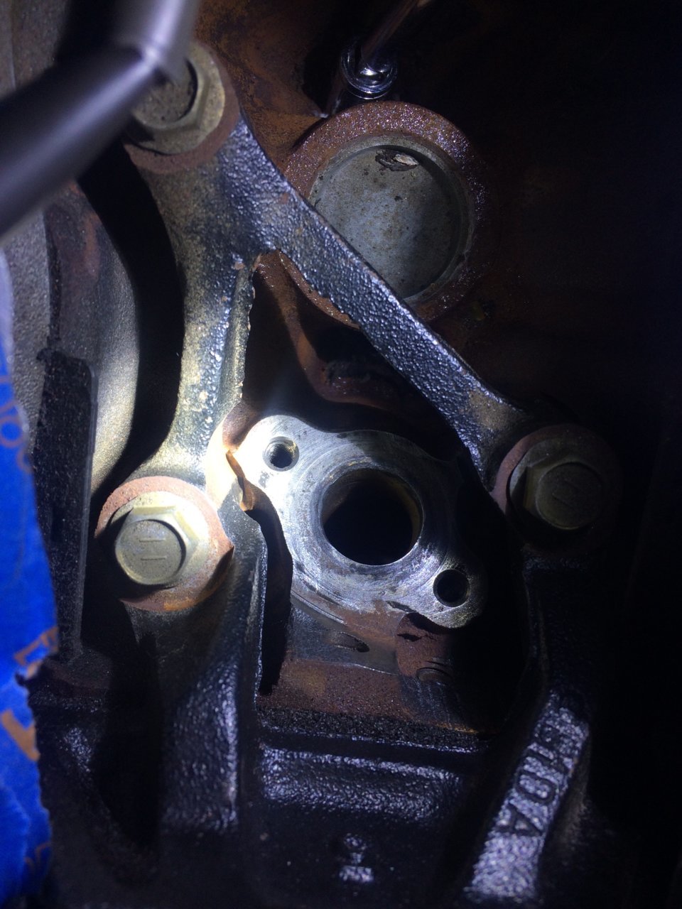

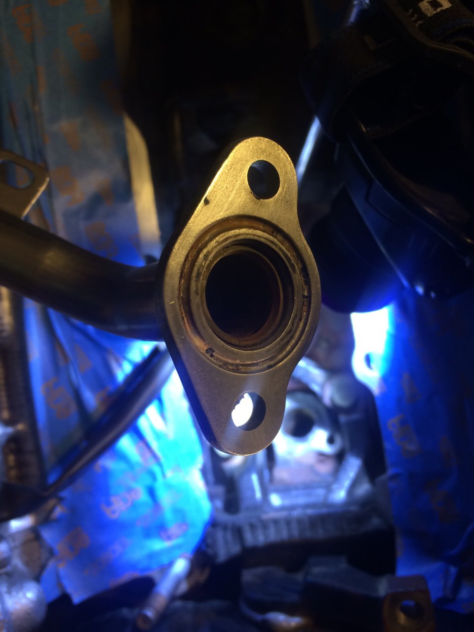

    On another note, is there a gasket for this pipe? It looked like rtv when I cleaned it, but it is not for sure since I don't have a ton of experience. I want to say the groove in the hose flange is for rtv?

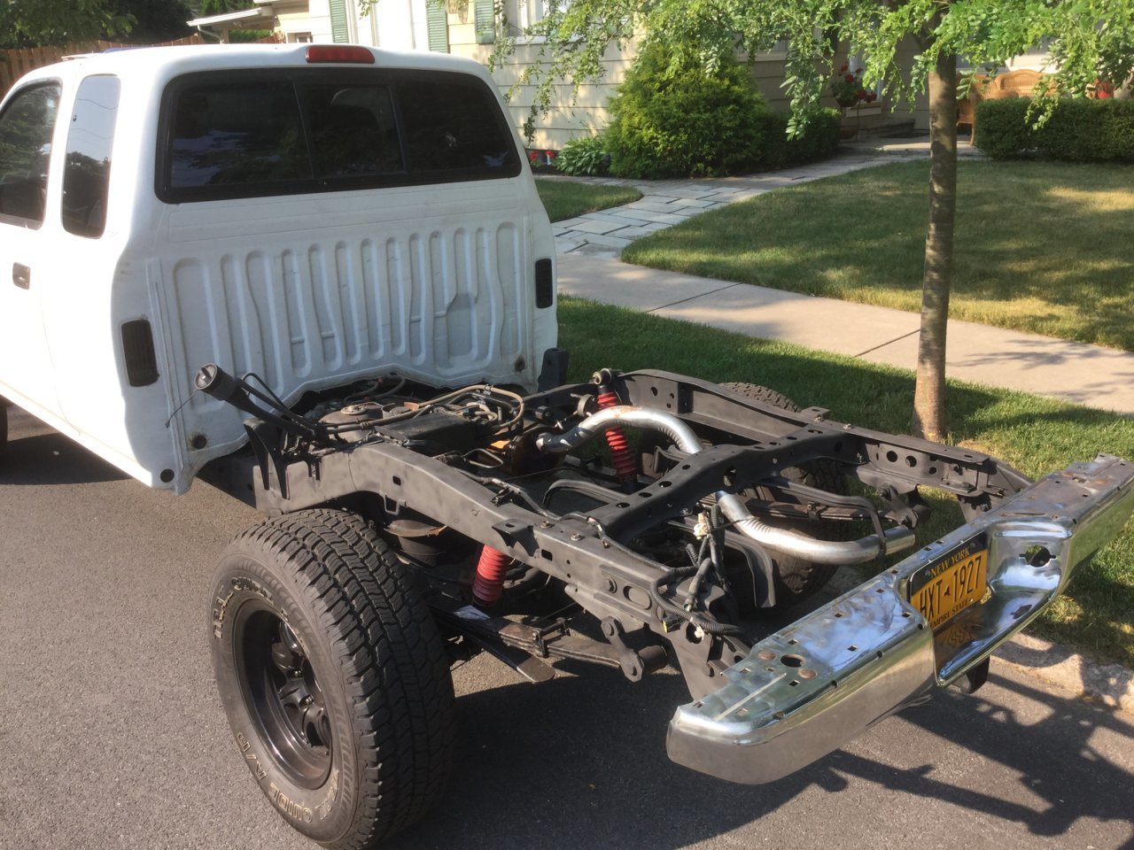

    As of yesterday - all back together minus the bed.

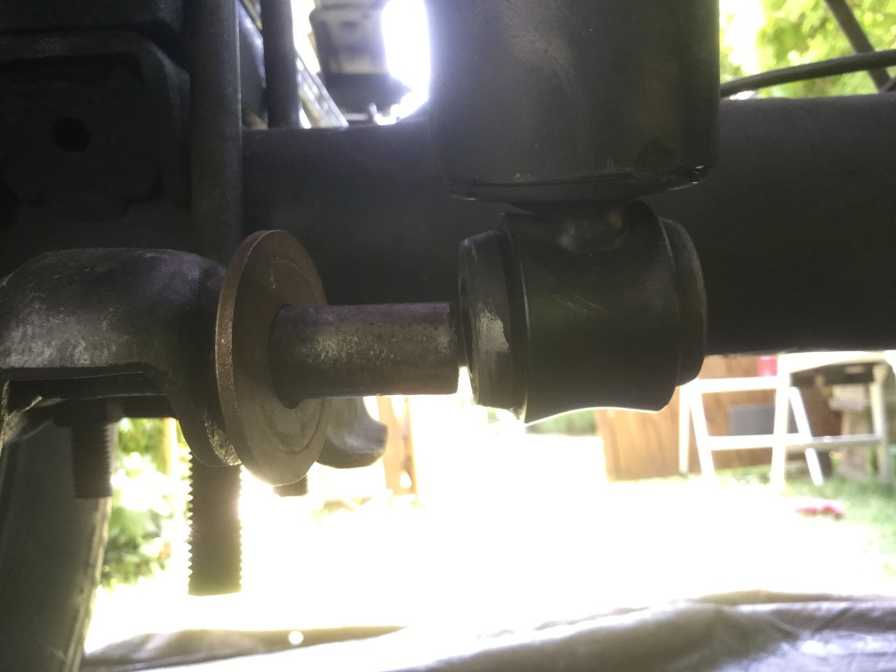

    How long b4 I blow out this rear “OEM” shock or bend the anchors???
    Gotta mod this motorcycle rack today, move the 2 outside chocks inward so can either have 1 motorcycle in the center or 2 side by side.
    gonna mount a hiboy jack on the top of the factory bumper & use it to support a tri-fold ATV ramp (without the tailgate) that folds thanks to the bumper step cutout. Maybe add some angles to carry the ramp off the back.

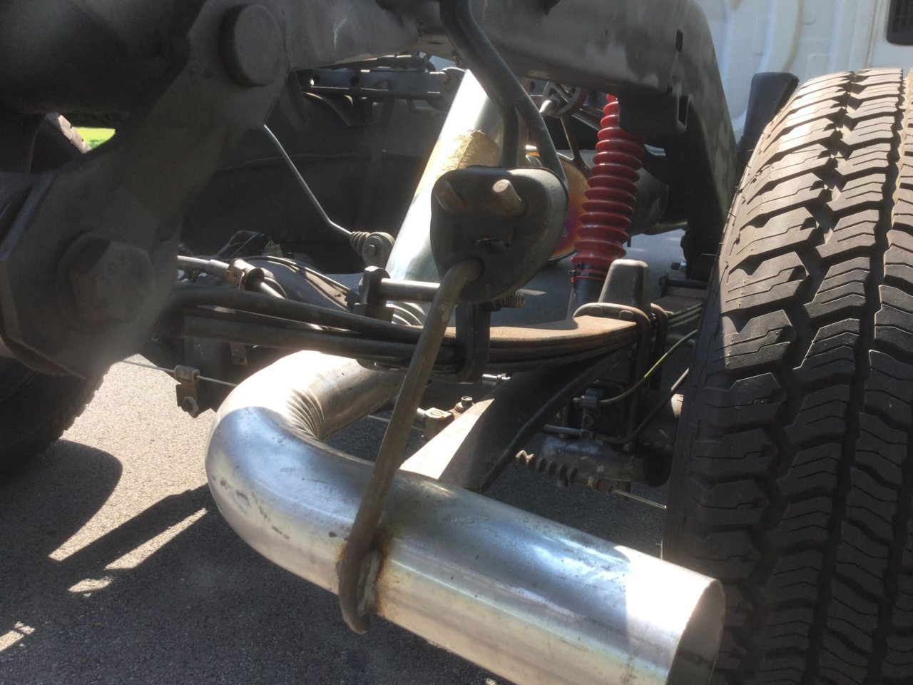

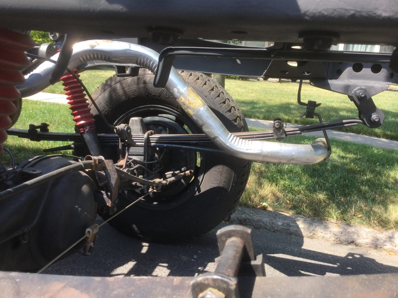

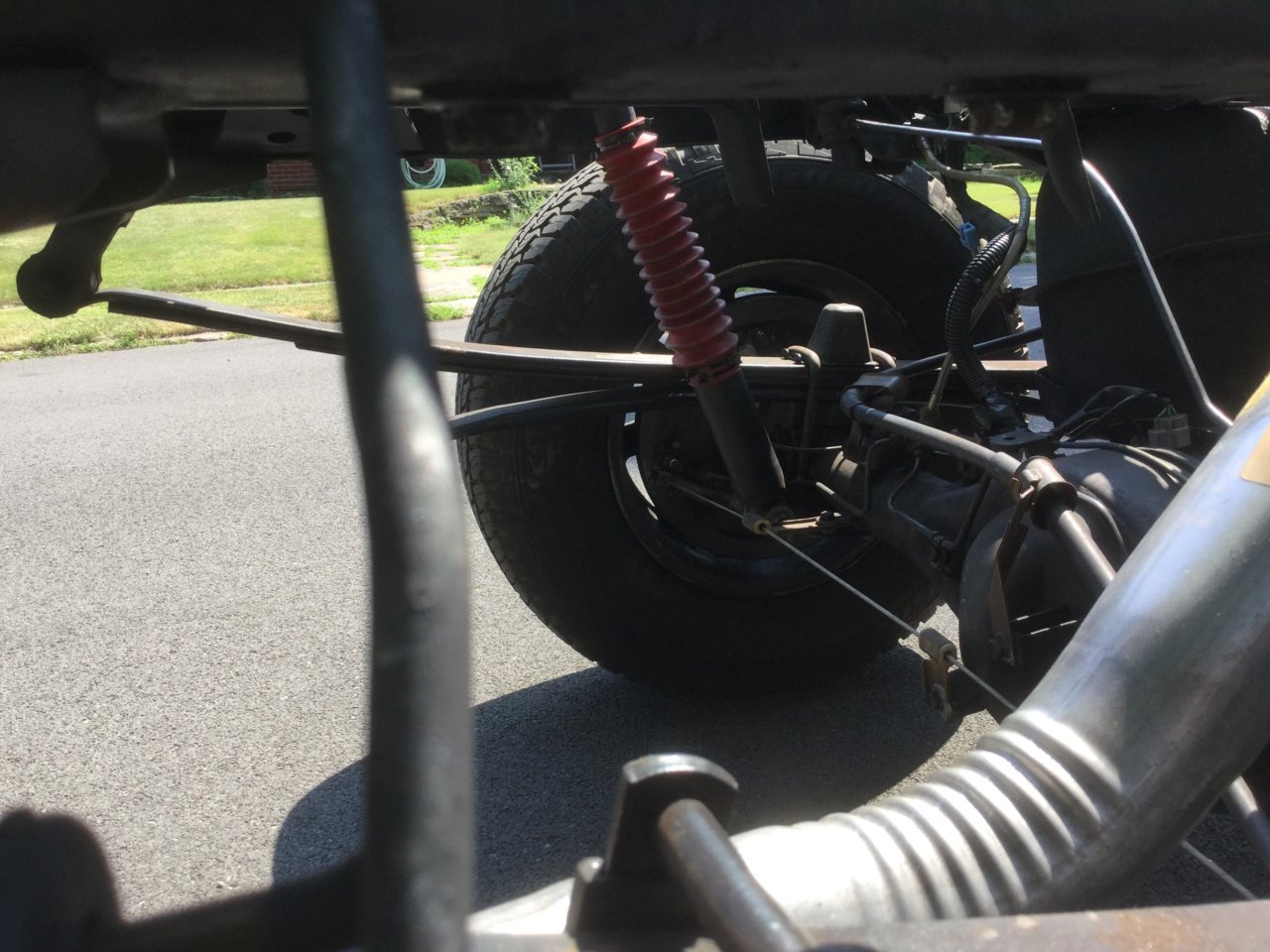

    for reference on the General Spring OEM leaf packs (non-HD) never been weighted & only about 20 miles with the bed on.
    Think I’ll send these picts to them, and see if this is what they expect. There is already a slight upward frown at the axle.

    RTV only no gasket or o-ring, coolant rated RTV at that. Make the surfaces as clean as possible. That (hidden) flange has been the the source of "mystery coolant loss" symptoms when all other possible areas have been double checked.

    Felpro is good stuff

    Those leafs are gonna sit flat. Thats how its designed to on these trucks. I realised that after replacing mine even though I didnt need to. However, once I put my add a leafs in, they sit more like how you'd think they should.

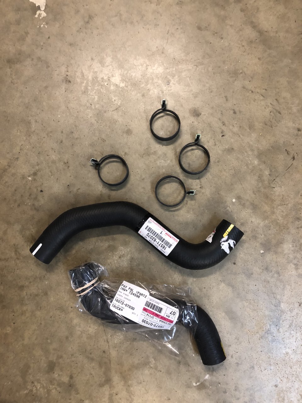

    591AB788-86B0-4320-8D3B-A4C6E21E5258.jpg Nothing too amazing, just a flush, new clamps and hoses... old ones looked original, not bad for 271K.

    takes the toyota RTV thats rated for coolant.. Shits like 80 bucks a tube... just get some coolant rated stuff from a store.
