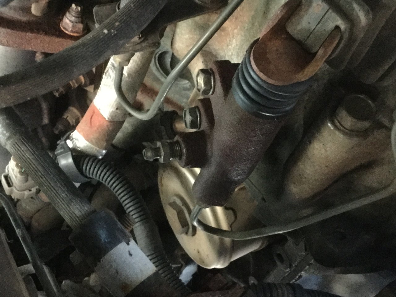

    oh... there’s no front transfer case? my bad, how about front diff opposite end of the transmission from the transfer case? :D
    reading the reservoir up front... guess I could drain and run (or push through) new brake fluid through there.... if I’ve changed all my other fluids. I see the fluid it quite dark. :D wrongly assumed it was part of the brakes, but now see it’s the clutch. :D

    Yeah my bad I gotchya now - it would be good to get rid of that old fluid

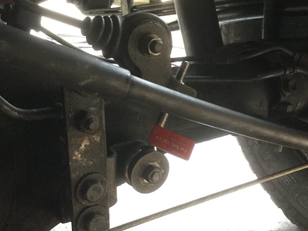

    replaced the threaded eye-bolt on the proportioning valve diff mount.... couldn’t get the 3/4” collar nut unseized, so cut and bought SS 5/16 x 4” eye-bolt & nylon lockers. Not using the extender so many of you have added for your lifts, so stowed it for safe keeping in place. With the original & without the extender I was still sitting at 100% up on the PV without even the truckbed on. Just had to open up the eye a bit. Will adjust depending on how the truck brakes now.7B967225-CF36-40CF-A89C-4752EB81CA68.jpg

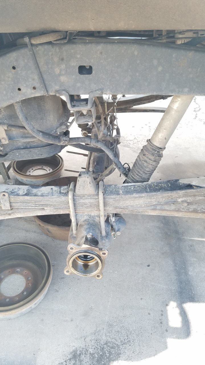

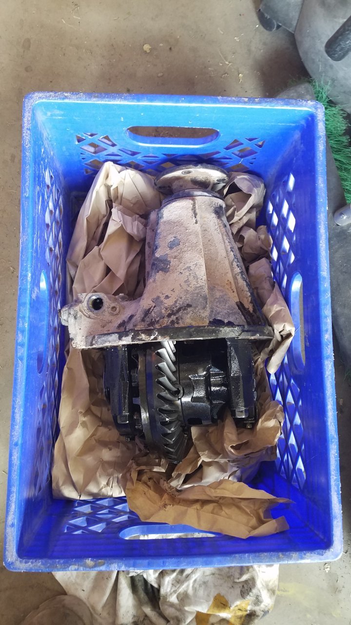

    Pulled my rear differential to take it down to Zuk to get re-geared to 4:88 this weekend.

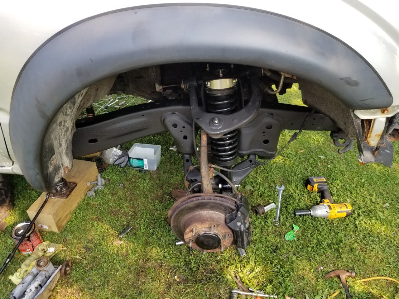

    Looks good, swap out those brake hoses while you’re at it.
