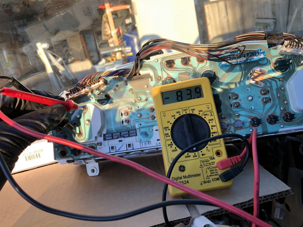

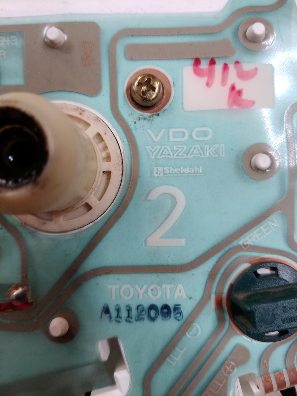

    I find it funny that it took four major gauge makers to put together the OEM cluster. VDO must be the designer, Toyota for the values and logic, and I'm sure Yazaki Meter actually made it. Not sure what Sheldahl is contributing though...
    Anyway my Fluke seems to be out of batteries so here's to HF haha ..
    @BartMaster1234
    It's worth mentioning this meter worked too so maybe you have the wrong value sheet?

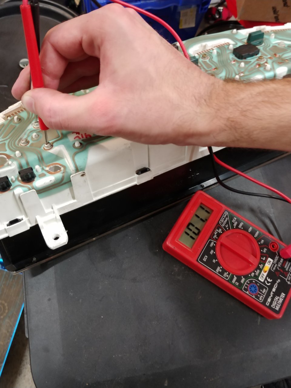

    That’s bizarre. That data sheet came from the 2000 FSM. Could it have been that Toyota has different resistance values over different model years?
    I’m stumped. I know the fuel sender is fine, the fuel float on both assemblies displayed the proper resistances according to the same PDF that diagram came for. The readings for the meter are all completely off.

    The gauge itself doesn't need to be connected to the truck's electrical system to test for resistance, right? I was testing the fuel sender outside the truck and it had the correct electrical values.
    What year truck is your cluster from?

    My gauge is from a 96, I have the early Taco FSM open right now looking for those tests, it isn't searchable tho so it might take a min

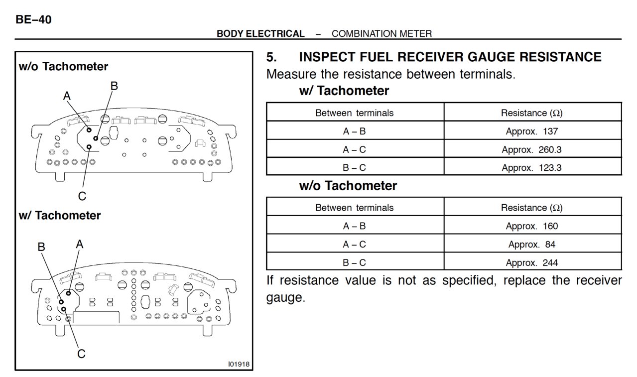

    @BartMaster1234
    This is from the early FSM, still doesn't seem right but who knows, my sending unit in the tank worked for the 95 and 96 gauge and the 96 gauge worked, maybe it needs more forward current for an accurate test

    I think you have a completely different gauge than me. Look at the bolt pattern of where it mounts to the flexible circuit board. Something had to have changed during the 1998 revision.

    taken from the 99 FSM
    84 on the no tach version looks awfully close to what you're getting...
    I would test the other letters and see if they are also close to the no tach version.
    I've had the FSM be incorrect before. When measuring the door lock actuator the numbers never matched up.

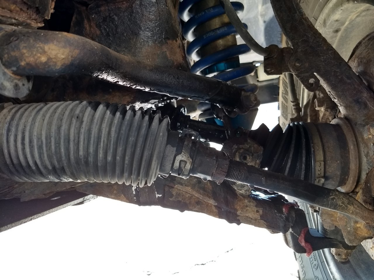

    IMG_20180711_161348258_HDR.jpg CV swap time!!!
