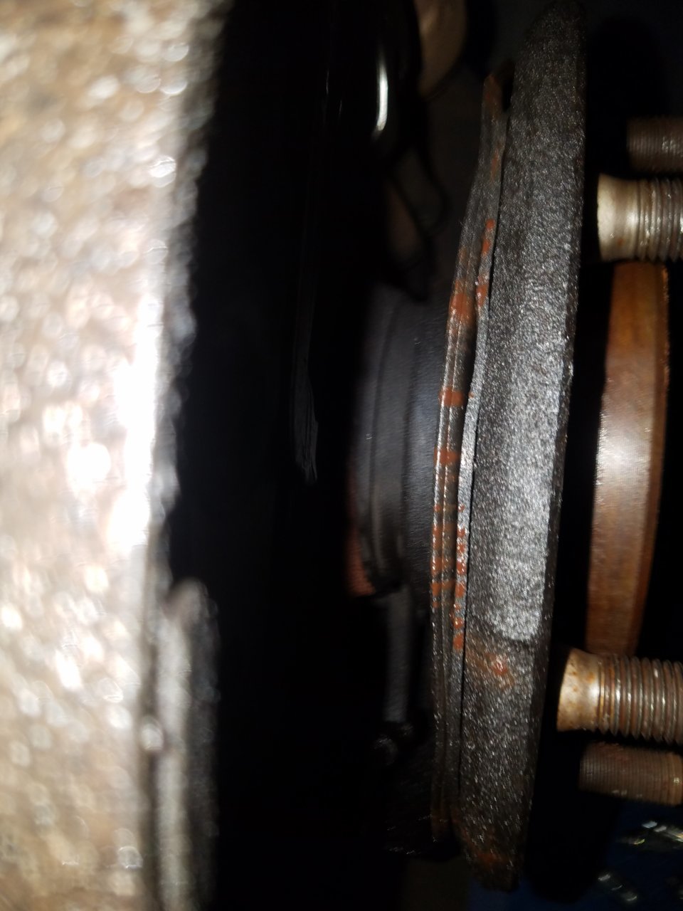

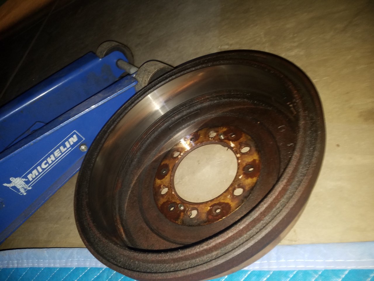

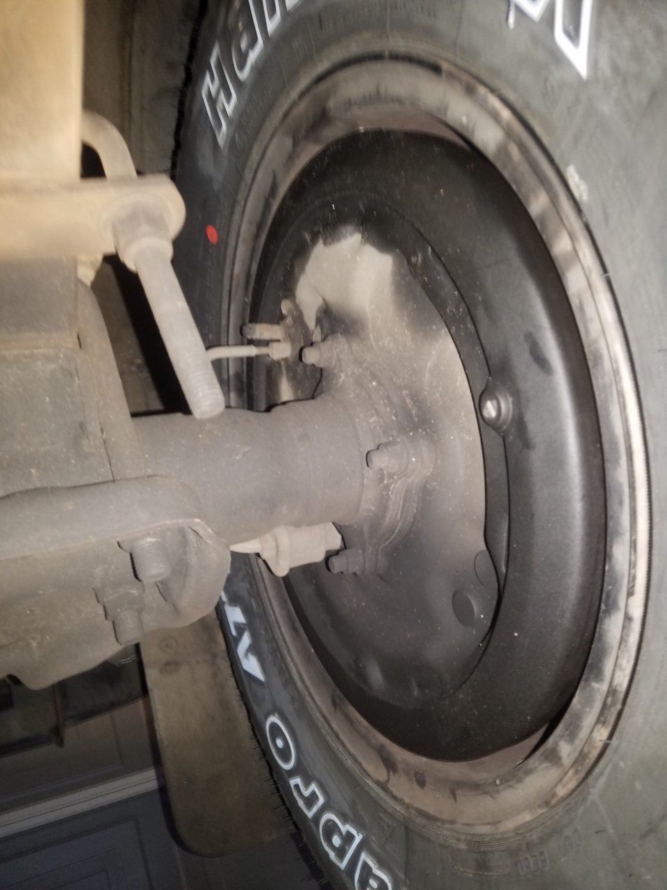

    I haven't had a rear axle seal leak yet thank god *knocks on wood* but I thought that usually showed up around where the axle meets the drum? That looks like it might be brake fluid but of course it should be pretty easy to tell via smell or touch. Let us know what you find out

    I got my 2nd axle Rear axle seal changed, 1st time was with 1 wheel bearing 1 zeal replacement , new shoes both sides, etc, that was $580 couple years ago. I noticed the leak last week and they honored warranty but just replaced the zeal , while being at shop some TW fellow chime in and enlighed me about changing differential breather , that should be #1 troubleshooting that leak.
    Big thanks to the couple fellows that replied to the issue.
    Last week visit thay only. Charge me $47 for the breather.(Obviously they will not admit they forgot this basic 1st time)

    Brake fluid is actually a little low. Will remove the drum today

    I'm voting axle seal as well but check your diff breather first.
    Mine started leaking earlier this year. I had inner & outer seals replaced along with new bearings. I know you've got a lot of miles so might as well do bearings too if you've never replaced em before.

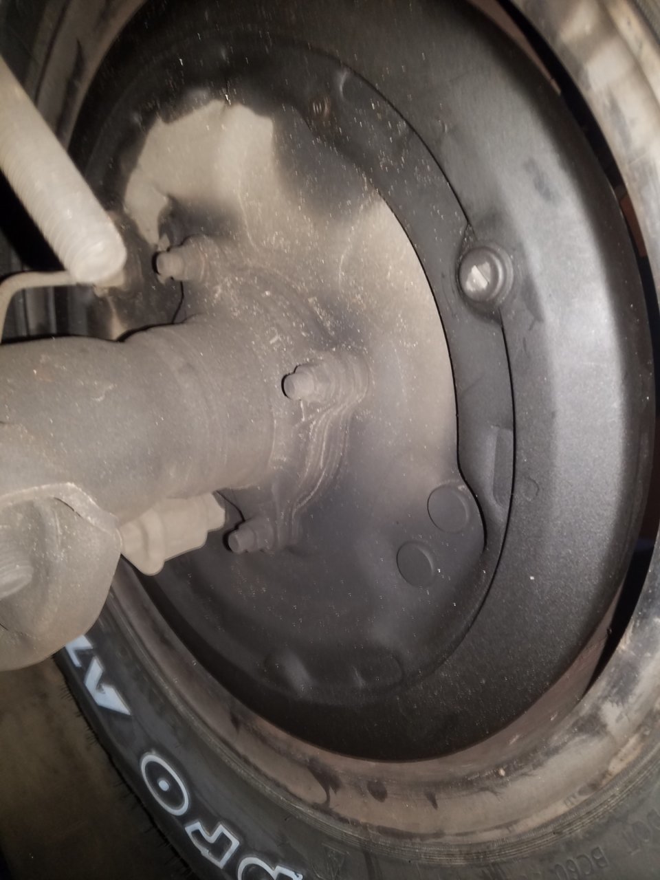

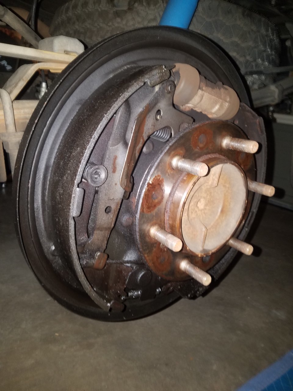

    Well took the drum off and it’s all wet with oil,
    Oddly enough the seal does not look like it’s leaking, but I know it has to be leaking
    and smells like diff oil.
    Also the diff breather is stuck closed, so that’s probably why the seal went out.
    Funny thing is 2 weeks ago I bought a new breather to replace my old one just for maintenance.
    So the seal is blown from the pressure from a bad breather valve.
    Do I fix the one seal?
    or do a full bearing replacement ?
    Do a full seal and bearing on both axles?
    zero4 likes this.

    I would say replace the breather, clean it all up with brake cleaner & see if it still leaks. But if it has been leaking for a while I would replace it. If you have never had bearings changed before, if it were me I'd have both sides & bearings replaced & is what I did earlier this year.
