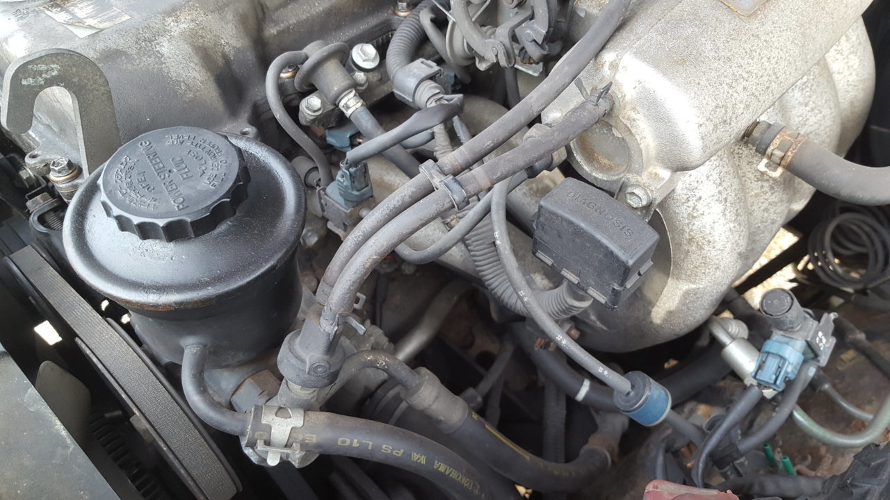

    @Jamesboy2233 and @Blackdawg and @m3bassman
    I currently have trucks with one of each engine, 1995.5s. It is only on the 2.7L.
    True or not, the dealer counter guy told me Toyota thought the 2.7 needed it when A/C was on and at idle. He said Toyota felt the P/S would feel too weak, so it is supposed to idle it up a bit.
    Like Jamesboy said, you can plug it. They are super expensive to replace(+$200) with OEM. My Dad's got brittle and snapped and I just capped it since his AC is dead anyway. Haven't noticed any ill effect.
