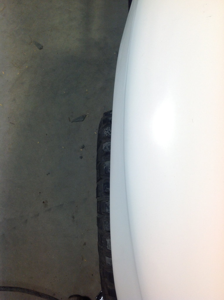

    4.5'' flares..still..don't cover my tires..haha

    Engage Offroad long travel front and rear with some fat tires.
    something must be wrong with me, cuz i was looking at the reflection of the topless girl in the upper right hand corner of the pic...
    :confused:

    i had the same issue, so i went with 6" and they still barely cover... haha

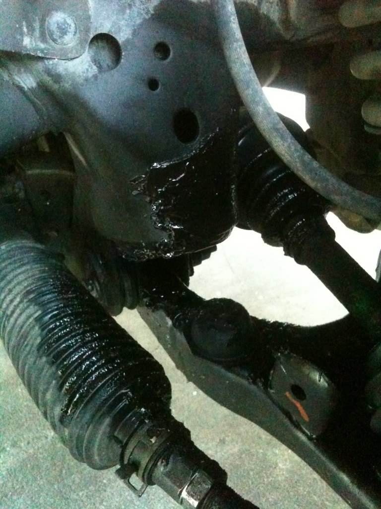

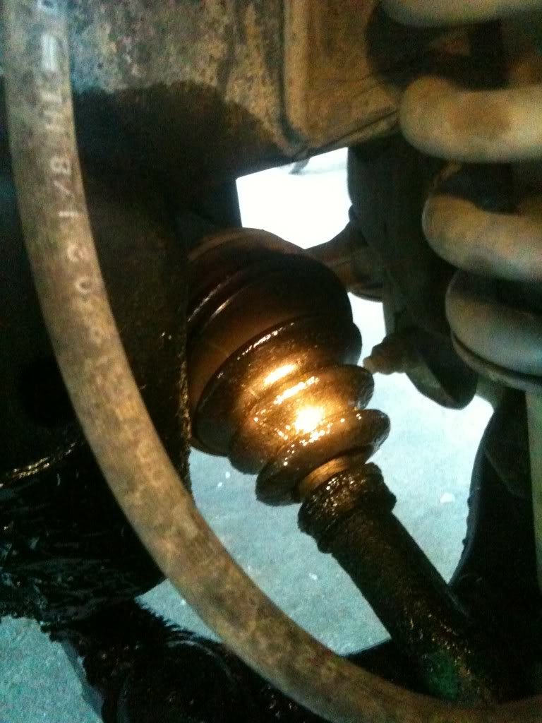

    Do I have a blown cv boot?
  9. Jul 18, 2012 at 3:46 PM
    Blackdawg
    Blackdawg Dr. Frankenstein
    Dec 31, 2010
    #48500
    81,610
    Monte
    Wyoming/St. Louis
    The Trifecta of Taco's
    Yep..well the inner boot is ripped off if that what you mean..CV is probably fine and functional. But its throwing grease everywhere.
    Id get it fixed soon.

    Thanks blackdawg
    Yeah I meant the inner boot. Is this easy to replace? Do you know of any write ups?
  11. Jul 18, 2012 at 4:19 PM
    StAndrew
    StAndrew Wait for it...
    Feb 8, 2010
    #30950
    8,310
    Hampton Roads, Va
    SR5 4x4TRD
    Intake, exhaust, lift. Typical stuff.
    Check out this link: http://www.tacomaworld.com/forum/1s...y-how-thread-compiled-list-helpful-links.html
    CV Axle Replacement/CV Axle boot replacement:
    http://www.4x4wire.com/toyota/maintenance/cv_axle/
    http://www.customtacos.com/tech/index.php?article=113
    http://www.tacomaworld.com/forum/tec...dd-tacoma.html
    http://www.tacomaworld.com/forum/2nd...s-2nd-gen.html
    There are two imbedded videos including one with a step by step disassemble and reassemble.
    If you want new axles:
    I just purchased 2 rebuild OEM CV axles from CVJ Axles (http://www.cvjreman.com/) with high angle silicon boots for ~$230 and a $150 rebate if I send in my old set. They are $60 cheaper without the silicon boots. I ordered today and they ship tomorrow. Great ppl and great service so far.

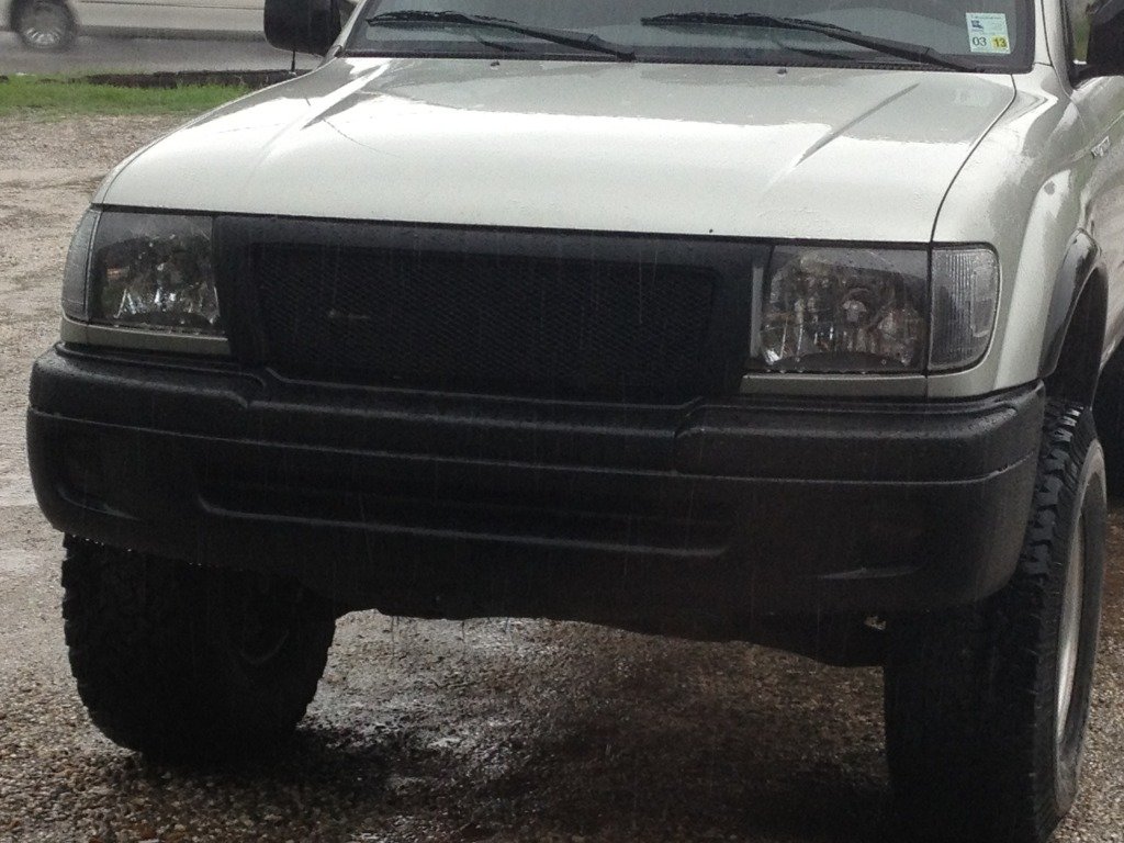

    had a satoshi style grill fabricated at a local customs shop.

    There ya go alpha.
    You can always go to a local junk yard too. Whatever you do try and get ome axles as they are the strongest.
    You cab also get boot kits from rotors so if us find a good uses one yo put in you can then rebuild the tore one for a spare. That my pan with my tore boot.

    That looks really good man! I like the thinner-lip style better especially on the 98-00 grilles. How much did that cost you to get made, if you don't mind me asking?
