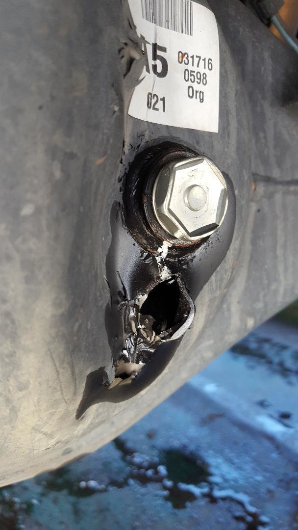

    Probably something not fine, maybe I’ll take it apart when I find a donor.
    Shouldn’t be too hard I hope.

    All tacoma elockers are 4.10
    so..you aren't running a skid?
    Did it lock up as well? or just a loud noise?

    Yes I’m running the factory skid, I’d imagine it tried to lock up.
    Also, cheap aftermarket box -1000 points

    I mean as in when it went bang did it kill the motor and instantly lock up and stop you? As in you can't drive anymore. Or just bam. Wtf was that and get out and see it?

    Oh no, I drove home, went bang, got out, saw some shit, turned around and come home.

    Odd.
    Well consider yourself lucky then haha mine about threw me through the windshield.

    Oh, it definitely was a smooth loud noise, there was a jolt.
    Mines better baking a noise for longer than I want to admit, thought it was a cv axle, I’m sure that had something to do with it.

    What caused his? Does he know?

    The diff went nuclear as the photo above showed. Sucked the pinion into the carrier.

    When's the last time you changed the gear oil in the front diff? If it was too low, dirty, contaminated, worn, etc. that could do it.

    The chance of it gernading cause of old diff oil is real low imo. Most people outside of this forum dont even know theres oil that needs changed other than the motor oil. Id bet a lot of older vehicles are still rocking their original gear oil. I dont think my 92 has ever had the front changed. The rear was only changed cause an axle seal blew. Maybe one day Ill get around to changing it.

    Yeah I work with a few people that think their cars don't need anything other than gasoline and even then, they only realize that when it's running on fumes. I dunno just trying to think of what might cause such a catastrophic failure outside of abuse (like spinning the tires when stuck)...if it just blew up on him after putting it into 4wd I imagine its been a ticking time bomb for awhile now so maybe something else triggered the damage awhile ago and it just now got to it's breaking point.
    Call me crazy but I change all gear oil out every 20/25k... not very expensive, easy to do and above all it's worth the peace of mind
    edit: I take that back, manual trans I push to ~40k because Redline MT90 is expensive lol.

    North Carolina
    2018 Sport
    Yeah thats a little extreme even by the book (35k I believe). I did mine when I got the truck at 50k. Ill do it again at 100k most likely. Havent done the trans yet, cause redline is expensive lol.
