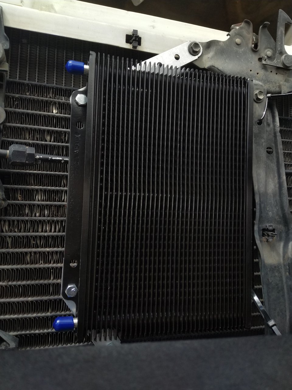

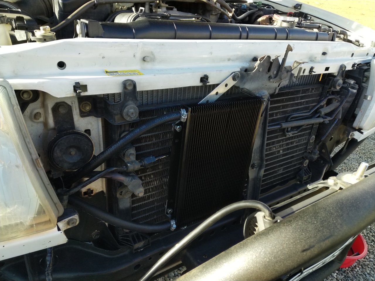

    Installed my aux transmission cooler this past weekend. Installed it after the stock cooler in the radiator so it goes out of trans, to radiator, to aux cooler then back to trans. Super easy to install, just had to buy some extra 3/8 id trans fluid hose. This is the cooler I got for those interested: https://www.amazon.com/Long-Tru-Cool-Transmission-Cooler-4454/dp/B005XZXB1M
    Temps were around 180-200 around town before the cooler, now I'm seeing 150-160.
