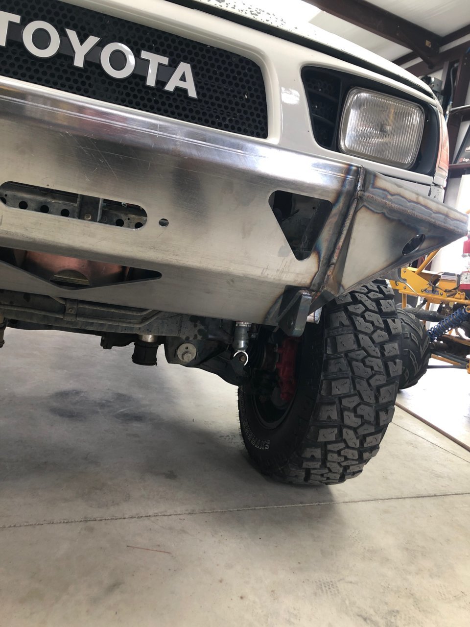

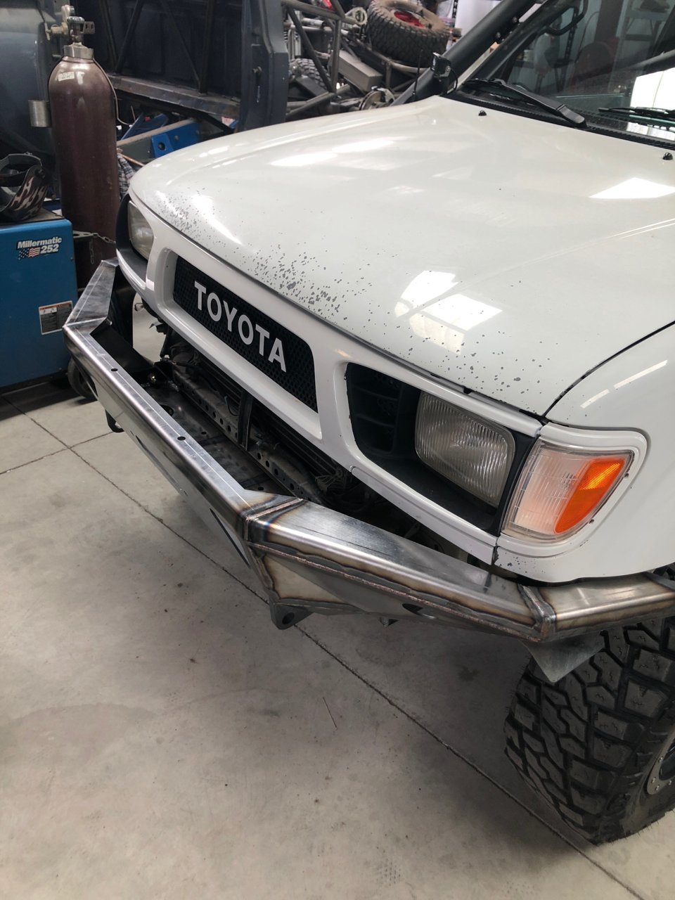

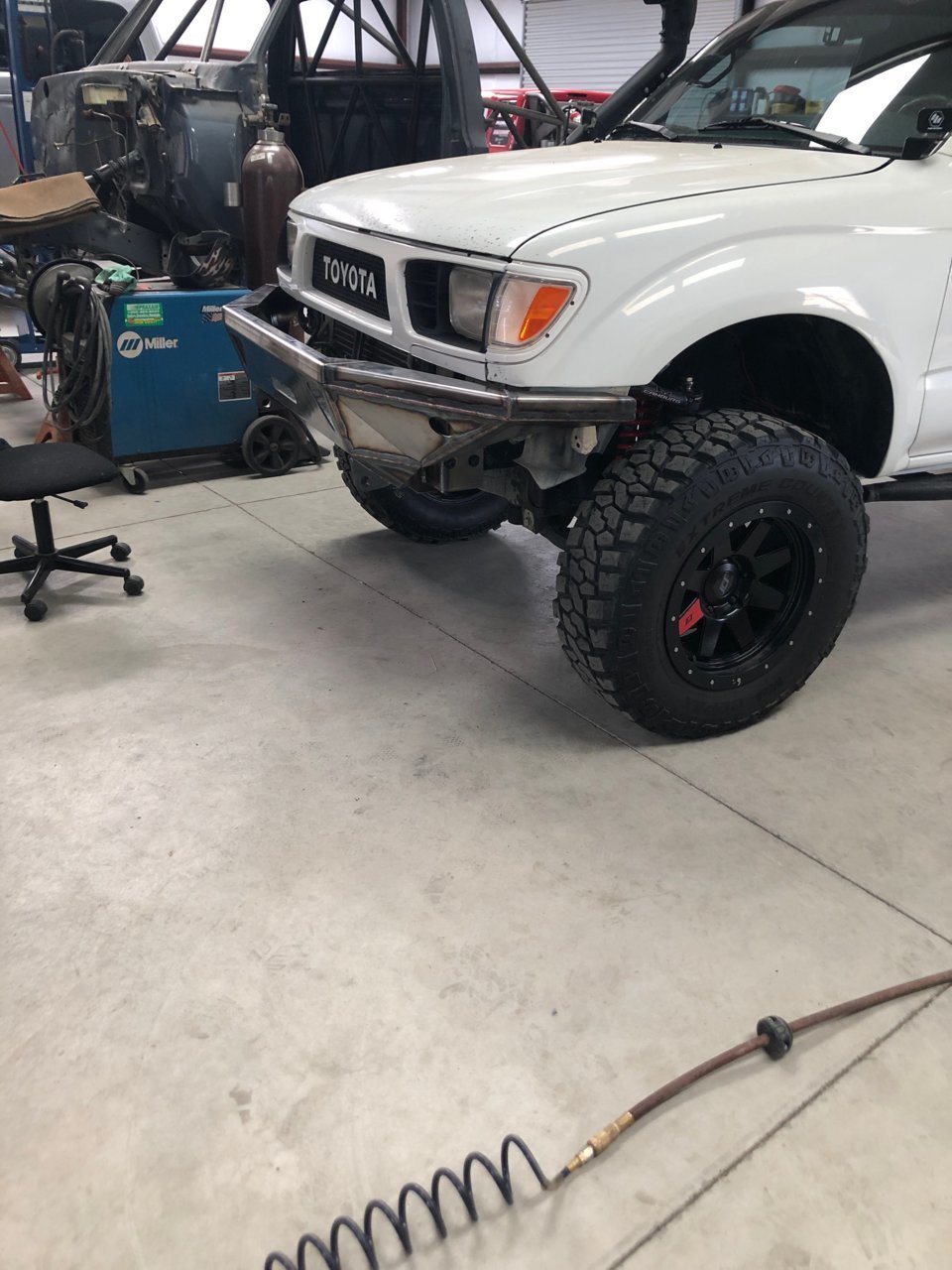

    Too many…
    And it’s done B0589FDC-CE8B-4AF3-A3F7-C5ED202B1E02.jpgB2A106C2-F4D7-43AC-9288-B7FC1D01C819.jpg8D6158E2-B69C-44D1-A7DE-C0D282C55C36.jpg

    Did you flip flop the turn signal pieces for a reason?
    Edit: really diggin those wheels btw.

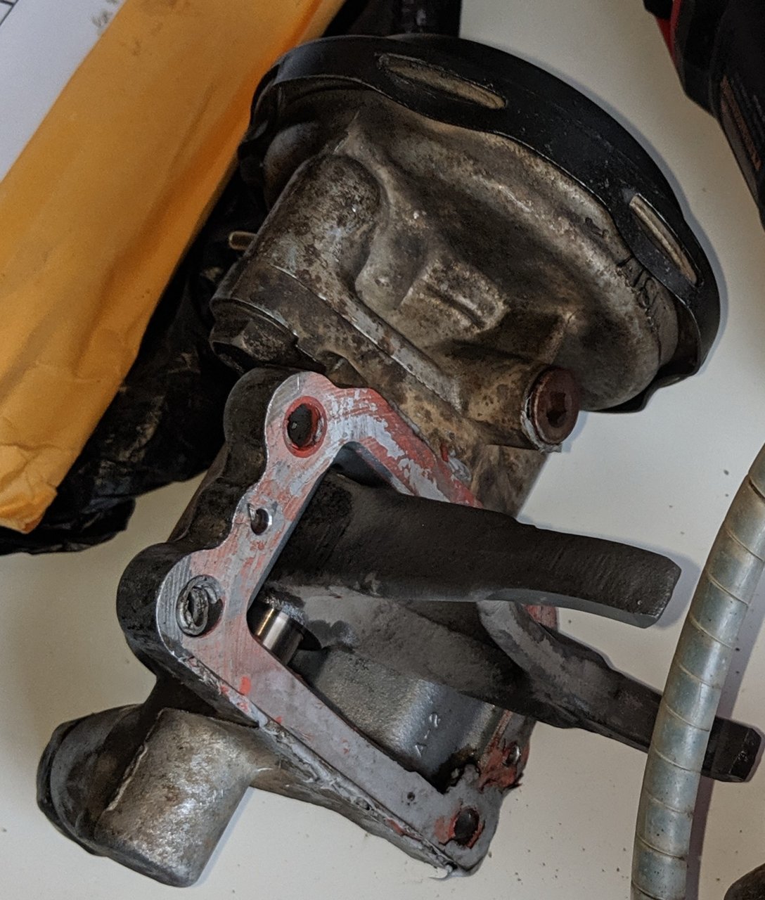

    I hate this damn thing.
    That is all.

    Set it in the locked position and forget it.

    Just cap the vacuum lines, set to engaged, and never worry again?
    Edit: Just confirmed in a couple different spots... Gonna leave it engaged remove the vacuum lines, cap and change oil with rear diff... Also hose clamp the fork.

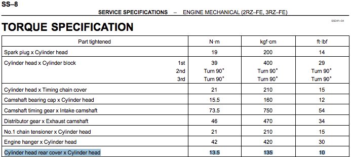

    It's too late, I snapped a bolt off.
    Toyota is WRONG!!

    Just snug it down and do another 1/4 - 1/2 turn

    That's the rear cover, for the coolant port. Not the VC

    If that's the case there is no torque spec because I can't find it.
