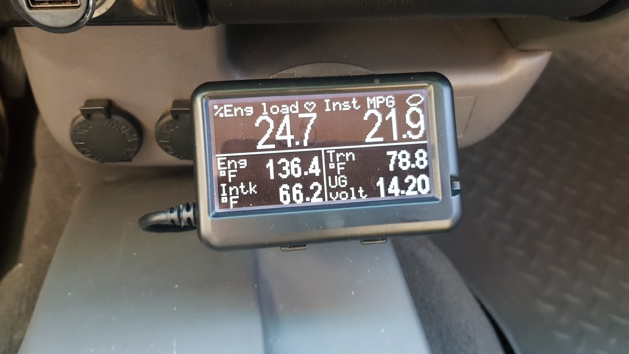

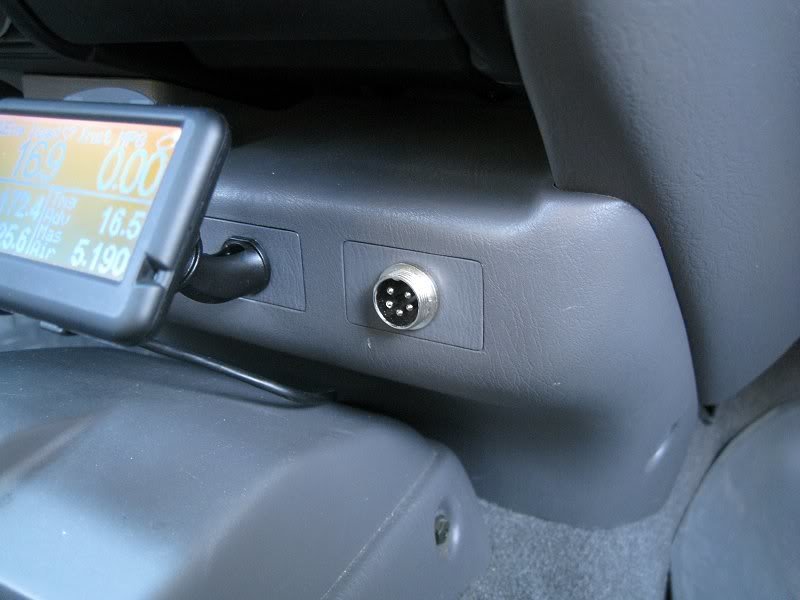

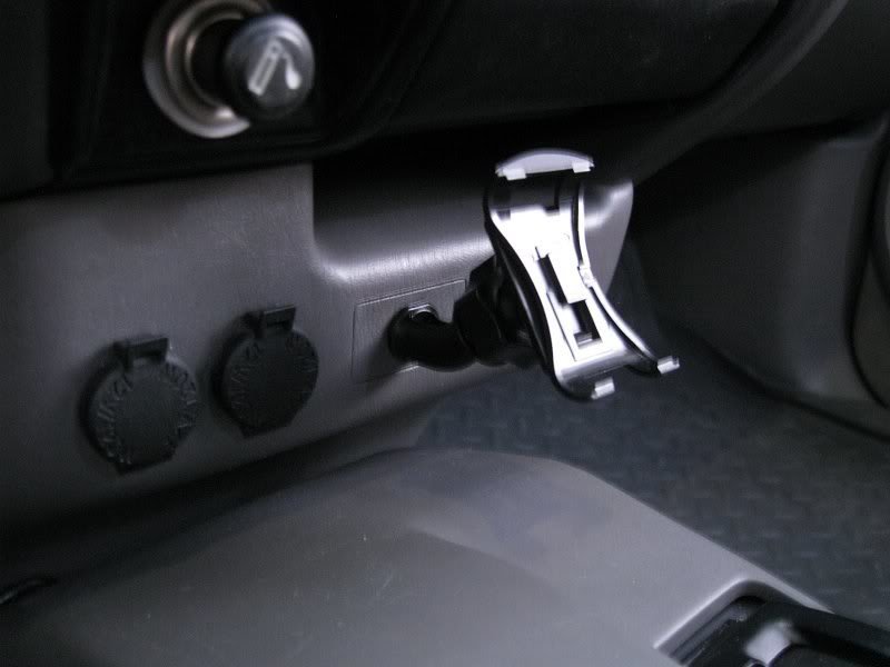

    Does anyone have pictures of how their UltraGauges are mounted? I’d like to put it front and center on the steering column but I’m not sure how it would fare.
    FLBAdrian likes this.

    I was thinking of you when I was writing that post. I was almost tempted to type “besides @zero4” because I still remember exactly how yours is mounted, haha.
