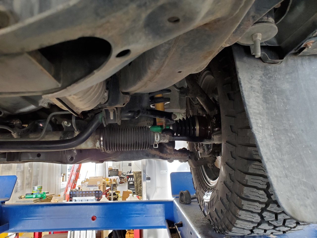

    Replaced my inner tie rods and got an alignment done. I need to replace the UCAs as they couldn't get the alignment right but enough so it wouldnt pull.

    Is something bent? Just replacing the UCAs isn't going to change the alignment unless there is something wrong with the current ones. You might try taking it elsewhere for a second opinion.

    Right. I had a bent spindle for awhile

    Not sure. He said the UCAs were frozen and they couldn't get them to adjust. So the technician who did the alignment set it so they were even between the tires and wouldnt cause them to pull.
    I've got an in-house mechanic at work who said he could do both the upper and lower control arms for me.
    Was planning on doing them anyway. But I'll ask him to put it on the lift at work and see if anything is bent.

    You either heard wrong or they are a terrible shop.
    Stock UCAs are not adjustable on our trucks. If they were actually "frozen" that would mean that your suspension has ZERO travel and you would know something was wrong when you hit a pothole and immediately were thrown into a telephone pole.
    LCAs (Lower Control Arm) is likely what they meant to say (you should have heard). Best is OEM replacements, but having a shop do that will cost you over $500 as that's just about the retail price for the parts - without labor.
    The common fix a lot of us do is remove the LCA, remove the stock rubber bushing and press in Whiteline replacements (Part # W53377A). Do yourself a favor and read this thread. https://www.tacomaworld.com/threads/lca-bushings-oem-energy-suspension-whiteline.394935/
    Worst case, if the adjustment cams/bolts are frozen, you'll also have to buy replacements of those. OEM prices are quite expensive but they are supposedly the best quality.

    Yeah as stated above they must have meant the LCAs. The bushings do tend to freeze up after a while, you can usually replace them without having to buy all new LCAs.
    Definitely recommend the Whitelines, you’ll want to get new adjusters to go with them as you’ll need to cut them apart most likely.
