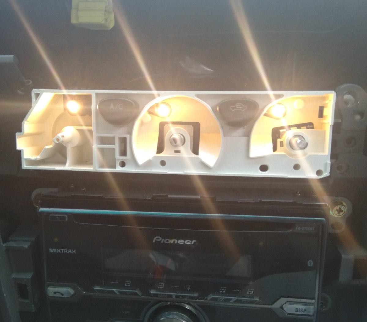

    how hard is the bulbs to get to? also is there one for the gear selector my son is having a hard time finding drive in the dark lol

    Not bad. You remove the plastic trim piece below the stereo (two clips), then remove the A/C control plate (just pop it out with a pry tool). Then the black stereo bezel is held down by 3 or 4 philips screws and a couple plastic clips, just pull it towards you. Then there are a couple more phillips screws holding down the A/C control unit, once you have it free there is a wire connector on the back to unplug and then a few more screws to remove on the back of the A/C control unit. Then you can swap out the bulbs.
    Plug the connector back in and test before you put everything back together. If you're using LED bulbs and then don't work the first time you probably need to flip them around.
    I have an M/T so I don't know about the gear selector bulb, but the one thread I found said the Toyota P/N is 90981-11018.

    are these just plug an play what is the deal with a resistor and where would it go?

    Yep, plug n' play.
    I have LEDs in the instrument cluster, overhead map lights and interior light. They dim with the door. I have never had to solder any resistors. I don't know why or what to tell you but perhaps it's just an 02 thing. I've posted links to the bulbs I've used and one reported they didn't work for him. :notsure:
