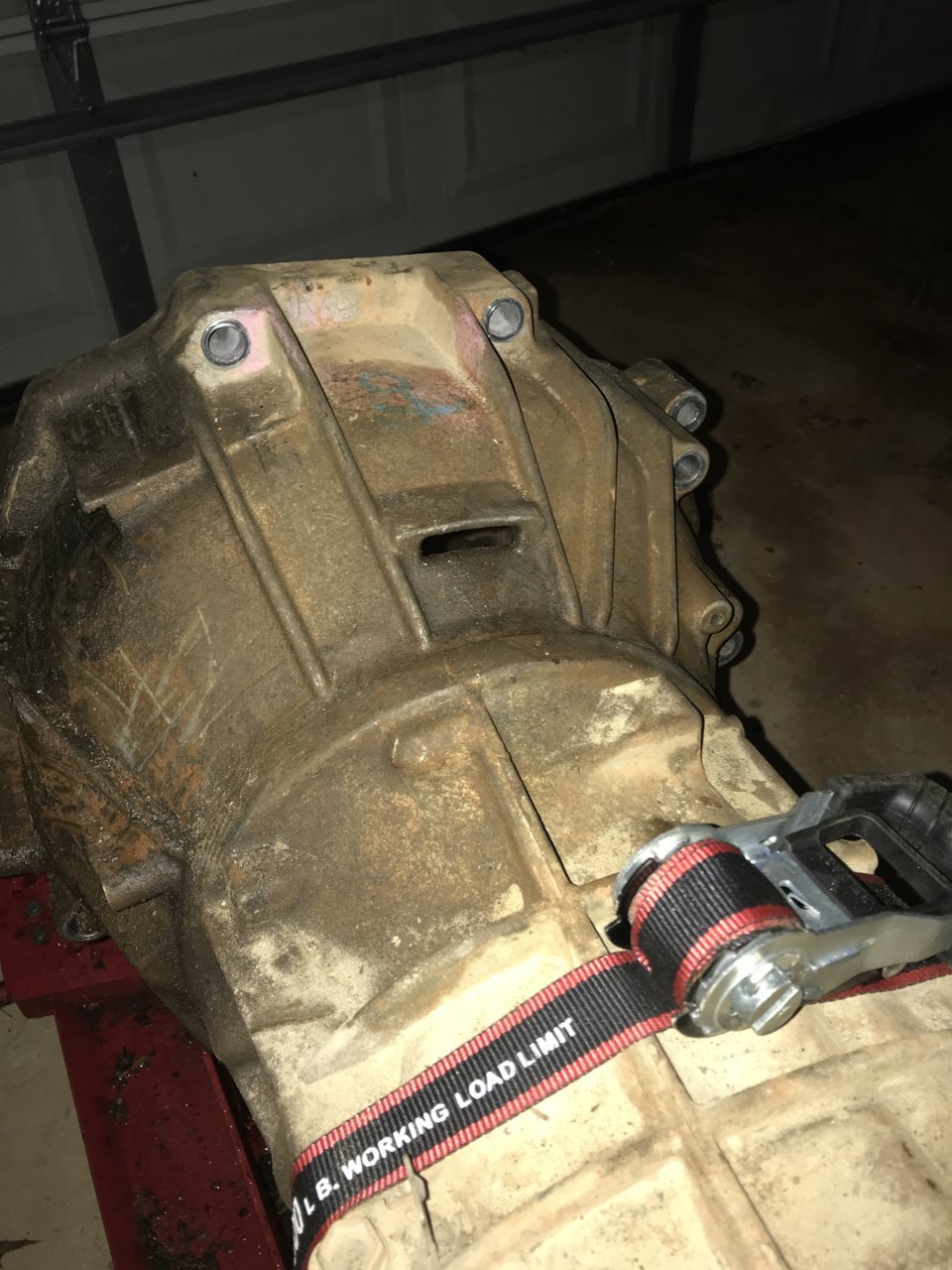

    One last thing for the night do you guys have anything in these “vents” on the bell housing? Kinda seems odd that there wouldn’t be anything blocking these from getting flooded with crap
    Don’t mind those scrapes that’s me trying to get all the sludge/mud off

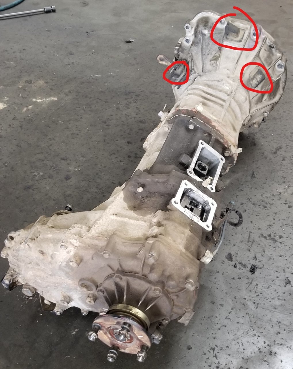

    My manual tranny has a rubber boot thing that goes over a vent on mine in multiple places.

    Well I guess I’ll be ordering some here soon. Must’ve happened when I sunk the front end and then shit got inside which ruined my clutch and rear main

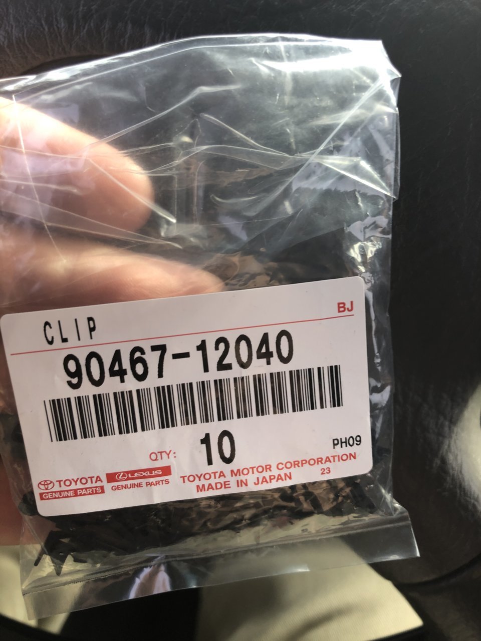

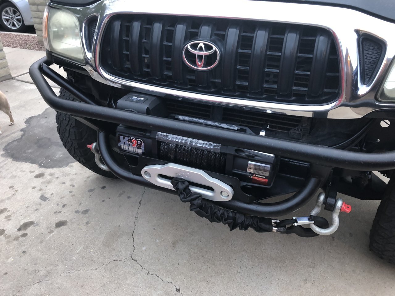

    Installed a winch!
    and replaced all of my grill clips during the process

    I have the W59 tranny so keep that in mind. could be different than yours.
    If mine didn't have those rubber boots, there would just be gaping holes. Yours are more of slots than holes imo.
