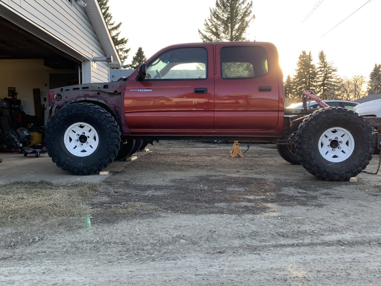

  2. Apr 29, 2020 at 7:35 AM
    cruiserguy
    cruiserguy Well-Known Member
    Jul 31, 2016
    #193416
    19,000
    Elijah
    SEKS
    2000 ext cab, 2.7L, auto, 4x4
    Well sunagun those wheels painted white look siiiiiiiiick:drool::cool:
    I mean like killer sick man. Those might be some of the best white wheels I've seen
    I would have never thought to try white on those but it friggin works. Love the look hombre

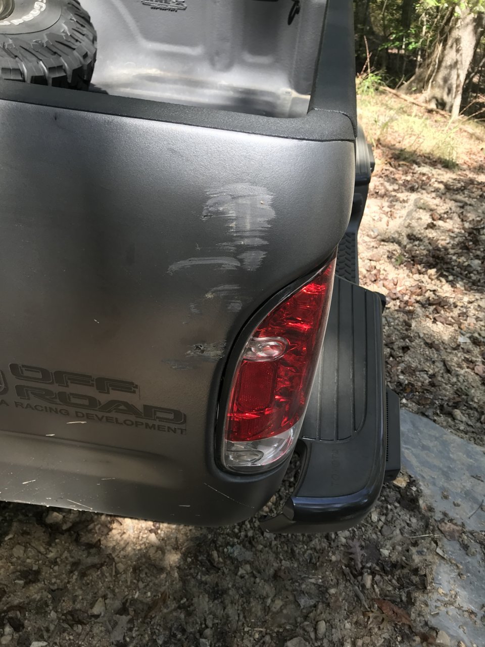

    @cynicalrider
    I actually smacked a tree coming up a trail and this is the only thing that happened. The bedside got dented, too, but very little of the dip tore at all, and it was easy enough to fix.

    Really? Wow I wouldn't have expected it to hold up well against brush and stuff. That's pretty awesome to hear. I get what you're saying, a hard branch or something that will actually pinstripe your real paint will also affect the plastidip. Very cool that it even held up over multiple years for ya. I think it looks super clean. Love that final color and tone

    I've done bronze on a couple different types of stock wheels, and I love the colour. But playing with these, and really getting sick of dark colours, I tried the white, and damn, do I love them. I need to get some classic blue and red pinstripes on them too.
