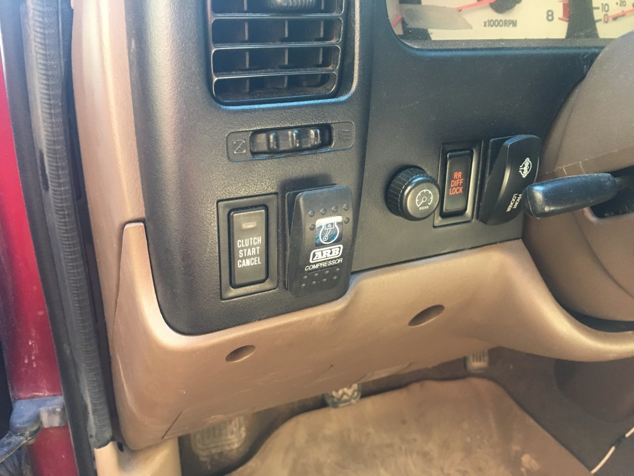

    It gets a little warm, but hasn’t shut off on me yet. I only have 33’s, so I’m not too worried about over heating it. I’ve got a buddy with 35’s on his, so I think I’ll go try to air up his tires on a hot day and see how it does since I plan to go to 35’s when these tires wear out. A lot of the 2nd gen guys put them in the cubby hole in the bed, and mine is starting at whatever temp is in the cubby hole and not the heat of under the hood, so...? I had a lot of nay sayers telling me that was an awful spot to put it because it would be too loud and it would overheat. My girlfriend fell asleep to the humming of the compressor when I was airing up this weekend though. I do need to run a stainless steal braided leader hose off of it though, because the hose gets hot! I blew the hose coming right out of the compressor off after filling up tire number four last weekend from 10 psi to 35 psi (That woke my girlfriend up from her nap!). I put a second hose clamp on it for the time being, but that hose was hot and very flimsy. I’ve got sound mat and a vinyl kit on order, so when that comes in, I’ll rip the interior out and clean up/finalize the install. If it gets to the point where it’s overheating, I’ll cut holes on both sides of the storage box and put a fan to circulate the air through the storage compartment. It is on a switch in the dash!00EA22B6-3227-49EA-9D88-A3B2D62B3B03.jpg
    I elected that spot, because I could turn the compressor on and off through the window without having to open the door. It’s been pretty nice so far!

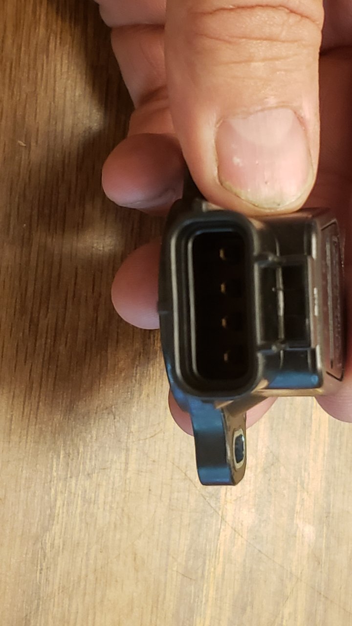

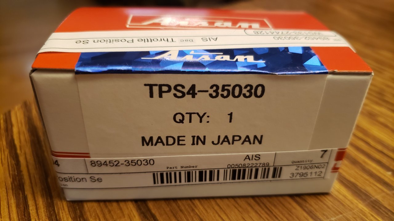

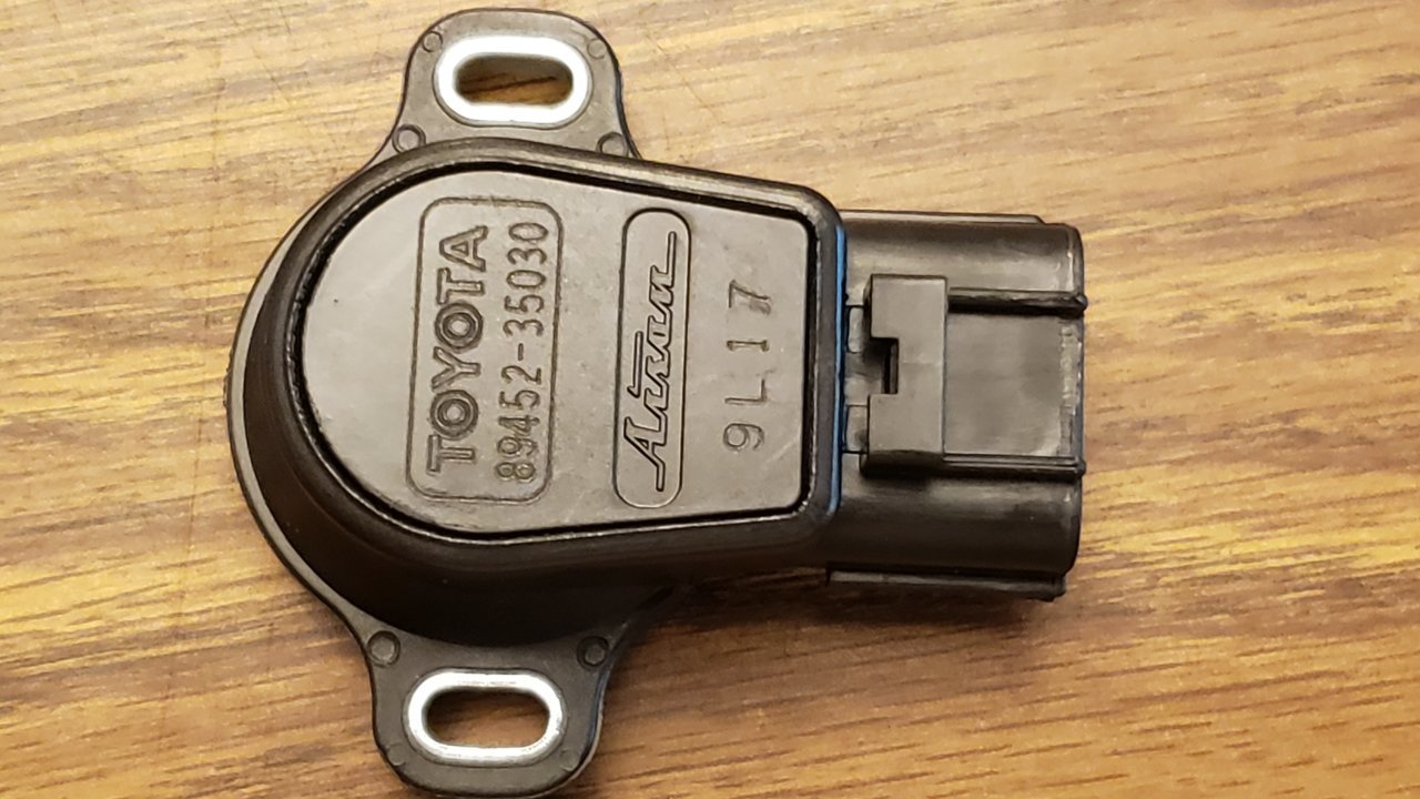

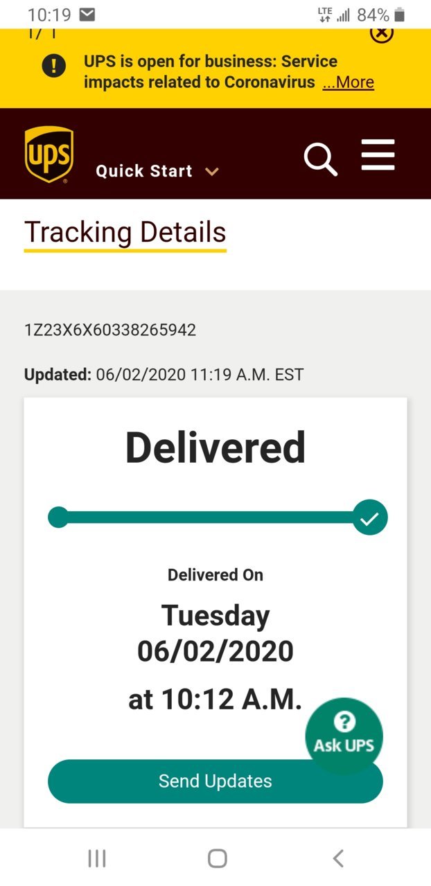

    Ordered the Throttle Position Sensor from PartsGeek.com got it next day and it is the 89452-35030 part # needed for the 2003, 2004 Tacoma. Installed it and it works great. So now there is a way to get the sensor without having to buy the entire throttle body.
    Parks Geek Part Number: W0133-2744128
    https://www.partsgeek.com/catalog/2003/toyota/tacoma/fuel_injection/throttle_position_sensor.html

    Keen, I think I will order one for the spares box :) thanks for letting people know
    Edit - Ordered. Says they only had 6 in stock btw. Like that they point out specifically it's not offered by the dealer separately. Good chit.

    It's also a bit weird that they say "will not work with your 2004 Tacoma" yet it does.
    Probably disclaimer, legal garbage.

    Lol just joking, I'm glad to find a replacement, it's crazy Toyota didn't ever offer one.

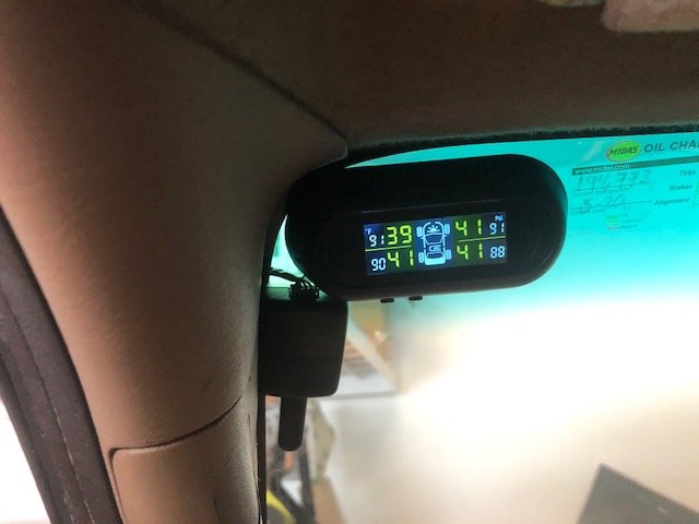

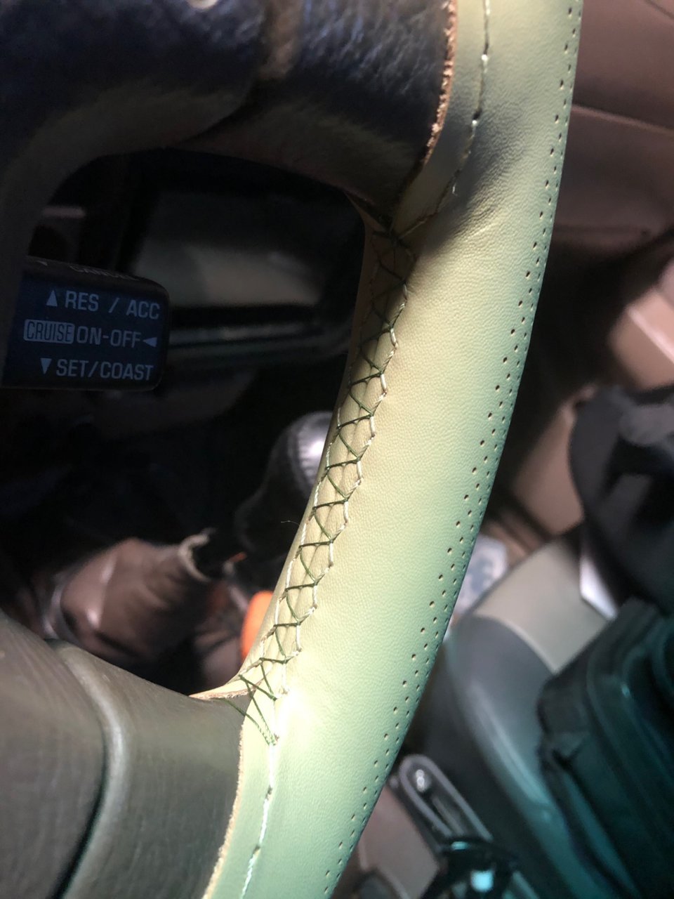

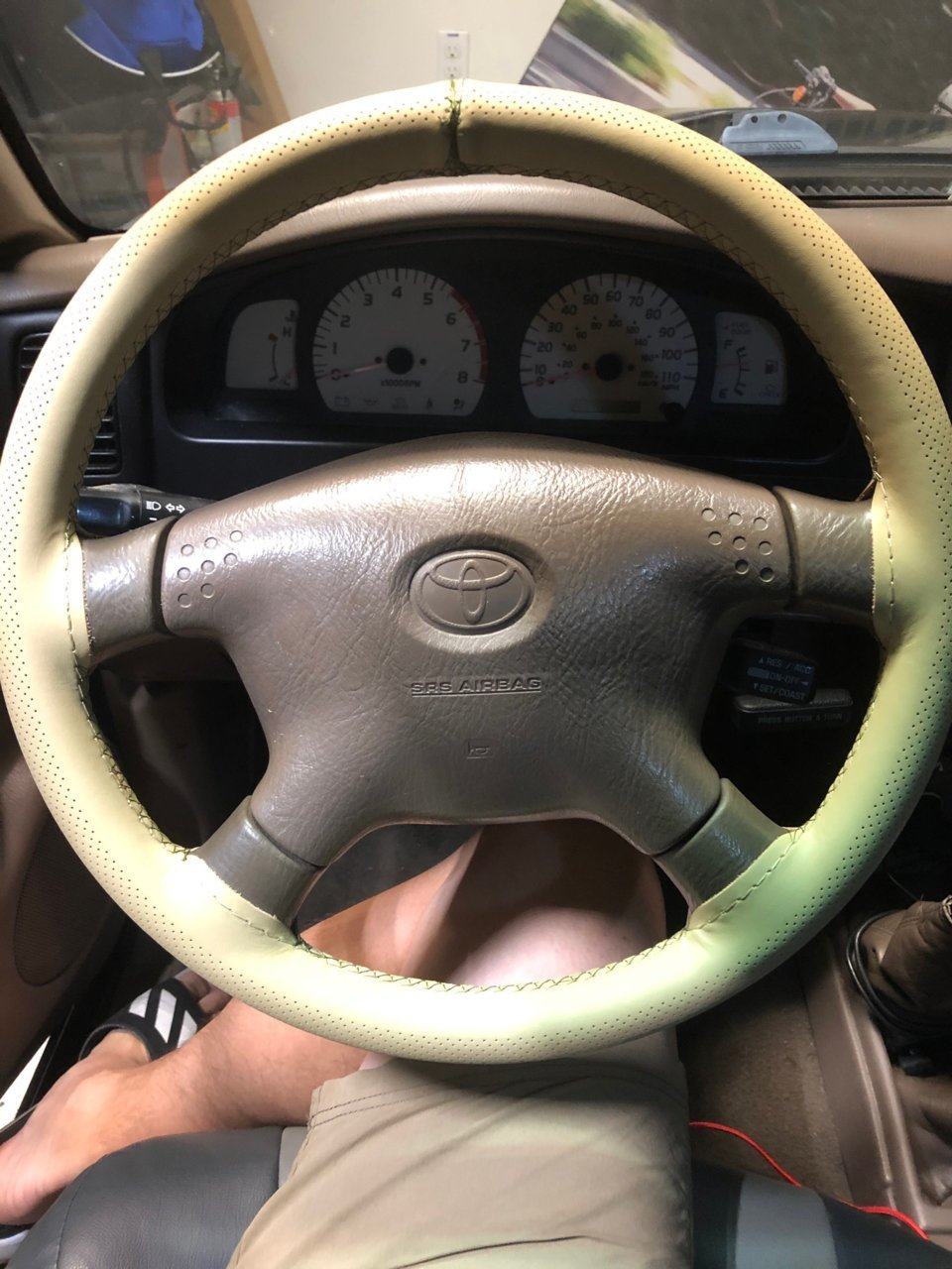

    Spent some time this weekend on the Taco:
    - Leather steering wheel wrap ($14)

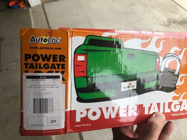

    - Electric door lock (pop n lock) ($70) I think it cost more now, but i found it on sale awhile ago

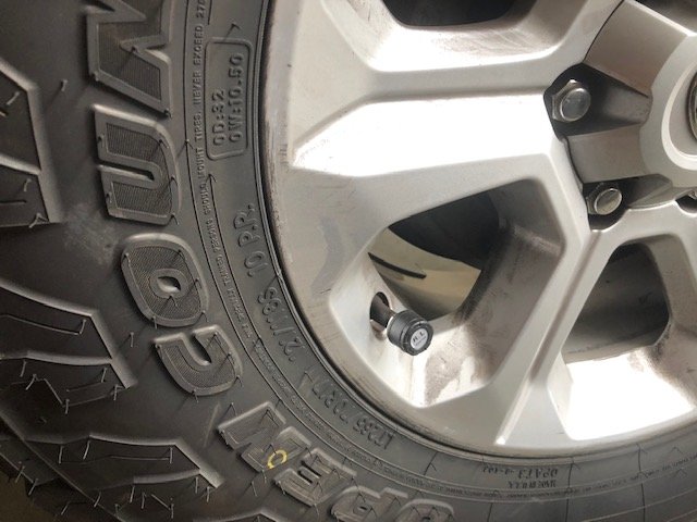

    - TPMS system ($40 on Amazon), not a bad system seems to work well however the sensors are a bit ugly, but to me worth it.
    On order AFE throttle body spacer, new shift lever/knob, and OVRLND camper (can't wait)

    Nice additions! Welcome to TW :)
