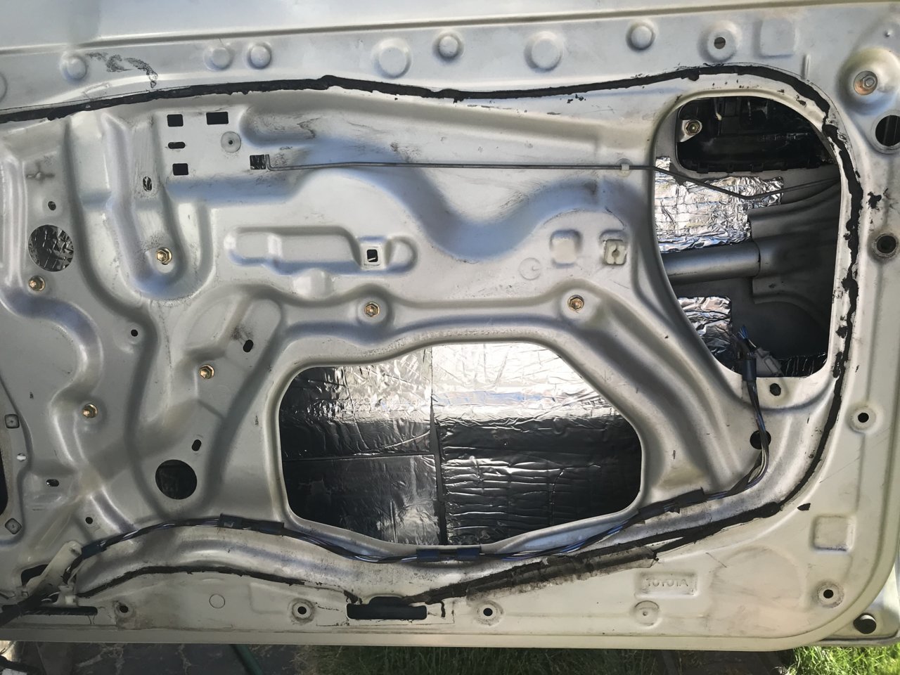

    I've spent the better part of three days getting my passenger side doors swapped out to the ones from the salvage vehicle in Florida. I first thought, heck, it's only four bolts and three electrical connections. That is until I realized that both of the new doors had issues with the latches and outside handles. My original ones were fine, so I stripped down all four doors, which takes you down to basically the shell of the door. While I was in there, I did add some of the Frost King to absorb some of the sound and take some of the tininess out of them when you close them. The frost king does a good job, and was still in perfect shape on the original doors, from about 3 years ago.

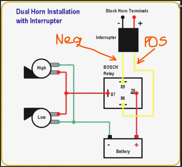

    Planning on changing the stock horns:
    There is only one connection to the stock horns, I am assuming that is the positive and its grounded to the core support - can anyone confirm this?
    The Hellas have two prongs - assuming positive and negative and comes with a relay.
    Going this route:

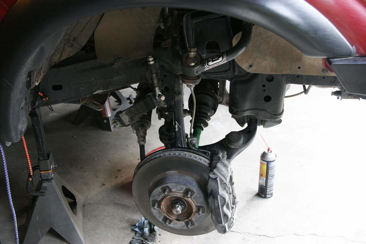

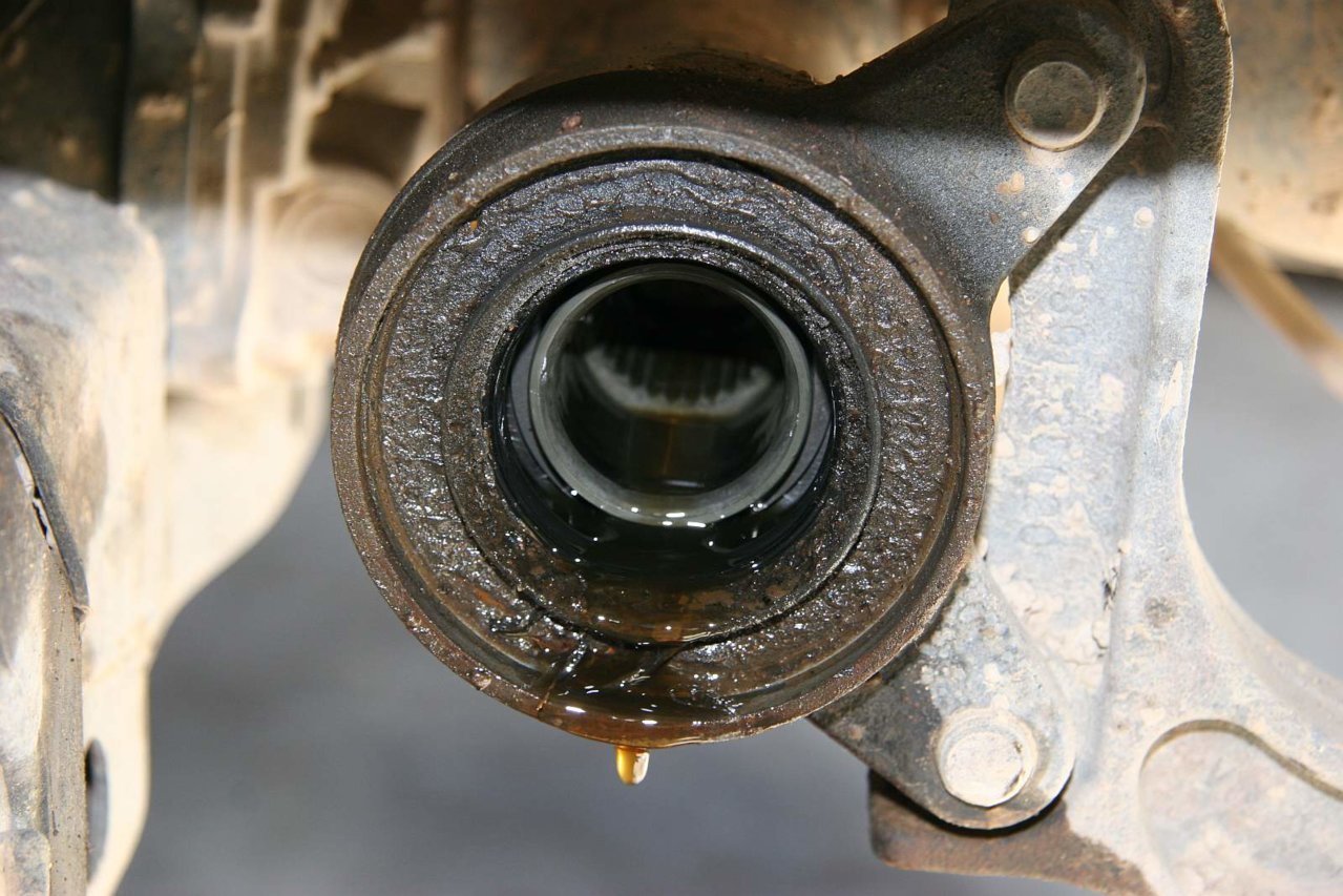

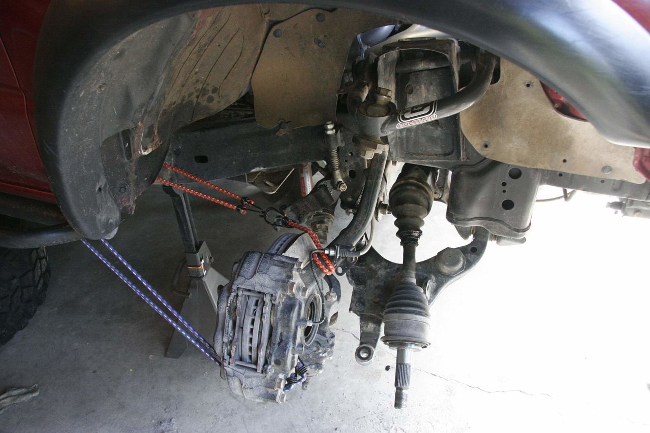

    Replaced the passenger side CV axle with one I had recently rebooted. The inner boot on the old one was making a mess. Plus, the axle seal on that side had started to seep oil after the last adventure.
    There was a lot of debris around the seal. I've seen this movie before. splashing thru muddy puddles can cause this. I cleaned up the seal, got rid of all the grit and mud.
    The seal itself seemed to still be in good condition after cleaning so I slapped in the replacement axle. Time will tell whether that was the right decision.

    Glad you chose that CV as the one to use. Looking good there. :thumbsup:
