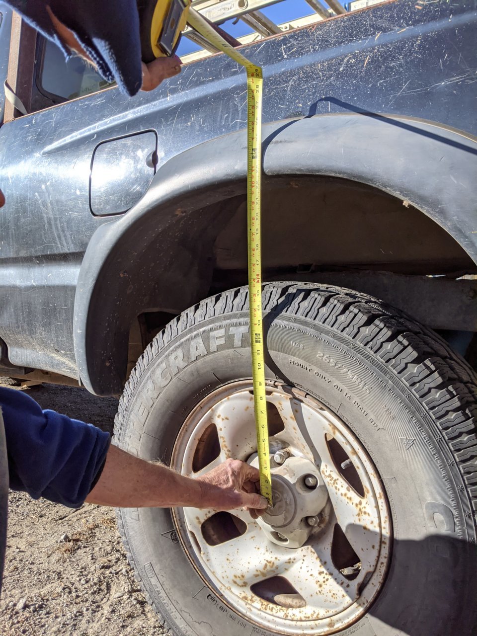

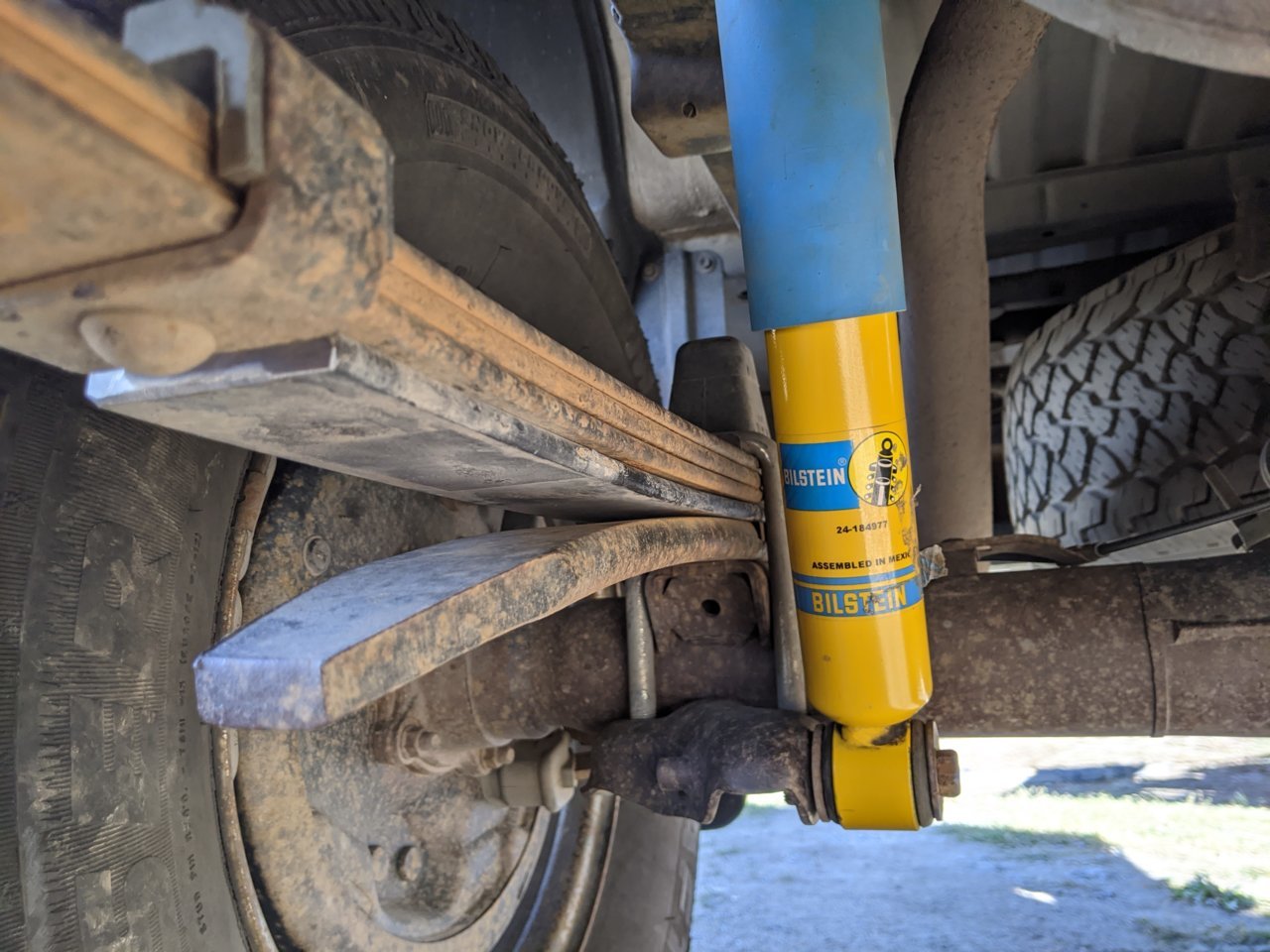

    stock 2003 and stock SR 2020
    not a single mod
    I made my own add a leaf out of a 2020 leaf pack.
    Added it to my sagging 2003 rear.
    Installed along with some lightly used 4600s.
    Brought up the rear about 2" I think..

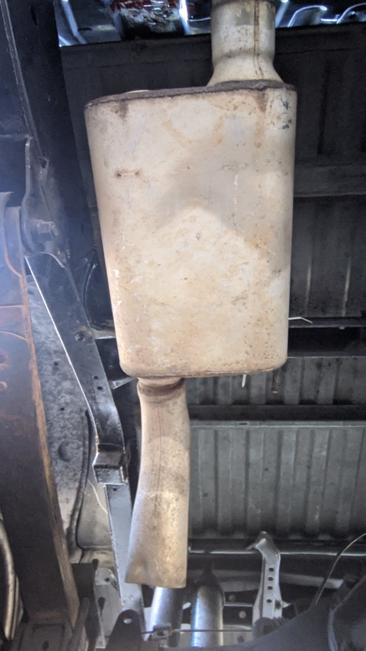

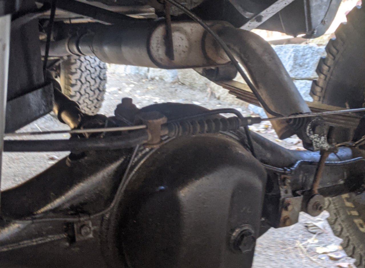

    Found a flowmaster with down pipe in my parts pile so decided to us it so the exhaust is not blowing on the rear shocks. May do some moving and adjustments in the future. Was surprised how much I like the sound.

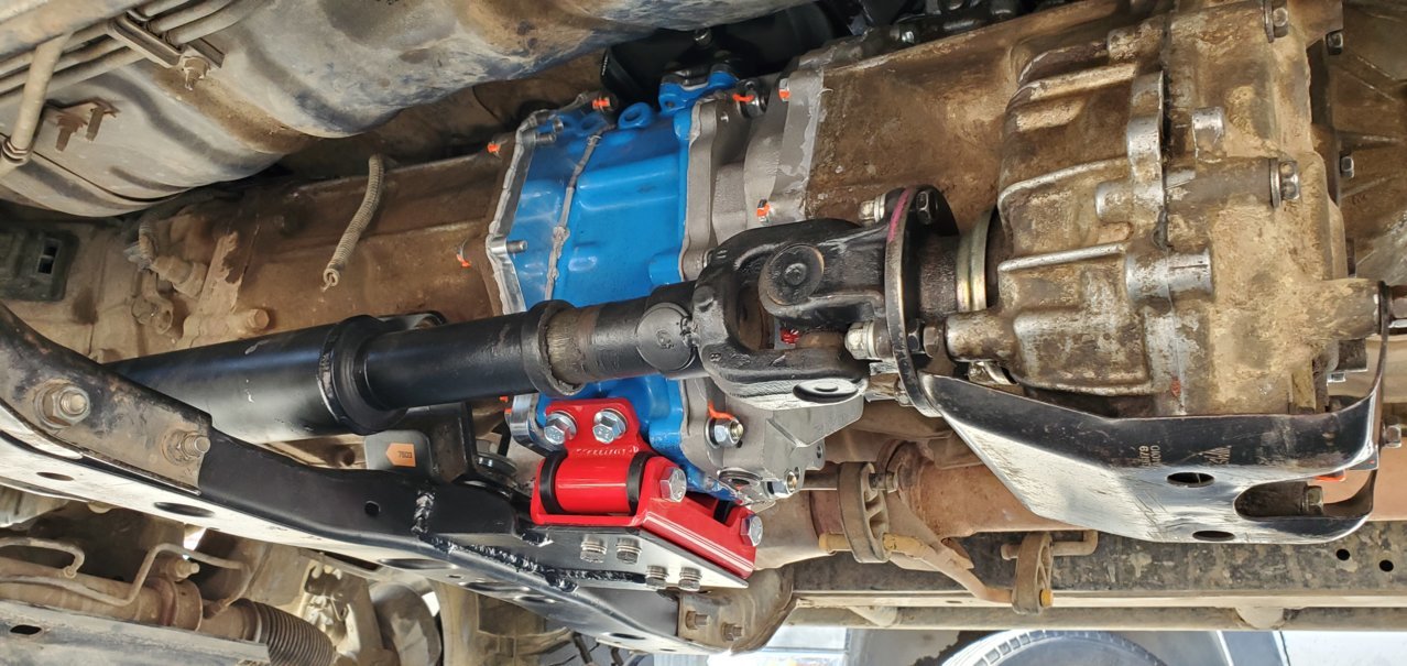

    I plan on doing this. Need details. 2.28 box? What did it cost you? Weird things you ran into ?

    Happy to answer any questions you have about it. Was a fun project.
    Bought a housing off another member here. Marlin 4.7 gears with Trail gear adapters. Bunch of other misc internal components that I was missing from Yotamasters. Built it up myself.
    Ran into some fitment issues with the transmission to crawlbox coupler. More details in my build thread.
    Shoot me a PM if you have more questions.
    Also lots of great info in the crawlbox BS thread: https://www.tacomaworld.com/threads/official-crawlbox-bs-thread.422186/
    Go 2.28 if you're an auto, 4.7 if you're a manual.

    flowmaster 40 series? 2.7L?

    Not sure if it's a 40 or a 50 series. Came off a 4 cylinder subaru

    I have a similar muffler on my 2.7L but magnaflow. I like the sound of it too.
    I also have a mangaflow bolt-on catalytic converter replacement that I would recommend if you ever need to replace yours (assuming you're 4cyl as well)

    I was surprised I thought it may sound like a rice rocket but it's fairly deep for a 4 cylinder

    Yea exactly my thoughts too. I was pleasantly surprised at the sound.
    I believe a lot of that is due to the fact that it's a relatively large displacement 4 cylinder engine.
    Had a buddy with a twin turbo Audi v6 that was 2.7L. Same displacement

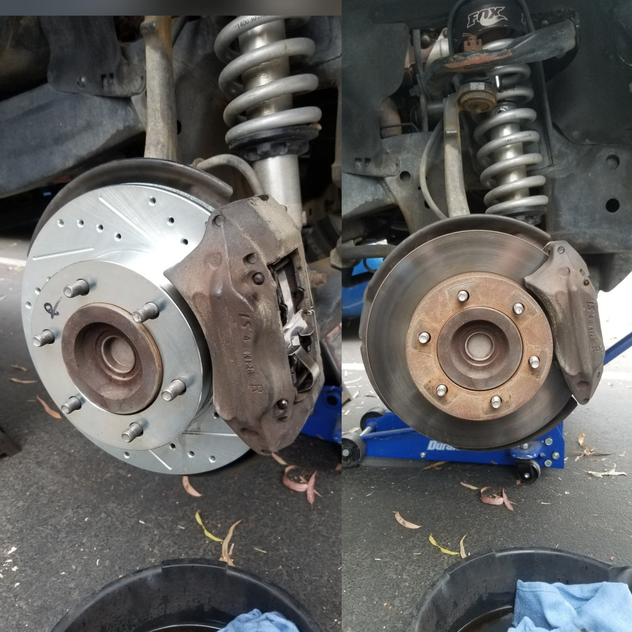

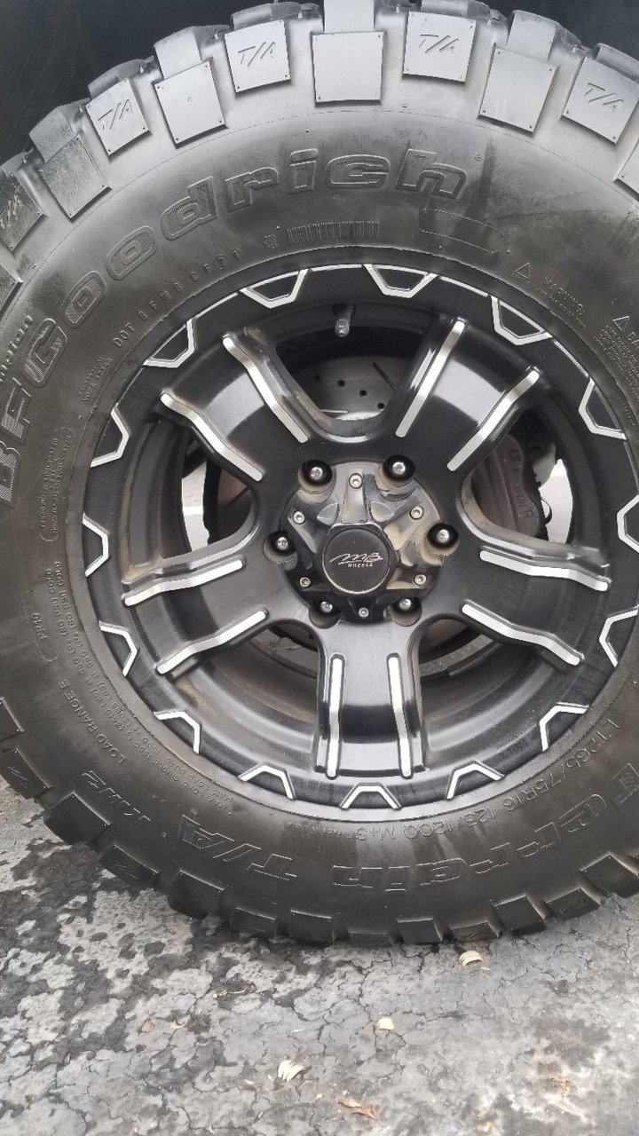

    Front - Fox 2.0 coil overs Rear - RC N3 shocks Tires - 265 75 16 BFG KM2
    DS rotors w fresh pads
