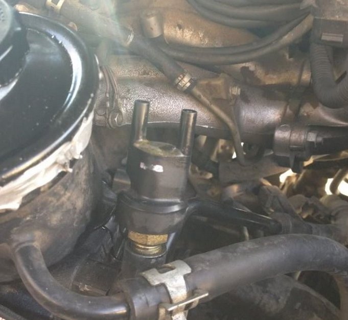

    That’s where it looks like it’s leaking from, but when I refilled the reservoir it and ran my truck it didn’t leak

    Also check the power steering air control valve. That top palstic part blew off of mine one time and would spray fluid everywhere whenever you put the steering under any kind of load.

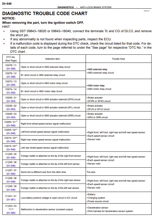

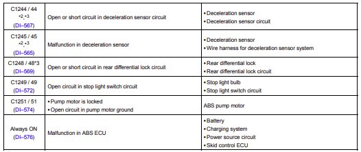

    As someone also with a 2002 and a very frustrating ABS issue in the past, try using a paperclip to jump OBD ports 4 and 14, then turn ignition to on position. Count the times the ABS light blinks to determine the code. Lets hope you don't have a code 51 like I did...

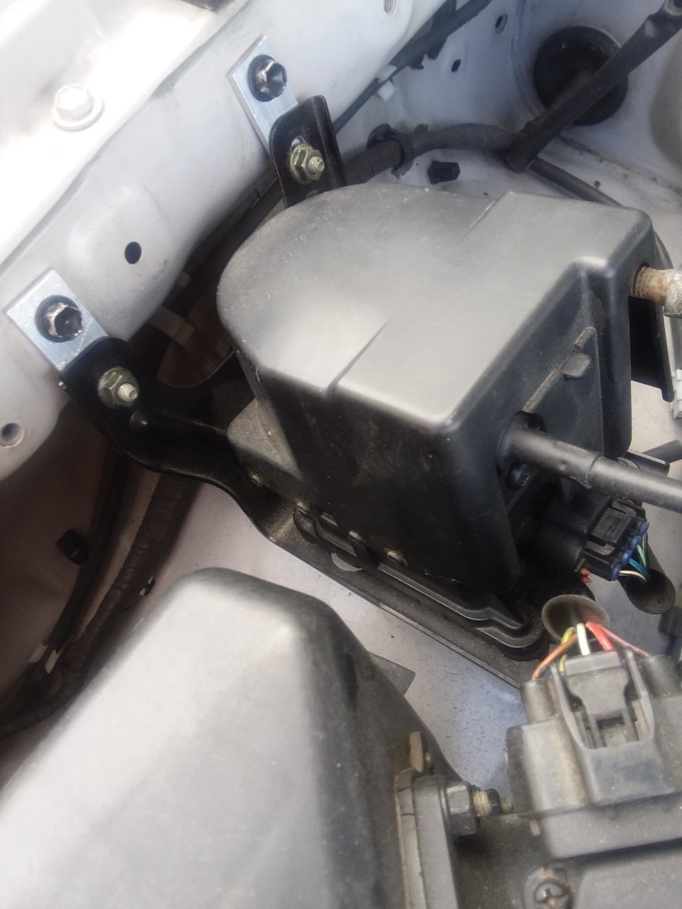

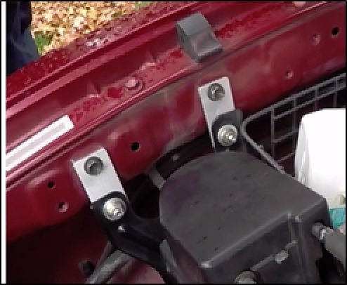

    It does not need to to be much lower, but it does contact the plastic cover on the cruise box. 95 v6

    I got the code a few years ago and it was indeed 51. I haven’t checked since then and today was the first time the light wasn’t on and ABS actually functioned. I’ve played with the ground but that didn’t help. I’m not super worried about it at this point but it’d be nice to have the light off if I go to sell it...

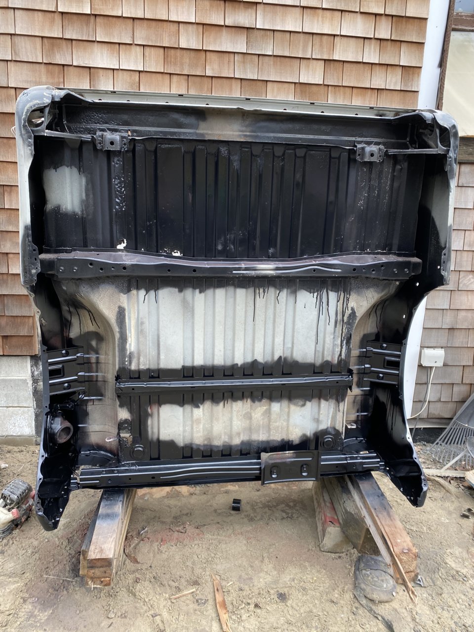

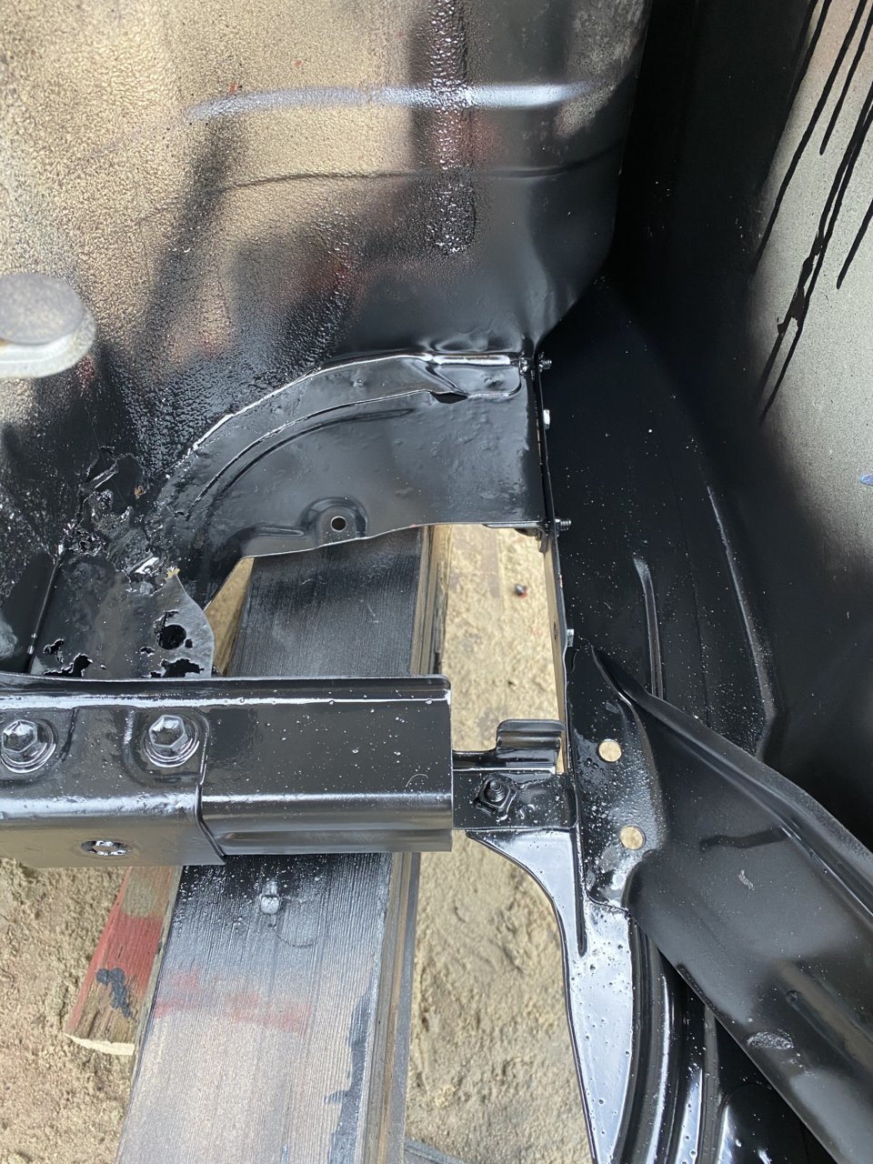

    Sandblasted and painted the rust under the bed. Not an amazing job but it works
