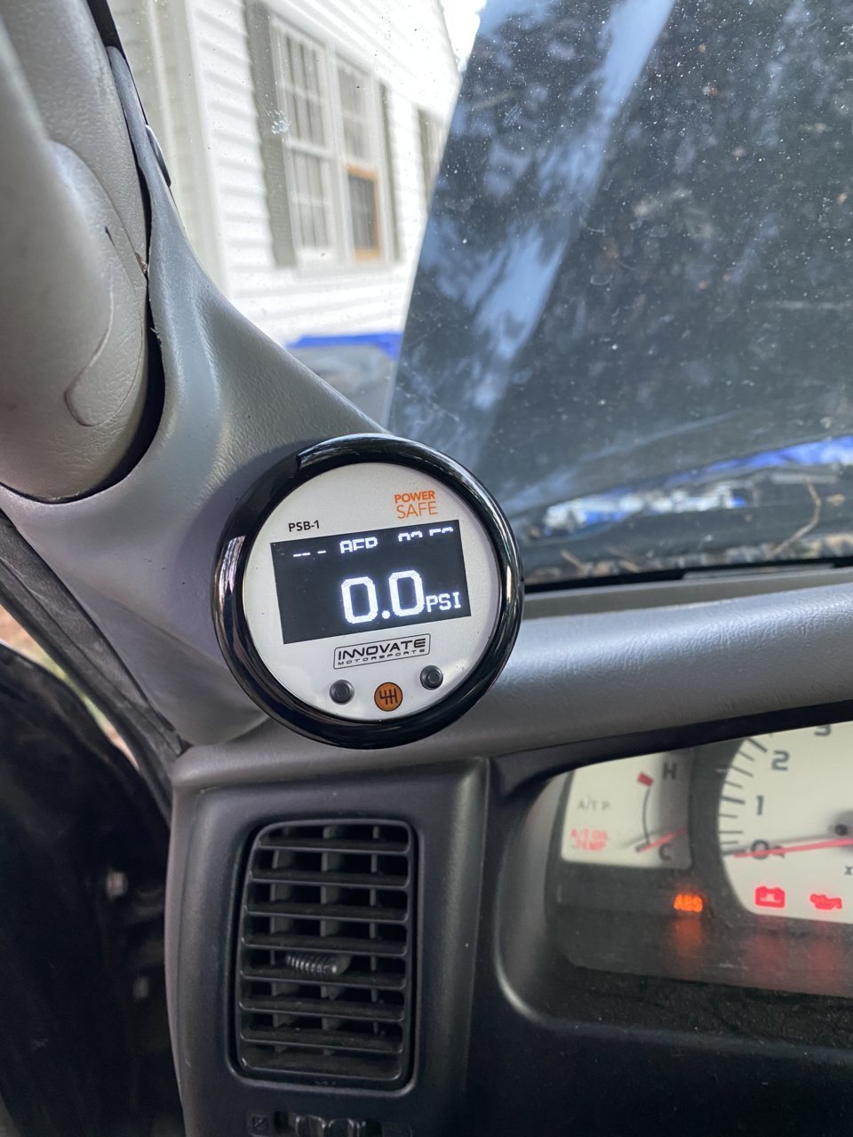

    No, it’s had a supercharger since it was new. Dealer install for the first owner, so it’s been roughly 265k miles. I’m finally taking the time to really rebuild it along with adding the needed mods for the fueling.
    This innovative psb-1 gauge has a powersafe feature where it’ll cut boost if the engine leans out. It hooks into an electronic solenoid but I believe our superchargers are all mechanical/vacuum, correct?
    Honestly, it’s not a feature I’m too worried about. Less wiring I have to run, just something I was interested in knows my for knowing sake.

    Correct, unless you do some mods to give it a feature like this:
    https://www.tacomaworld.com/threads/sc-bypass-switch.582614/
    If running WOT and high RPM, it won't totally kill boost, but lower it substantially. Or something more dramatic like cutting the ignition out like the other reply.
    Simplest thing is to just wire it to a dummy light/LED to let you know to get off of it.

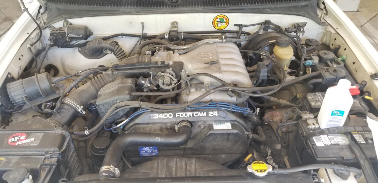

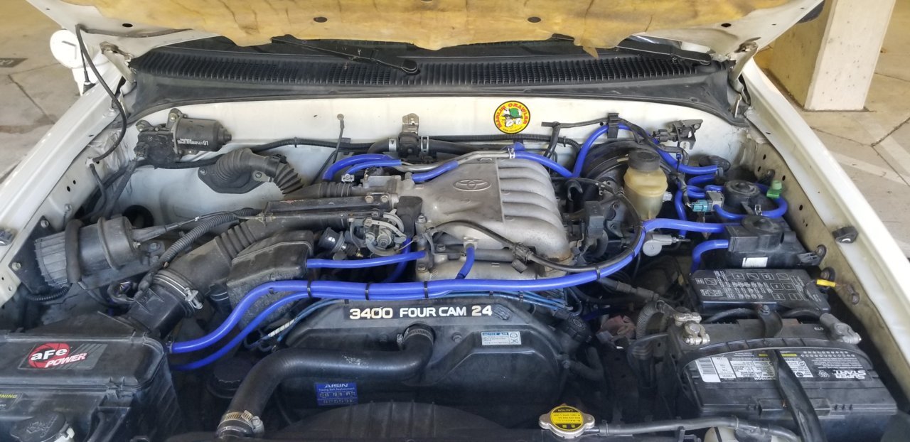

    Finally got the silicone vacuum hoses on. I need to spend more time with the 1st gen (aka install the rest of the parts I've been holding off) as My recent 2nd gen Tunda has taken some of my attention away, but
    I'm really digging the blue.

    Looks good, where’d you get them?

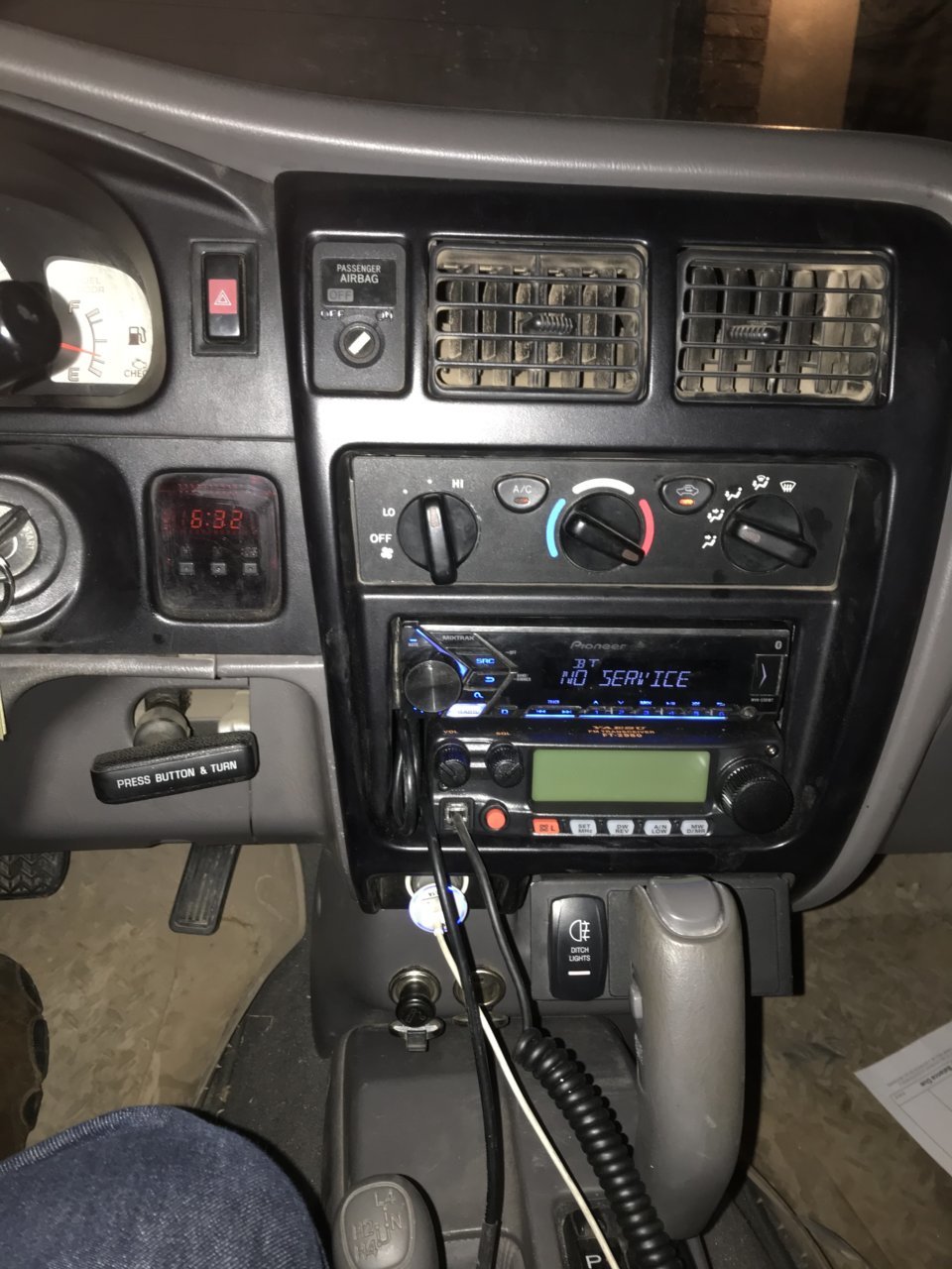

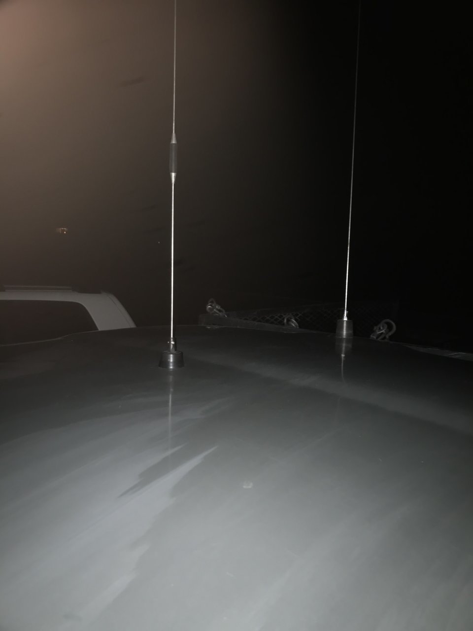

    Permanently mounted the antennas (drilled holes), installed a new radio and headlight bulbs, ran the gps cable
    any ideas on where to mount the mic holder thing

    If you're like most people, that passenger airbag C/O switch never gets used. You could mount over it. Leave it in place but just cover it up.

    Is there a blank for that?
