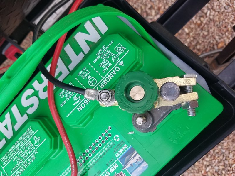

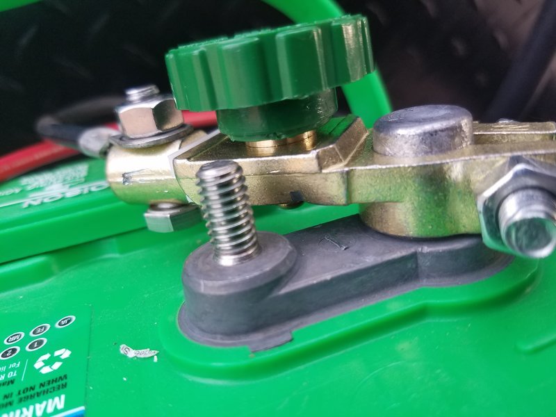

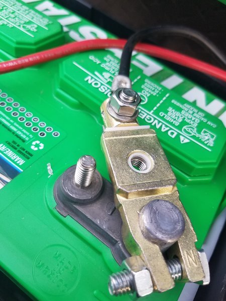

    Added a battery quick disconnect to the travel trailer. Cheap part and very simple install. You can see it has 2 pieces of metal isolated by a piece of plastic. When the knob is screwed in itmakes contact between the two pieces.

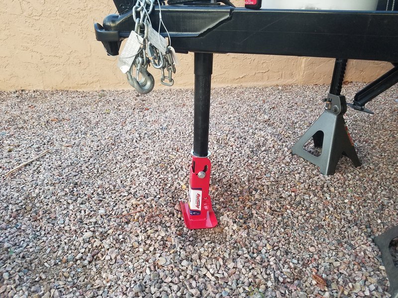

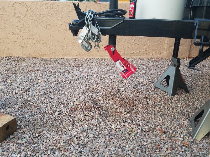

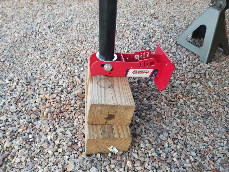

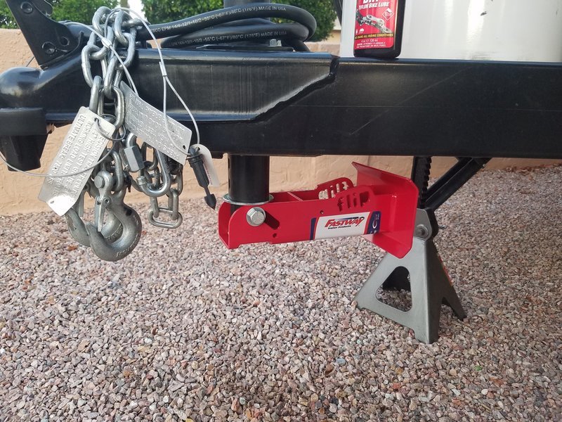

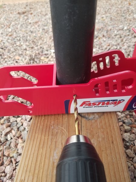

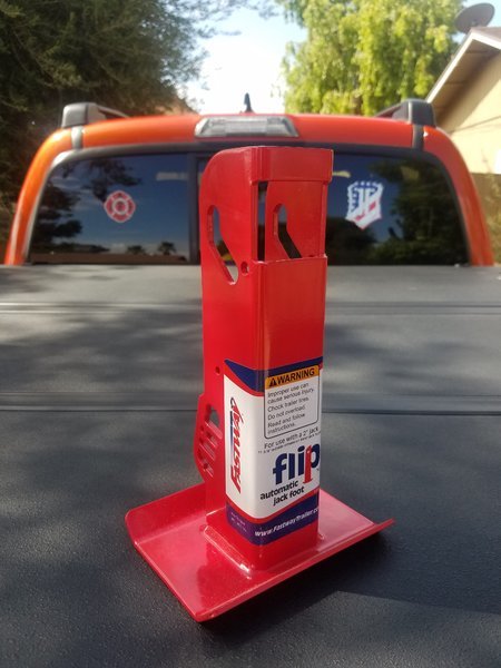

    So apparently the fastway flipjack did get delivered, the UPS guy just apparently thought he was hiding an Easter egg and didn't ring the door bell lol.
    So anyways I threw it on real quick and took a few pics. It was a very quick and easy install.

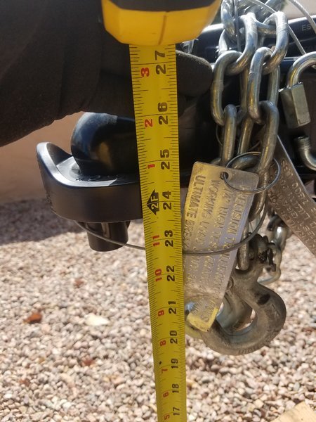

    So you can see fron the pics the tounge height when level is about 24 inches on the baja edition. That equates to a whole lot of cranking and necessitates some kind of stand or wood blocks to even get it hitched to my truck which is lifted about 2.75 inches and on stock tires.

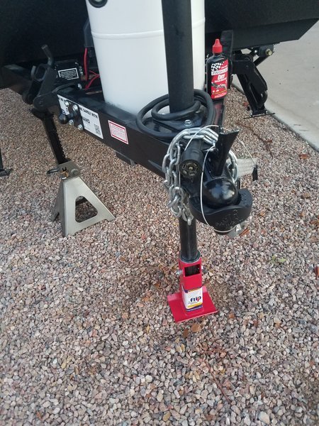

    The Fastway flip-jack adds six inches to the jack (wich means I no longer need to bring blocks of wood) and has an ingenious design that folds itself up mechanically which alleviates about 6 inches of jacking. As the flip-jack is brought up the rounded top of the flip-jack glides against a circular spacer and allows it to rotate upwards due to the slotted design in the flip-jack. I've added a couple pics of it stowed and rotating.
    The flip-jack even has a built in template for drilling pilot holes in your jack. This can be seen in the second pic.
    The second to last pic shows an approved method for short jacking if you are parked on uneven terrain (this does require a wood block).
    I'll have to take a couple trips before I can review it but I'm pleased so far:cheers:
