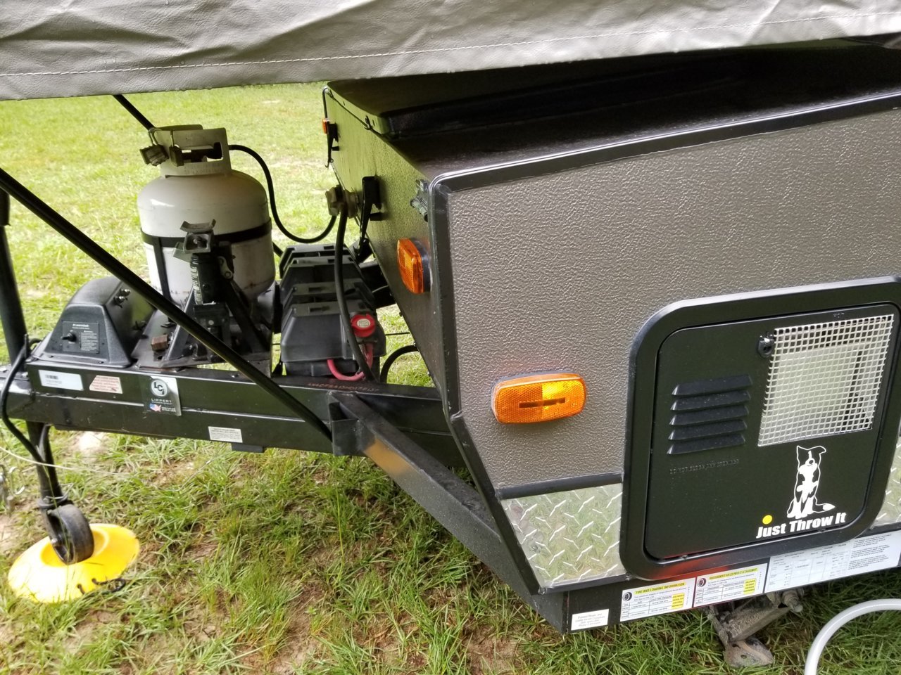

    • Dual battery conversion - 2 deka 12v giving me 130-ish amp hours. Will probably upgrade again to a pair of 6V batteries wired in serial.
    • Interior battery monitor system - cheap mictuning junk, but since it monitors draw directly from the battery, it's pretty accurate.
    • Hinges on seats - my camper came with loose lids on the bench storage, which went everywhere during transport. I put piano hinges on those and trunk lid stays so they can be propped open when accessing.
    • Painted the interior - wood grain is boring as fuck
    • Plastidipped the wheels because why not.
    • Painted the fridge with chalkboard paint- for funsies
    • Mattress - tossed the flimsy factory 4 inch mattress. Lined the mattress tray with half-inch workout foam tile. Put a lucid 5 inch mattress on top of that. And because I'm a fucking princess, I bought a queen size 4 inch folding mattress to put on top of that. The folding mattress goes on the floor in travel mode, the 5 inch lucid and tile will barely clear when the lid is closed. 9.5 inches of mattress feels like a real bed.
    • Bumper mounted rear view camera with 5 inch dashboard monitor - helps me see who's on my 6 when towing. One of my favorite mods.
    • Mounted a 3 ton unijack to the tongue- needed a jack that can safely change a trailer tire.
    • Bal lock bar stabilizers - two bars on the rear left stab, two more on the front right. My other favorite mod. Completely eliminated the shaky trailer issue.

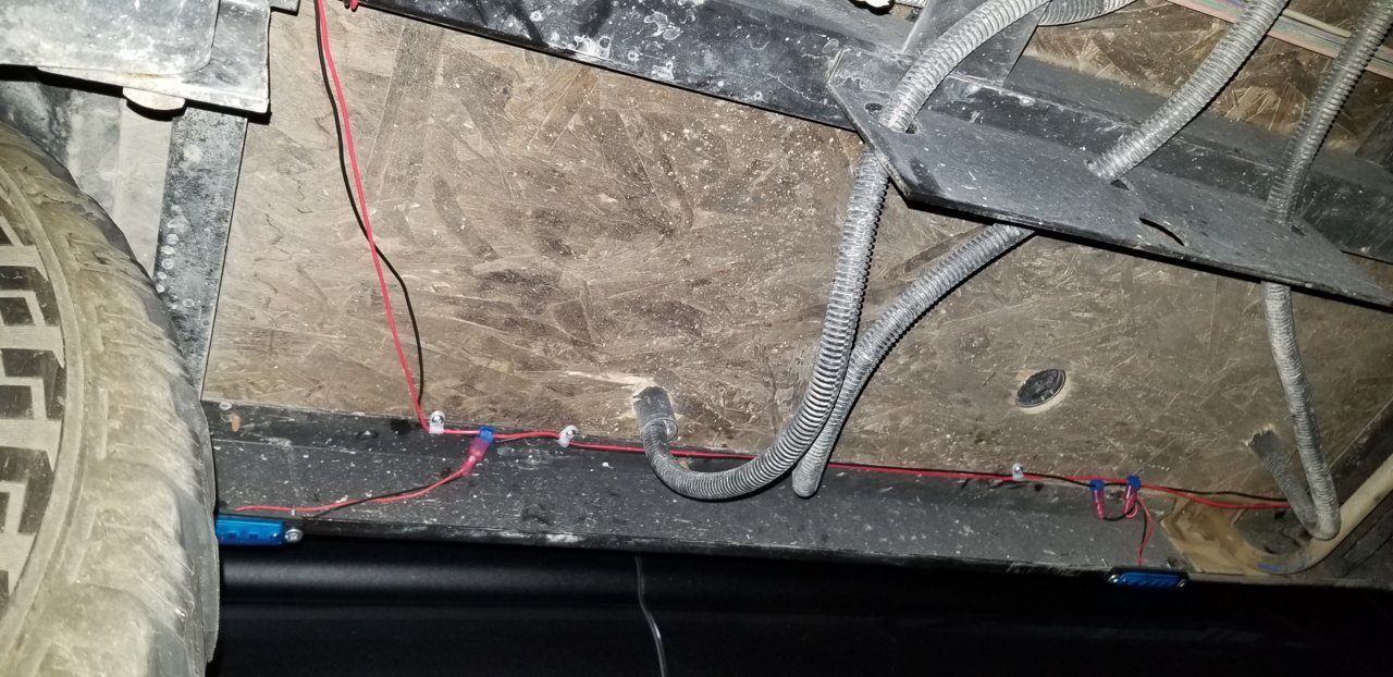

    And this weekend, thanks to a conversation with @oostroma, I installed blue foot lights on the bottom of the frame. I was really struggling trying to find the right rocker switch for it though. I went with "rock lights," but that doesn't feel quite right. Might change that to "ufo lights" soon. Can't wait to see this in action for the first time next weekend.

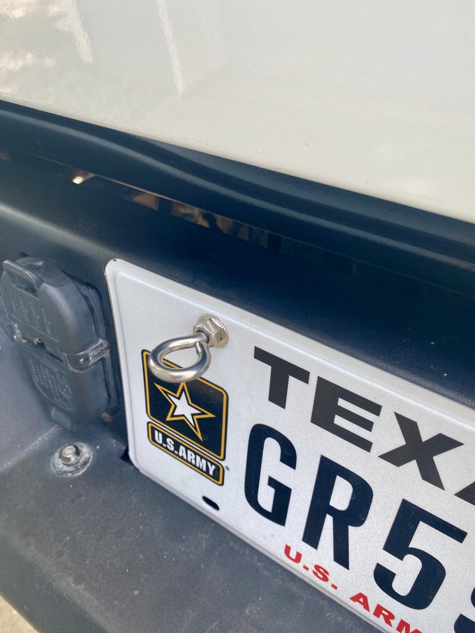

    Not a trailer mod, but a truck mod for the trailer that I saw this somewhere on the inter-tubes. Replaced my plate bolts with 1/4 stainless steel hardware; bolt on the right, eyelet on the left. They eyelet provides a spot to connect the breakaway cable that is NOT on the chain, hitch, or receiver and it's a very accessible yet out of the way spot.

    Thats a darn good idea. I never did like clipping mine to the receiver, but really haven't given it enough thought to find an alternative.

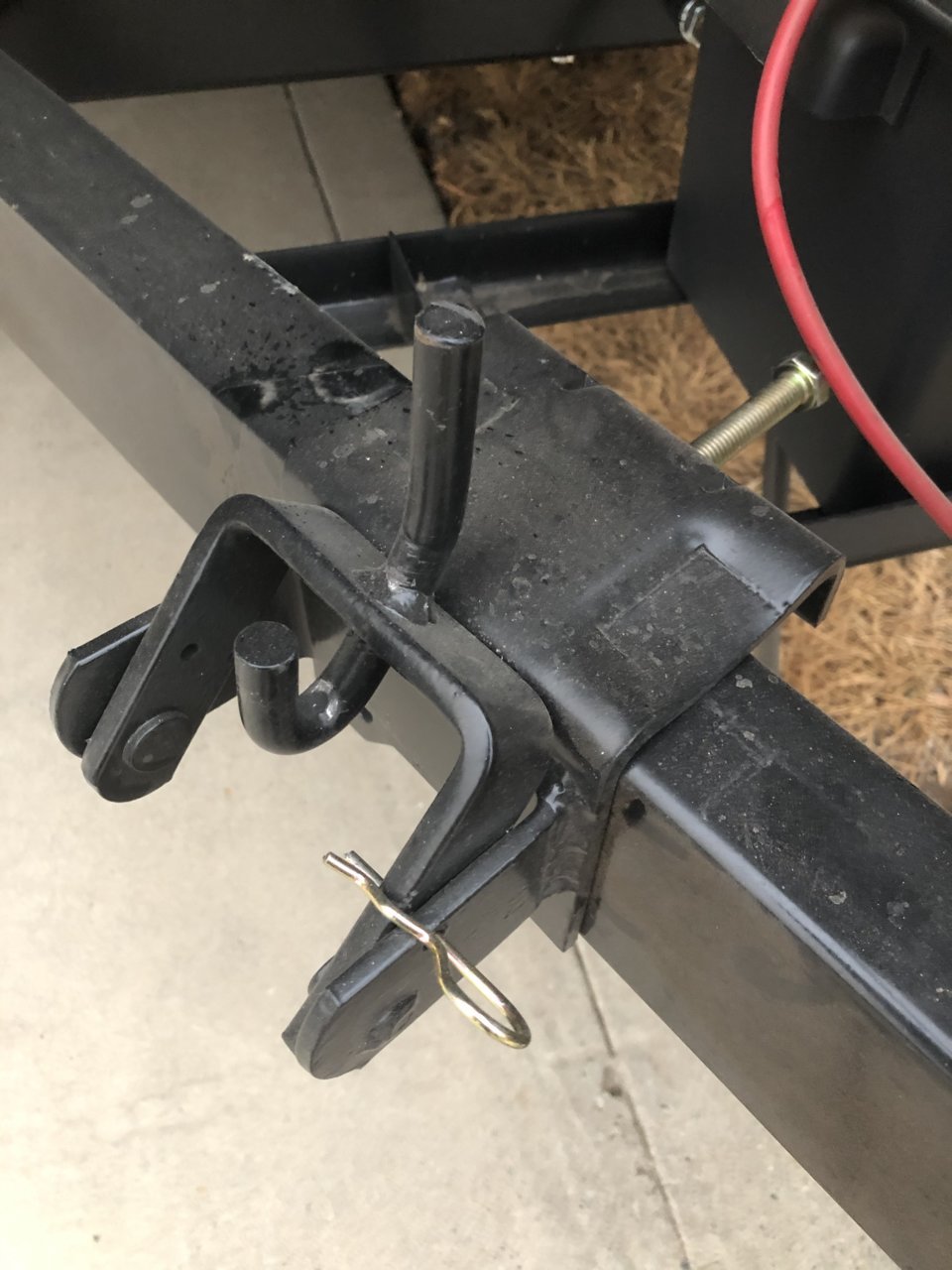

    Question: What's your guys' opinion on tac welding these weight distribution hookup brackets? I'm always finding them loose. I have a welder, I figure a few tacs wouldn't hurt. What do you think?
  16. Sep 13, 2020 at 7:08 AM
    #196
    JEEPNIK
    JEEPNIK Well-Known Member
    May 5, 2020
    #326895
    1,716
    2020 Voodoo Blue TRD Sport
    I’d try locktite first.

    I'm really happy with the ground lights. They were perfect for futzing around camp without ruining the view of the night sky. I'll have to be diligent since they are in the direct line of fire of the tires so they'll need cleaning after every dirt road, but it's worth it.
    Next step: finding a switch that's more appropriate than "rock lights." On order is "ufo lights." Would like something even better than that though.

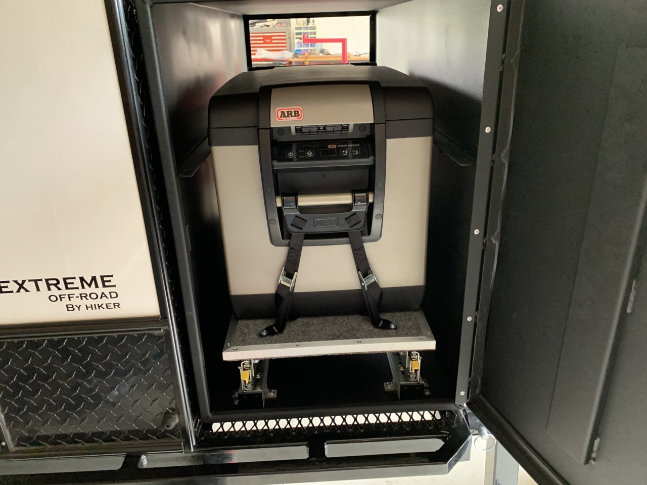

    Finished building my refrigerator slide and got the refrigerator and solar installed, minus the wiring. It's going to be great not having to deal with ice anymore.
