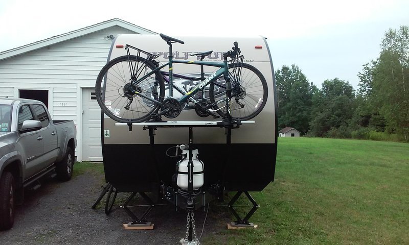

    I saw the Carlson tray on Amazon. Figured I'd make some modifications and try mounting my Inno racks to it. Works great and frees up space in the truck bed.

    I would recommend getting a long weight distribution shank. Extending the tray for the front bike rack lessens turn clearance. If you had to cut a corner sharp and the ground was uneven it's possible the rack could hit the truck above the taillights. I think I have an 18" and it's sometimes close.

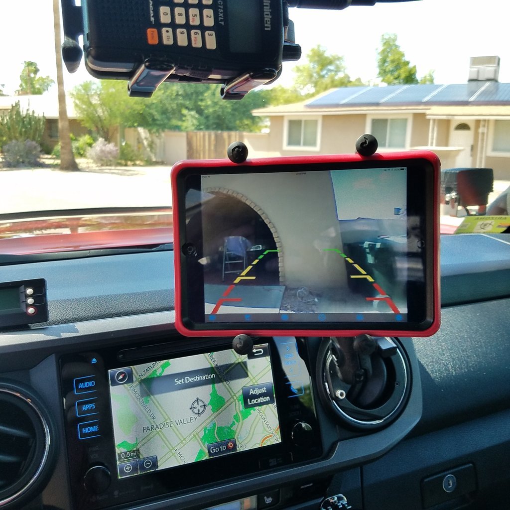

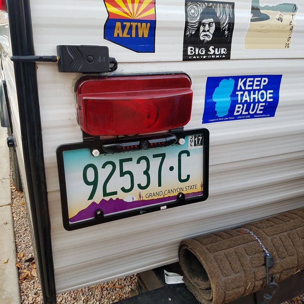

    Added a back-up camera to the camper today. Actually it's intended to be more off a towing rear view mirror setup. For ease of use and simple install I used a license plate frame backup camera and a WIFI video tranmistter. The transmitter is rain proof and transmits 100 meters. I will say that even though I did get the transmitter working with My IPad the app does NOT support Android nougat as of right now. This was NOT made known when I bought it....

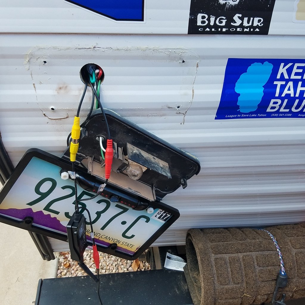

    The camera and transmitter together only require about .5 mA so I just taped them into a rear tailight wiring. The taillight also holds the license plate mount so it worked out well.
    The camera gets power from from the transmitter so just needed to splice and solder the transmitter wires into the taillight. I needed to use the voltmeter to figure this out. White = ground, black = running light, green = brake light.
    Stuff all the wiring into the hole and mount the tail light assembly / license plate frame. Ya need butyl tape and rtv silicone on all 4 sides of the light housing to seal it up from moisture. I also had dremmel the top of the housing to make room for the transmitter wires. The transmitter is affixed with 3m outdoor double sided tape.

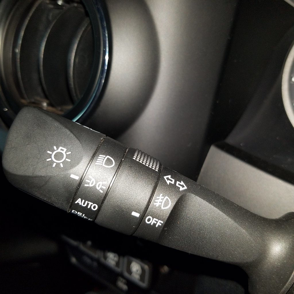

    The Camera/Transmitter are turned here when either the marker lights or headlights are turned on. Trailer must be plugged in to the truck of course.
    Voila it's working :proposetoast:. The iPad is held with the Hondo mount and and a RAM X-grip. Its kind of a cool system since anybody or any truck towing the trailer can just download the app and use the camera.

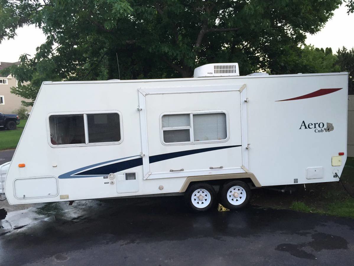

    I just upgraded from a popup camper to a 23' travel trailer (used). Over the past week, I've replaced the wheel bearings and tires. I also installed a brake controller (Tekonsha Primus IQ) and a weight distribution hitch with sway control (Eaz-lift 48058). Getting the WDH setup correctly has been a real pain. Even with the 5" drop, my Tacoma (no lift) sits a bit too high. So I wasn't able to get the camper level. My main concern though was getting some weight to the front. When I brought the camper home with no WDH, the front felt really light. I'm hoping when I add full propane tanks and have the camper fully loaded, it might drop the hitch another inch to get it level. It's maiden voyage will be the weekend of August 11th.

    Weighs in at 3,320 lbs dry, GVWR 4,720 and a dry hitch weight of 320.
    It's a 2002, so it's 15 years old. You'd never know it though, it's been well taken care of and stored winters. Best part is, it only cost me $1,500 more than I sold my popup for!
