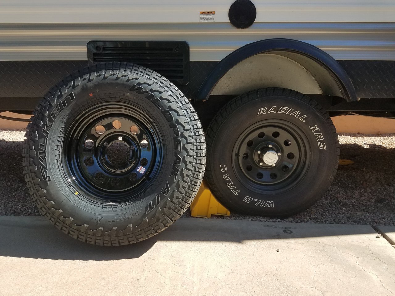

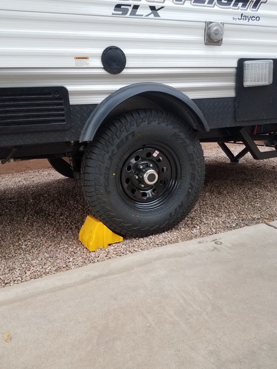

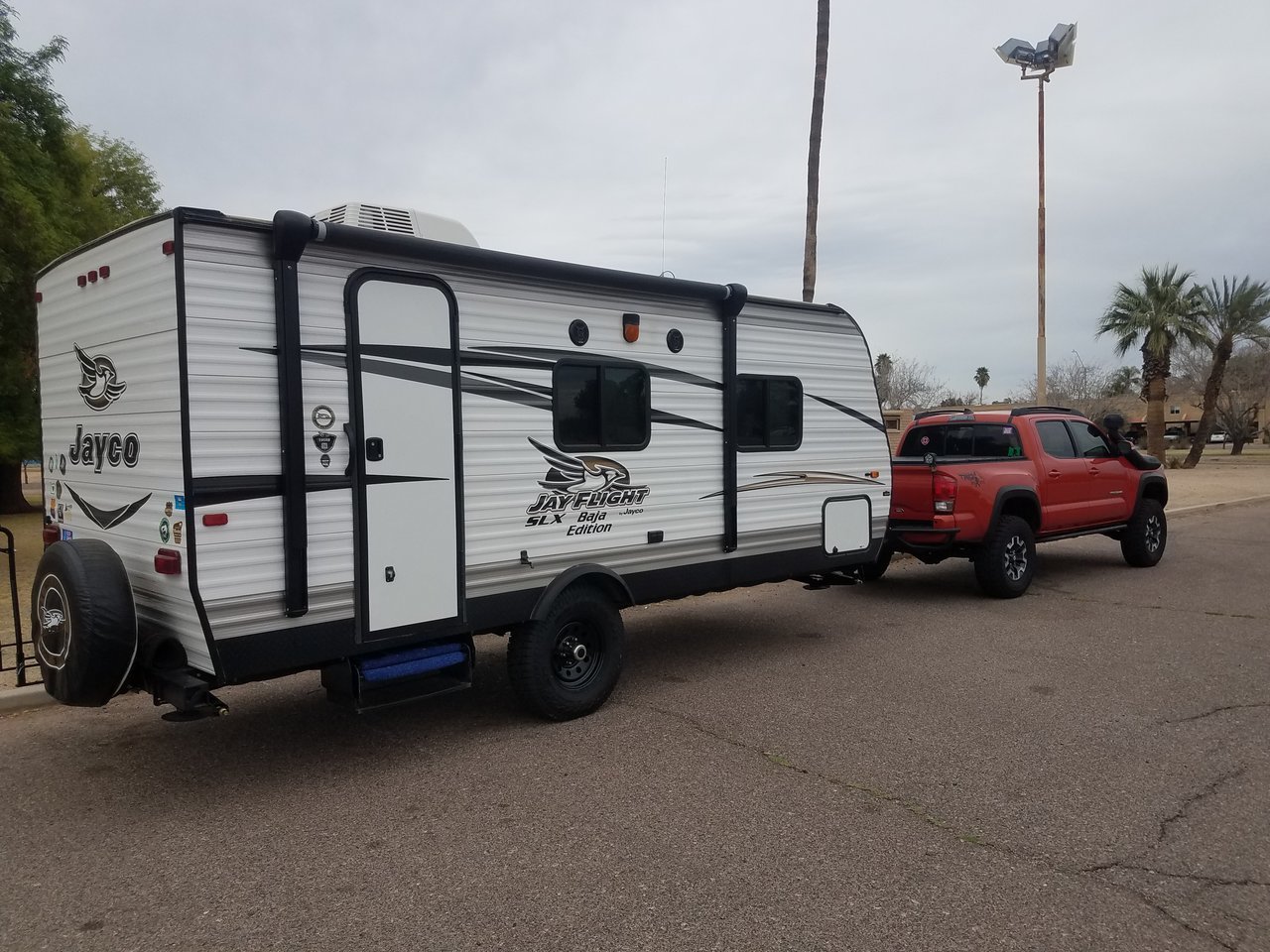

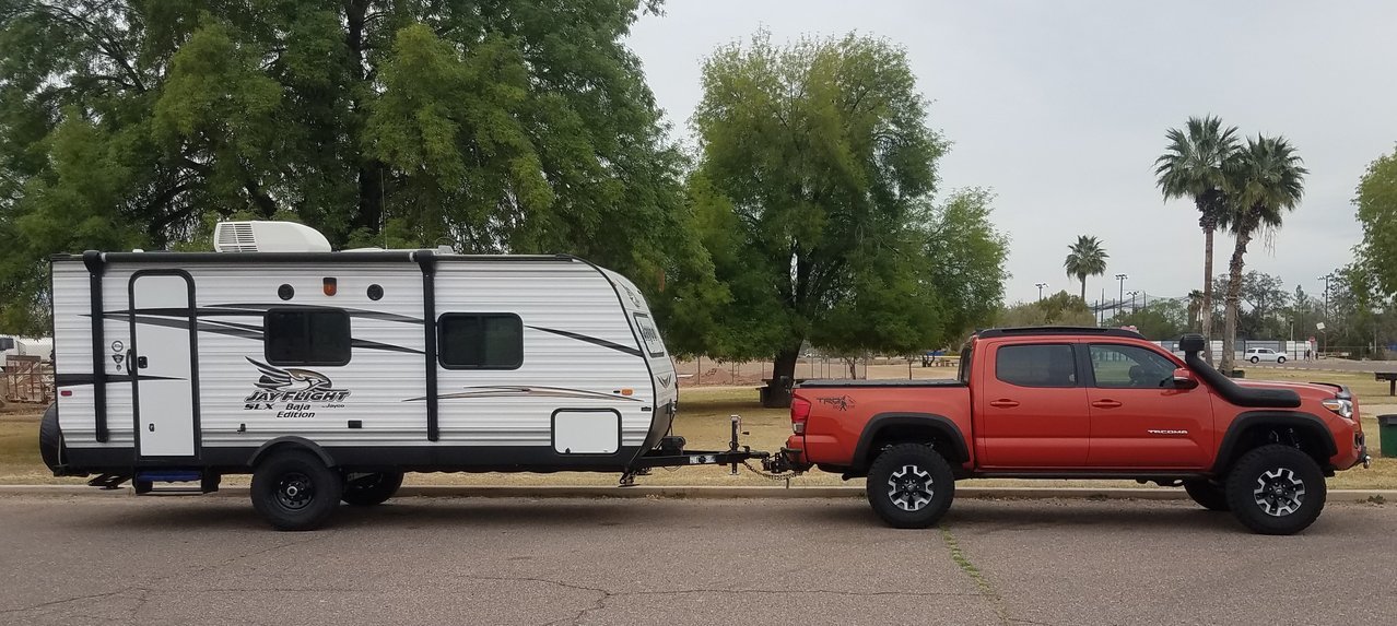

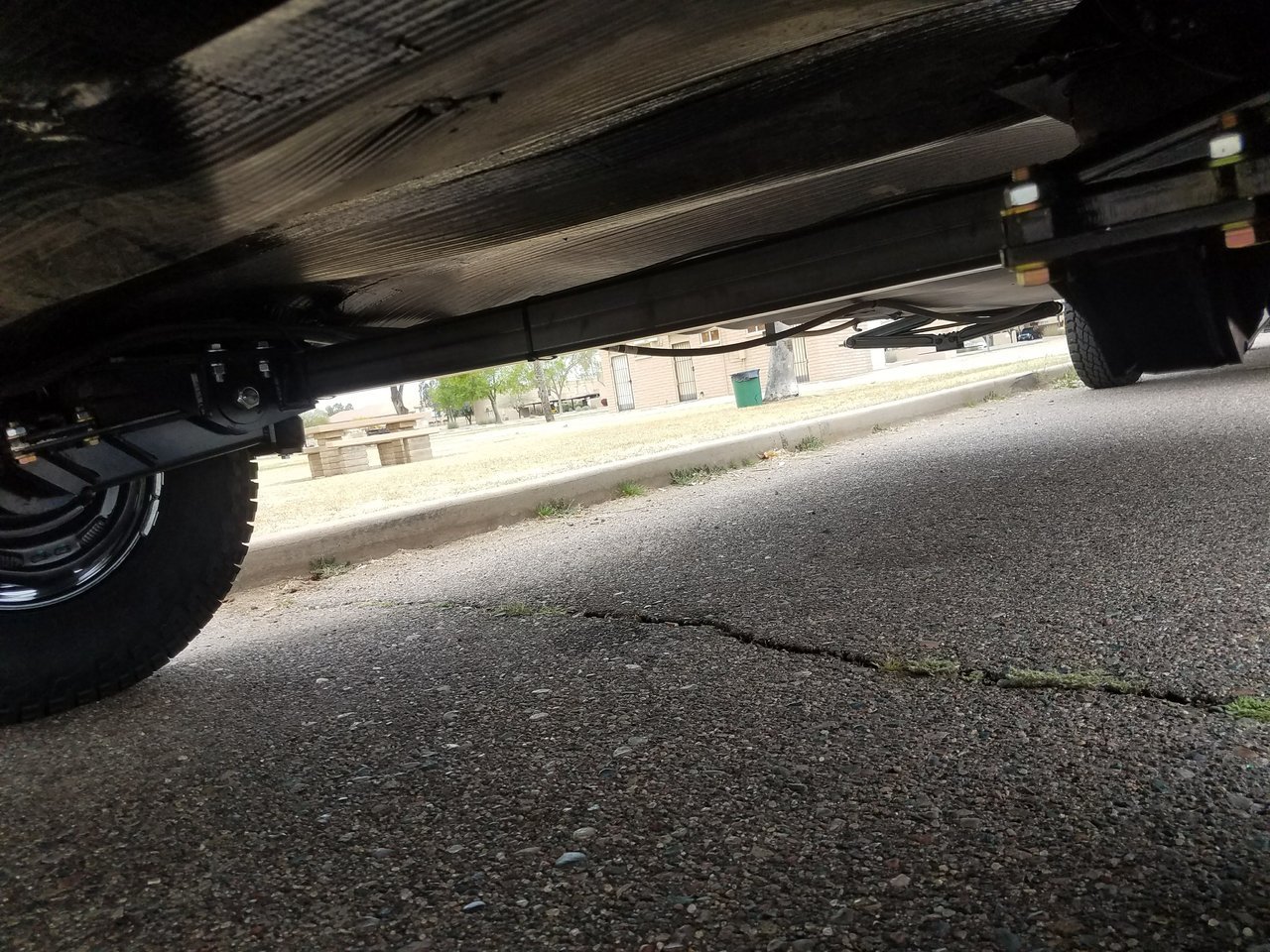

    So we uograded to timbren 5200lb timbren Axle less suspension and 235 85r16 load range E Falken AT3 tires. It's only about an inch higher than it was with the previous suspension tire combo and has far as we can tell no rubbing. There is way more ground clearance with no axle and preliminary parking lot curb bashing shows the ride to be much smoother.
    Of course my favorite part is how much better it tows with the load range E tires. It's basically feels like I just lost 2 flat tires behind us. Very Very Very happy with this.
    I'll add some better pics and more performance related updates soon.
    Until then...
    Contrast of the 235 85r16 mounted VS the stock load C 235 60r15

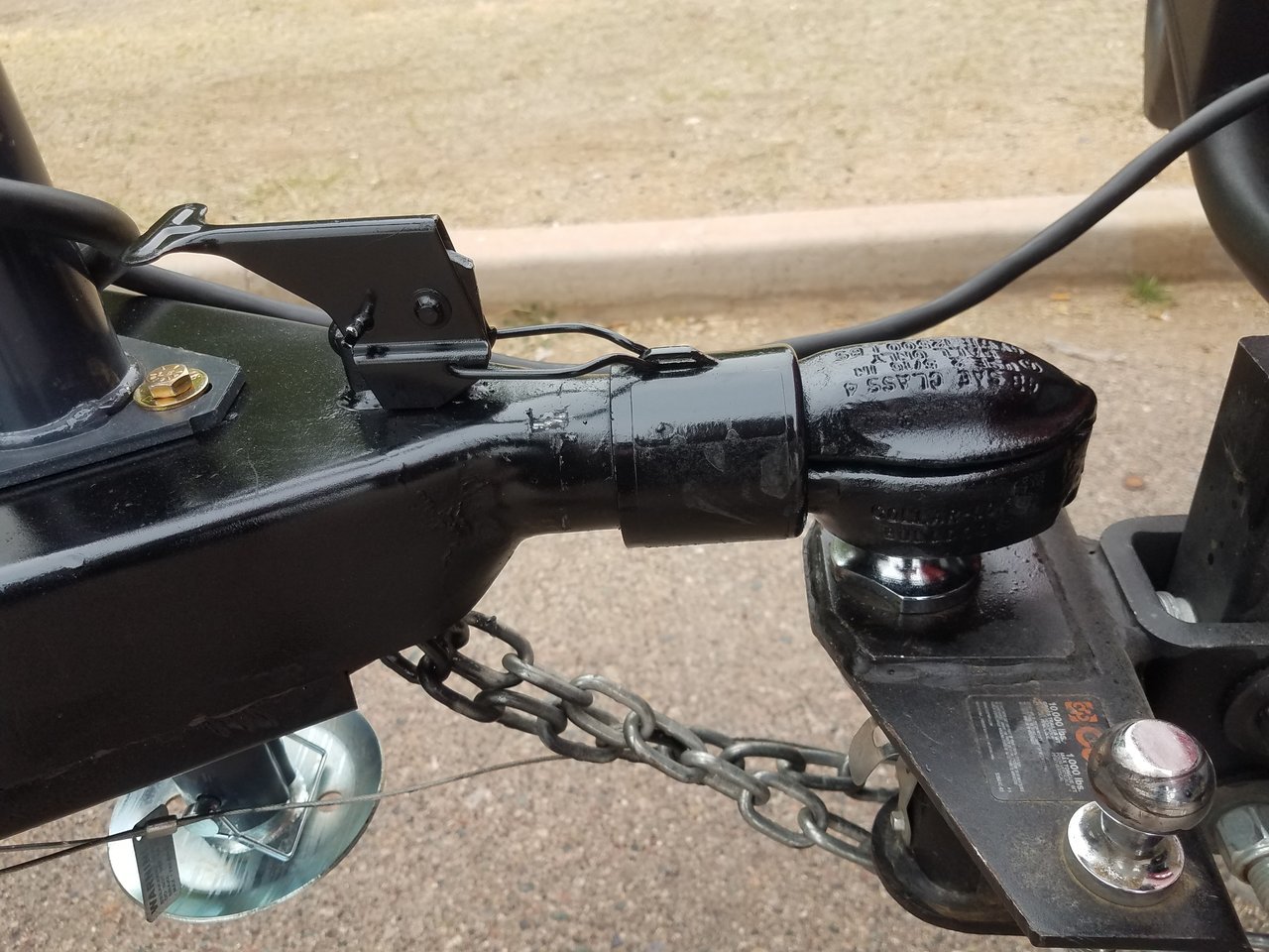

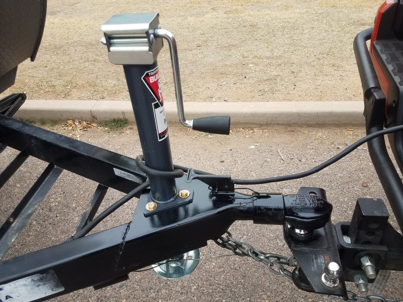

    Also had 12500lb Bull Dog Collar lock coupler welded on. It has 15 degree improvement in rotation and is probably the the strongest trailer to truck connection.
    And added a bull dog trailer jack to make lifting the rear of the truck up easier for the new WDH chain hangers. Also got rid of the fast way flip jack which was dangerous when parked on hills:eek:

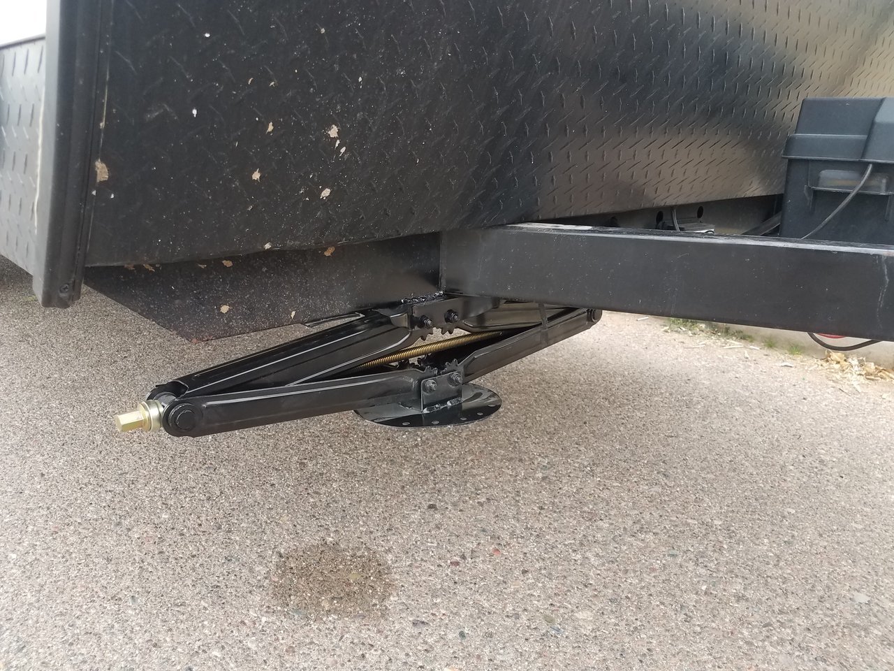

    And lastely 5000lb 30" travel stabilizer jacks on all four corners which means no more stacking blocks when parking on uneven terrain.

    That came out REALLY nice
    I wasn’t sure what to expect with all those changes, nicely done!

    Im really pleased! I hate not working on my own stuff but im not that good of a welder so I had to leave it to the pros. It was pretty much a nail biter for me waiting to see it. I asked them to fit tires with no excessive lift and inwas really pleased/worried when I saw it. The tires looked stuffed but after having my fiance take it over a couple curbs at speed while watched outside I was satisfied lol

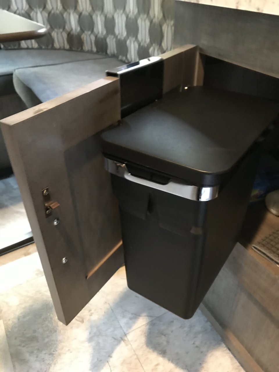

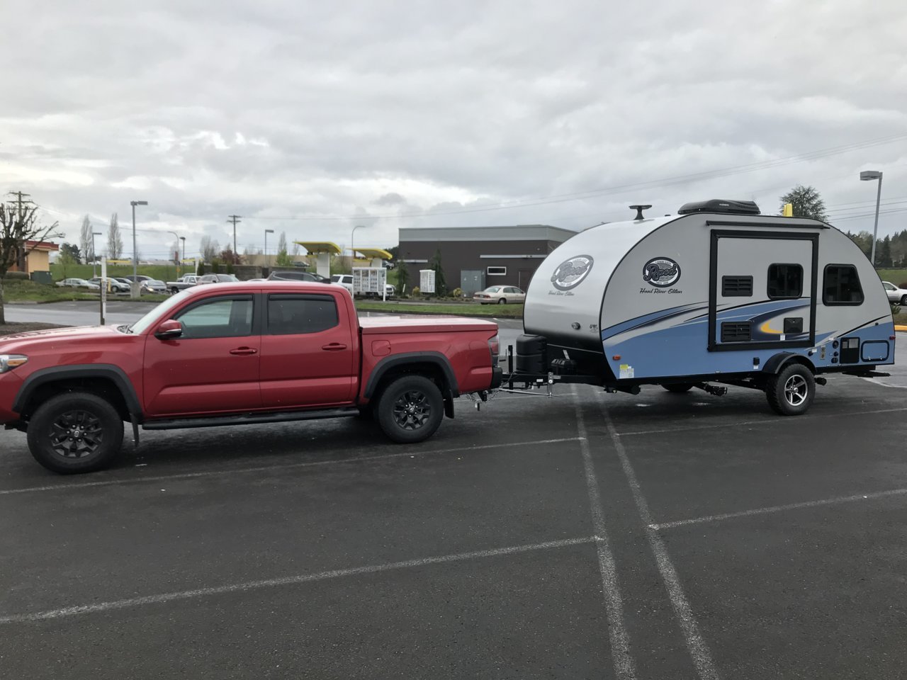

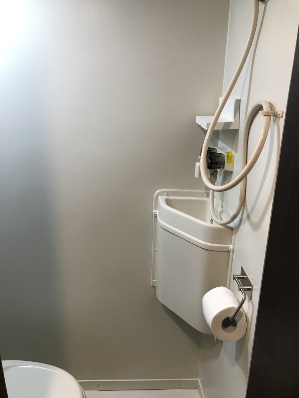

    Attached a lot of command strip stuff along with a perfect garbage can for my Rpod.

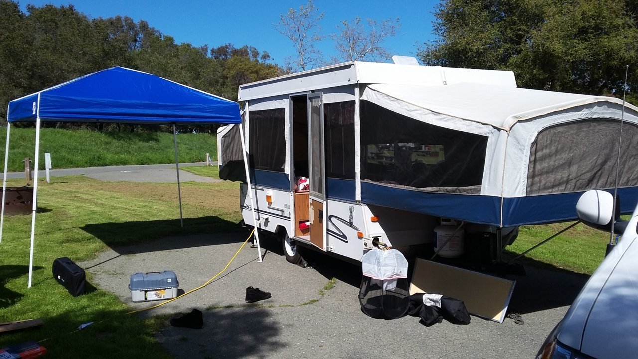

    20170311_123939.jpg charged the battery. Need to pop it and get it cleaned and stocked. But I've gotta go out of town for work next couple weeks. These are pics from last year's maiden voyage. Best 500.00 I've ever spent.

    If I were to do it again Id probably have stuck with the spring over and used progressive bump stops and decent shock absorber. I'm having some issues with Timbren right now.... Basically their springs have no ability to hold their rated weight and their customer service blows but I'll give more details later when I get back home :p

    Well that sucks, my Timbren setup have been performing flawlessly.
