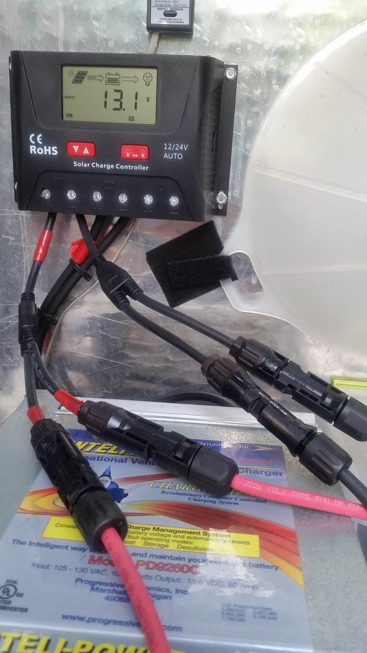

    I don't know if it's the proper way to do it, but I just used a pair of branch connectors at the controller box. I had to cut the one mc4 connector off the leg of each Y connector to screw it to the controller.
    Sun YOBA 1 Pair Y Type PV Solar Panel Cable Connectors MC4 Male Female M/F Wire Branch Connectors https://www.amazon.com/dp/B019325Z5A/ref=cm_sw_r_cp_apa_i_ZH.hBbMR670YB
    You can see the positive leads for each combined set of panels hooked to the branch connector that is in turn connected to the positive side of the control panel, and likewise the negative leads to the branch connector and into the control panel.
    The roof panels are branch connected to the one positive lead and the portables are branch connected to the other.
    Does that make sense? If not come on out, I'll show it to you
    Also, the roof panels were wired reverse of the portable panels ( they were Zamp ready ), so I had to switch the mc4 connectors on the wiring to make all the positives/negatives match their respective connectors to the control panel.

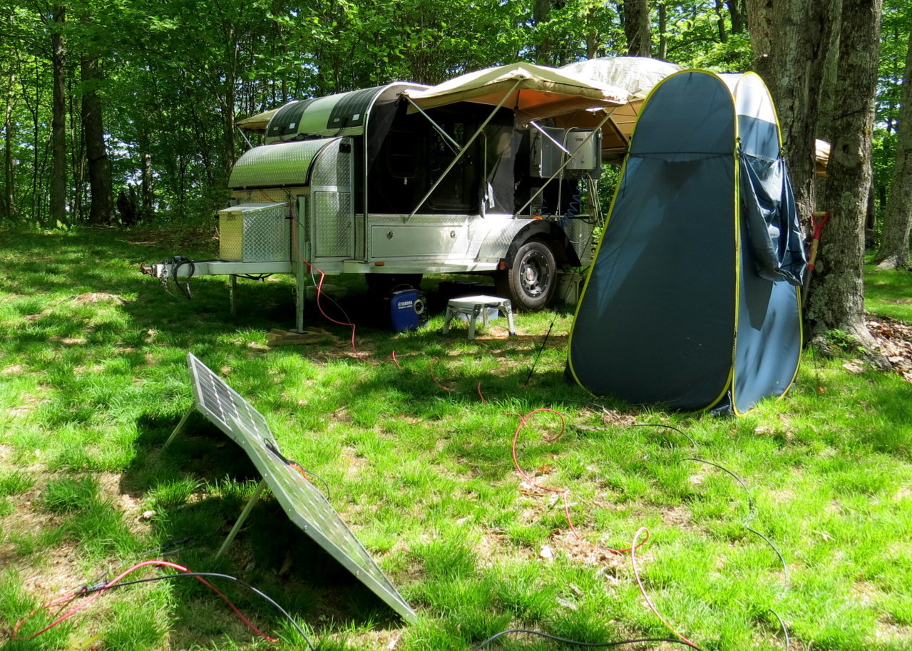

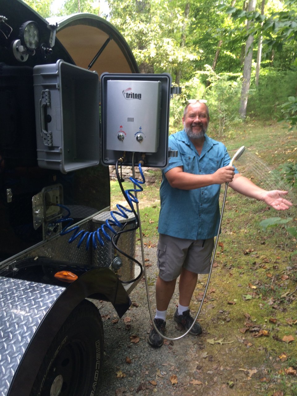

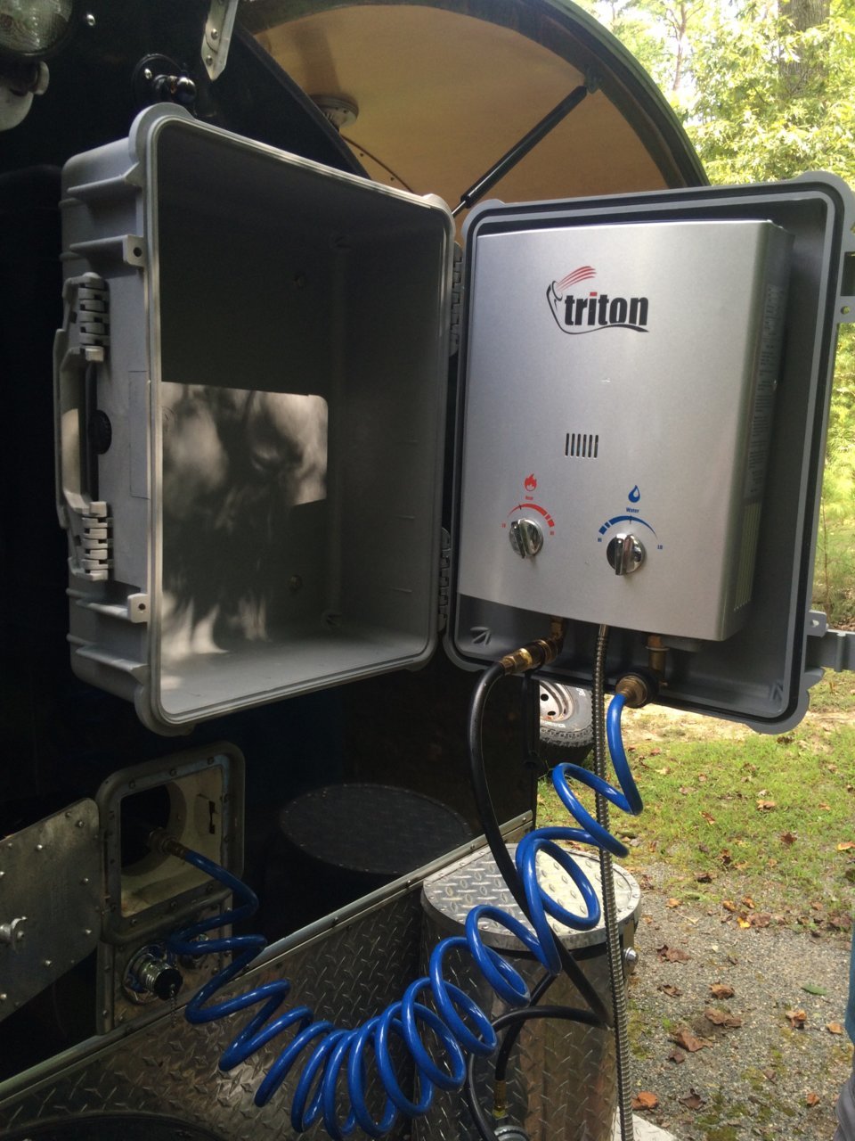

    We use a Triton water heater. It is carried in a pelican box permanently mounted on the side of the teardrop. We've got a 40 gallon water tank and a shur flo pump. When we get to camp it's just a matter of connecting the water line and propane line to get a hot shower. We also use the Green Elephant fir a shower house. In our experiences over the last several years it's been the easiest to set up and roomiest shower house we've used. It's tall and wide at the top do your not hitting your head our dragging your arms all over the sides. It collapses down to almost nothing and is very light weight.....
    The Green Elephant shower house. Hot showers are the bomb!

    Functional. That's what its all about right? I added some pics to my shower post so all y'all can see how it's set up.
