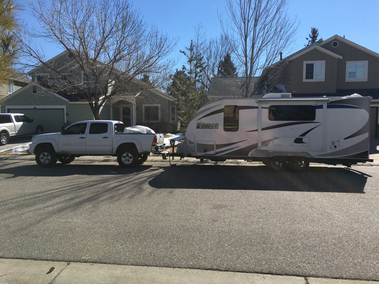

    We still love the 195rb. Its allot of trailer for the size and tows well with the tacoma. We've made 3 round trips from Phoenix to Oregon and numerous camping and beach trips to California. In my opinion Its definitely optimized for 2 people. It does have the capability to sleep a couple more kids or a smaller adult on the dinette conversion but it would get crowded in there quick. It has the amenities a larger trailer would have just everything is scaled down. The stock battery is terrible so I would consider upgrading the battery capacity and adding solar as borderline necessasry. This trailer is still small enough to get into tight places and take off the beaten path which is great because I hate RV parks and established campgrounds.
    Now the biggest downside we've found to this or any travel trailer would be a dissociation with nature. We miss laying in bed staring at the stars and listening to the monsoon rains on the tent. Perhaps it's a little too comfortable. We're planning on selling in a year or so and either Ill build an expo style trailer from the ground up or convert a 4x4 Van. Either way well be sleeping in an RTT.

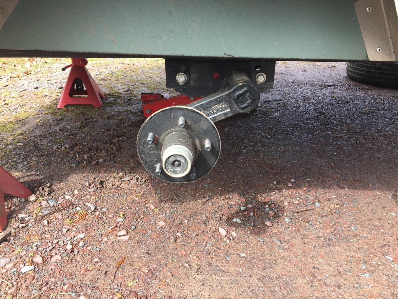

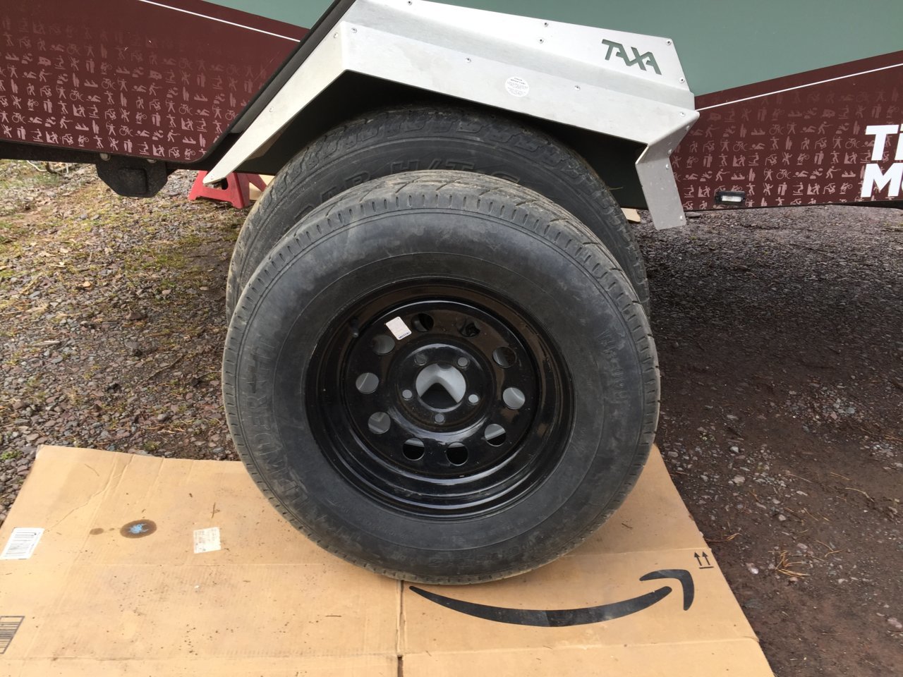

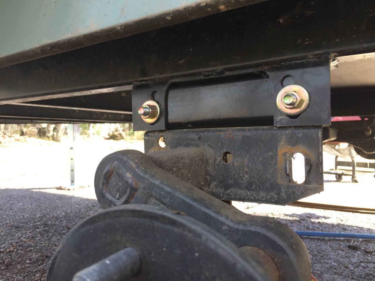

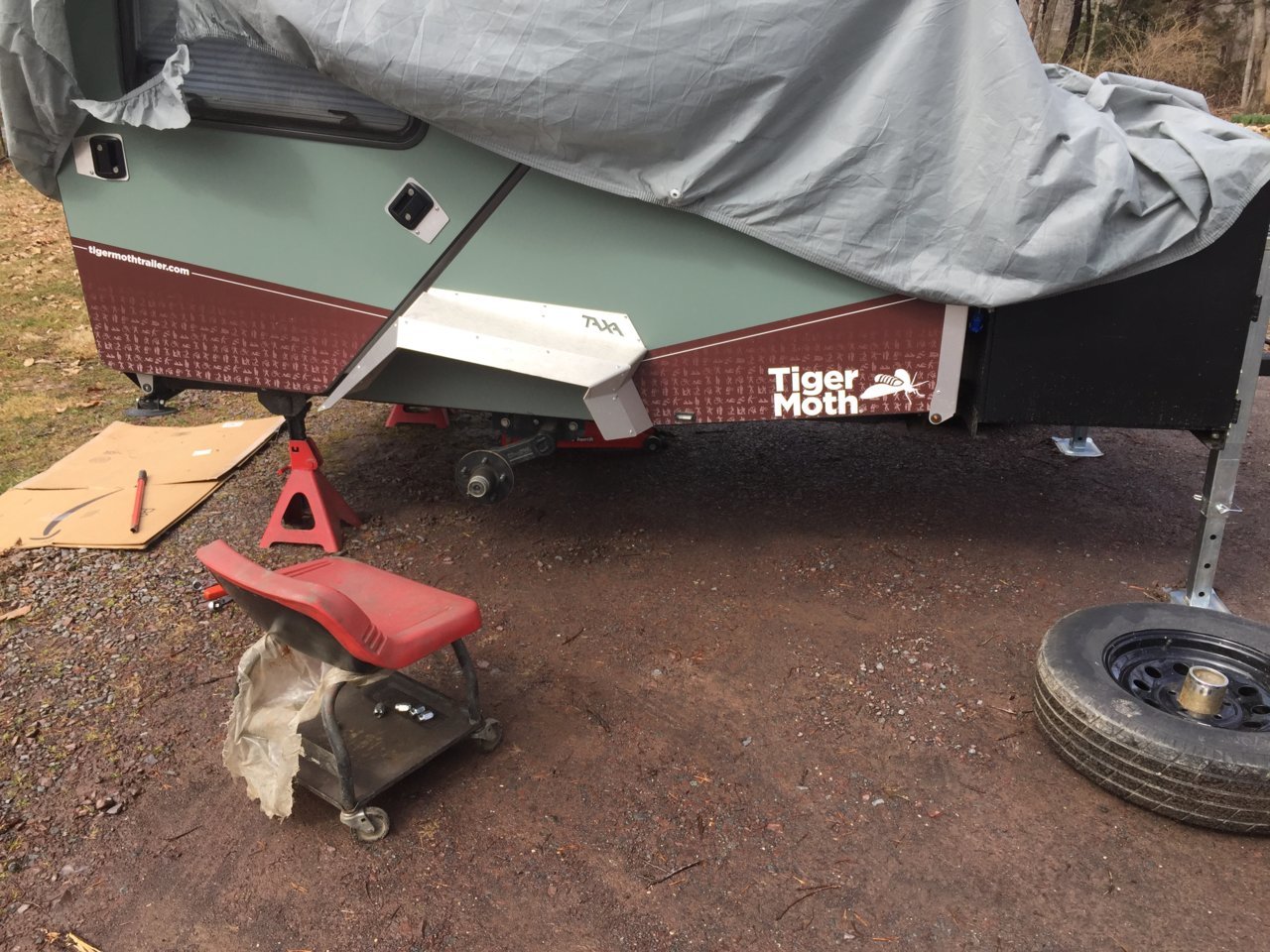

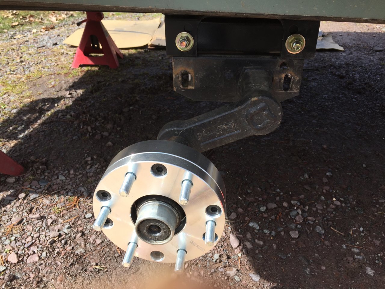

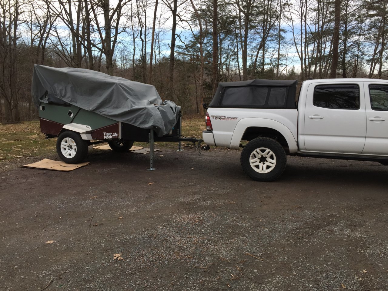

    Been busy with the Tiger Moth. Dexter 2 1/2" lift, hub adapters converting from 5 lug to 6, 1st gen Tundra wheels, and now figuring out the fenders.

    That's what I was doing this weekend 2 5/8

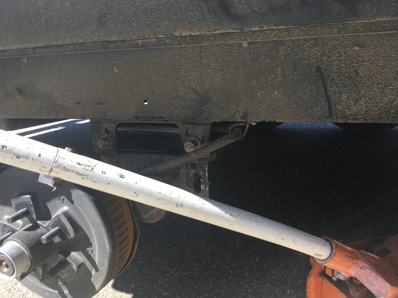

    Before
    After
    Now I wont be dragging on everything.

    Pretty straight forward lift. Now that it is in and I have figured about everything out I may go ahead and weld them to the frame and maybe weld a square tube from one to the other for extra bracing. It couldn't hurt :notsure:

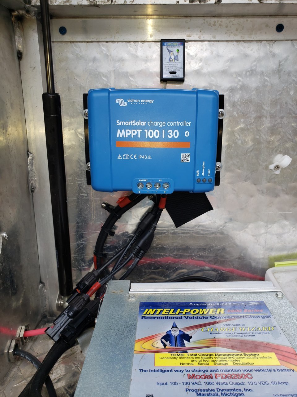

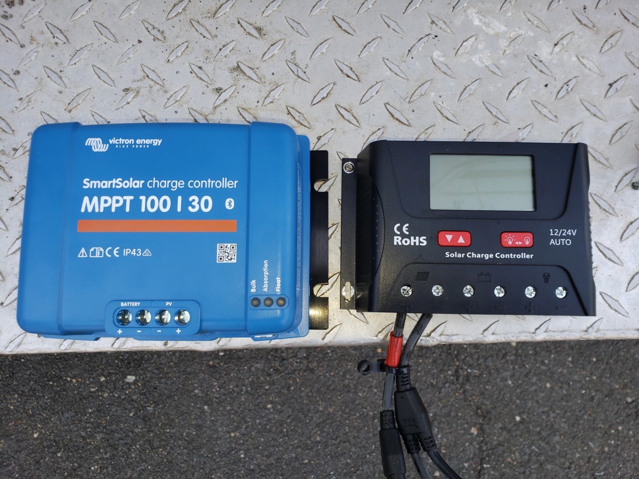

    Removed my old PWM solar controller and replaced it with the Victron Smart solar MPPT controller

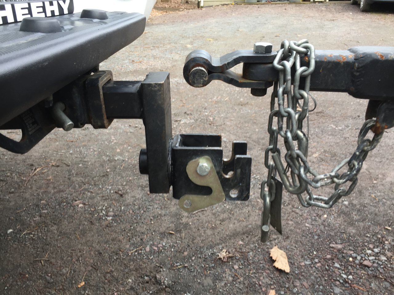

    I realized after doing the fender modifications that mud flaps are needed. I fabbed up some brackets and they worked but as @Wild Crow pointed out they left a gap so I just adjusted my approach and BINGO
    Then I changed to this and much happier
    So in the previous post you could see there was quite a bit of difference between where the camper hitch sat and the truck hitch. I had to do quite a bit of figuring, guessing, and hoping my calculations were correct. I installed the standard SOS Concept rear bumper with dual singouts on the truck. I also installed Deaver stage III progressive leaf packs with 2 over loads for 11 leaves total and Bilstein B110's which raised the back of the truck some more, accomodated for the weight of the bumper hanging off the back, and prepared for the tongue weight of the bumper. Alot of variables here folks but I'm sure most of you have had to do the same.
    well I got out and hooked it all up the other day(I'll admit I was a little scared to do so) and was tickled to see it all worked out.
    I took it for a spin even getting it up to about 70 and mixing in some back roads and it pulled great. I'm still not sure about the hub adapters so I may end up changing the hubs and installing some hubcentric wheel spacers but we will see

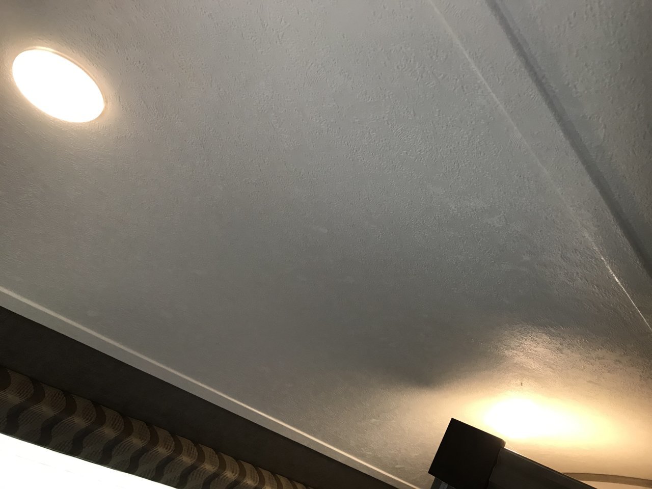

    Toned down the impossibly bright interior lights.
    Used “Smoke” Plasti-Dip
    It looks like it would be a lot dimmer. Left is tinted, right is untreated.

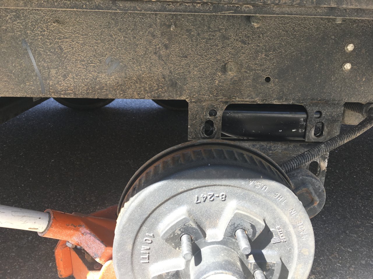

    Nice. Lift is a good thing IMO, fairly easy with torsion axles just gotta make sure the axle(s) are straight so the tires don't scrub.
    Me and the neighbor tried to flip his leafsprings on his toyhauler, did not know a kit is needed and tack welds on the axle tubes. https://www.etrailer.com/Accessories-and-Parts/Dexter-Axle/K71-385-00.html

    Did a flip on both of mine. Made my own kits. Cost me less to do both trailers than it would have cost to get just one kit.

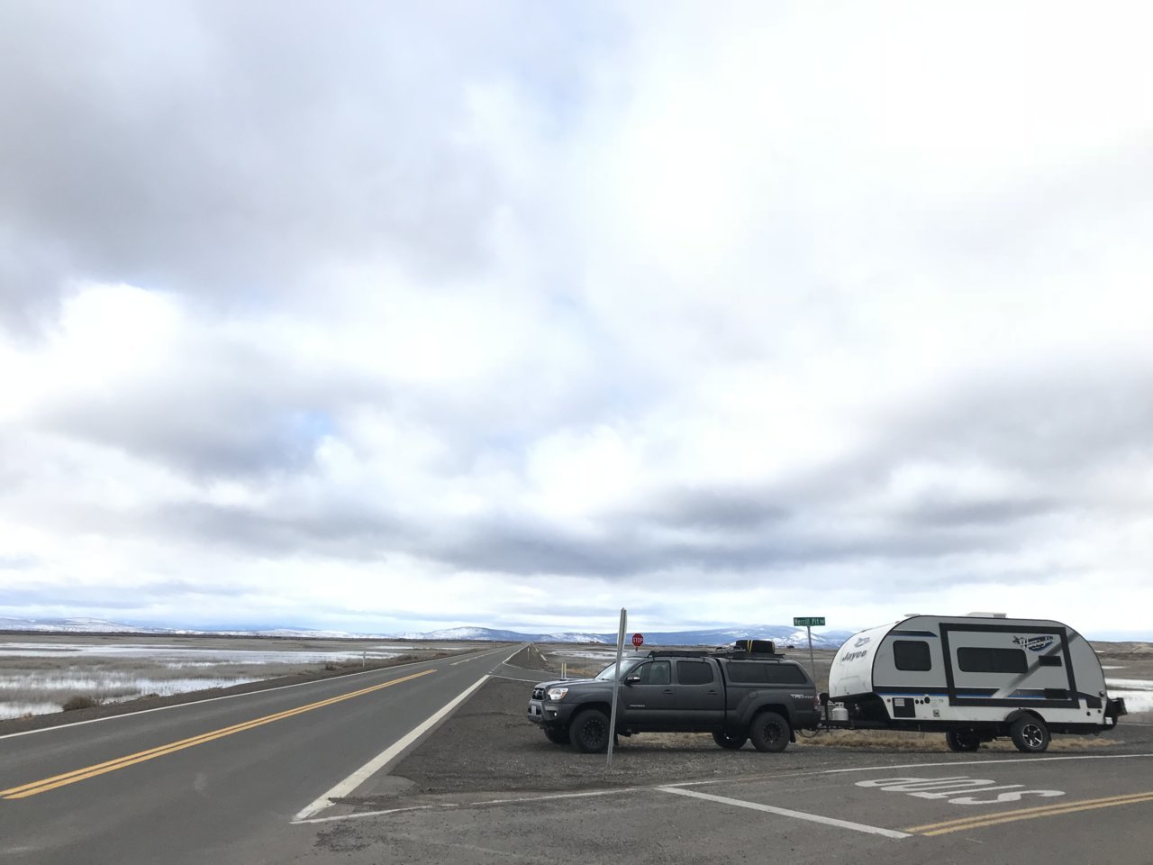

    We bought a Jayco 17RK Hummingbird, Baja Edition, and love it. 3500# gross weight and it tows very well behind the 2014 DCLB. We do have a weight distribution hitch, which helps reduce the amount if bouncing we feel in the cab. We'd rented a number of other trailers, each of them having dual axles, and I feel the single axle allows a little more vertical bounce over bumps. I also installed Firestone Ride-Rite air springs - set to 40psi whenever we have stuff in the truck along with the trailer.
    Changes to the trailer:
    1. Mud flaps. Right after the very first outing on a gravel road. Those bigger Baja tires throw quite the rooster tail. I bought commercial truck glass-reinforced rubber and cut them down a bit, though they're wide enough to extend under the trailer a bit too. I just bolted 'em up using stainless hardware.
    2. Backup/rearview camera. The Hummingbird is 7' wide, so I don't mount extended mirrors, though even if I did there's still a pretty deep blind spot back there. So I hard-wired a camera and then did a write-up here:
    https://www.tacomaworld.com/threads...en-tacoma-today.6499/page-10010#post-23096277

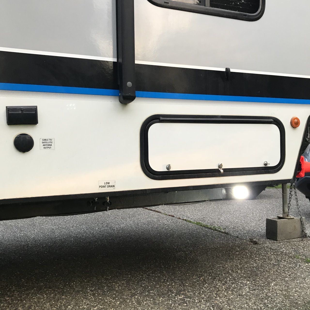

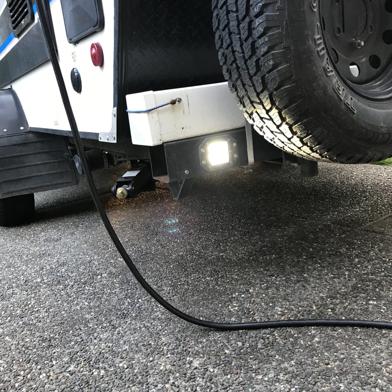

    3. Reverse lights. We often show up at our camp spot after dark, just poor planning on our part. One mounted in the rear bumper, though I have a second one to go on the other side to match. And, two under the forward end of the camper aimed out a little to light the wheel area. All three come on when in reverse, but we can also turn them on individually from a switch panel just inside the camper door.

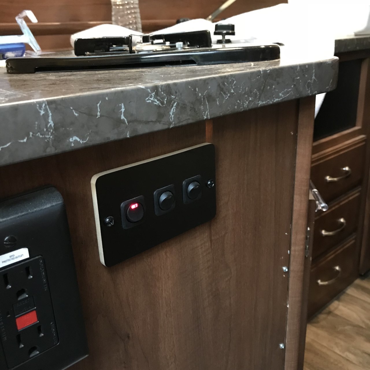

    4. Cabinet lights. These are LEDs that I found at IKEA and wired through a reed switch so they're automagic like a refrigerator at home.
    5. Bumper hitch receiver. We mount a rack behind the trailer to haul our bikes, the same one that fits the truck when we're unhitched. That way we can park the home and explore with the truck while still bringing the toys along - bikes on back, kayaks on top.
    6. 7 Pin socket. Because our bikes have fat tires, the tail lights are hidden when the bikes are on the rack, either on the truck or the trailer. So I made a set of tail lights on aluminum square tubing that straps to the bike rack that plugs into the 7 pin trailer connector. Adding another connected to the tail end of the trailer makes the light bar usable with either.
