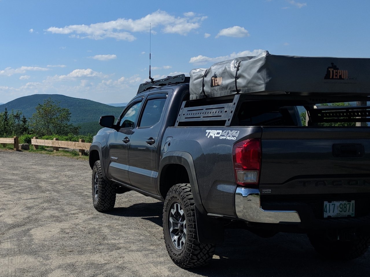

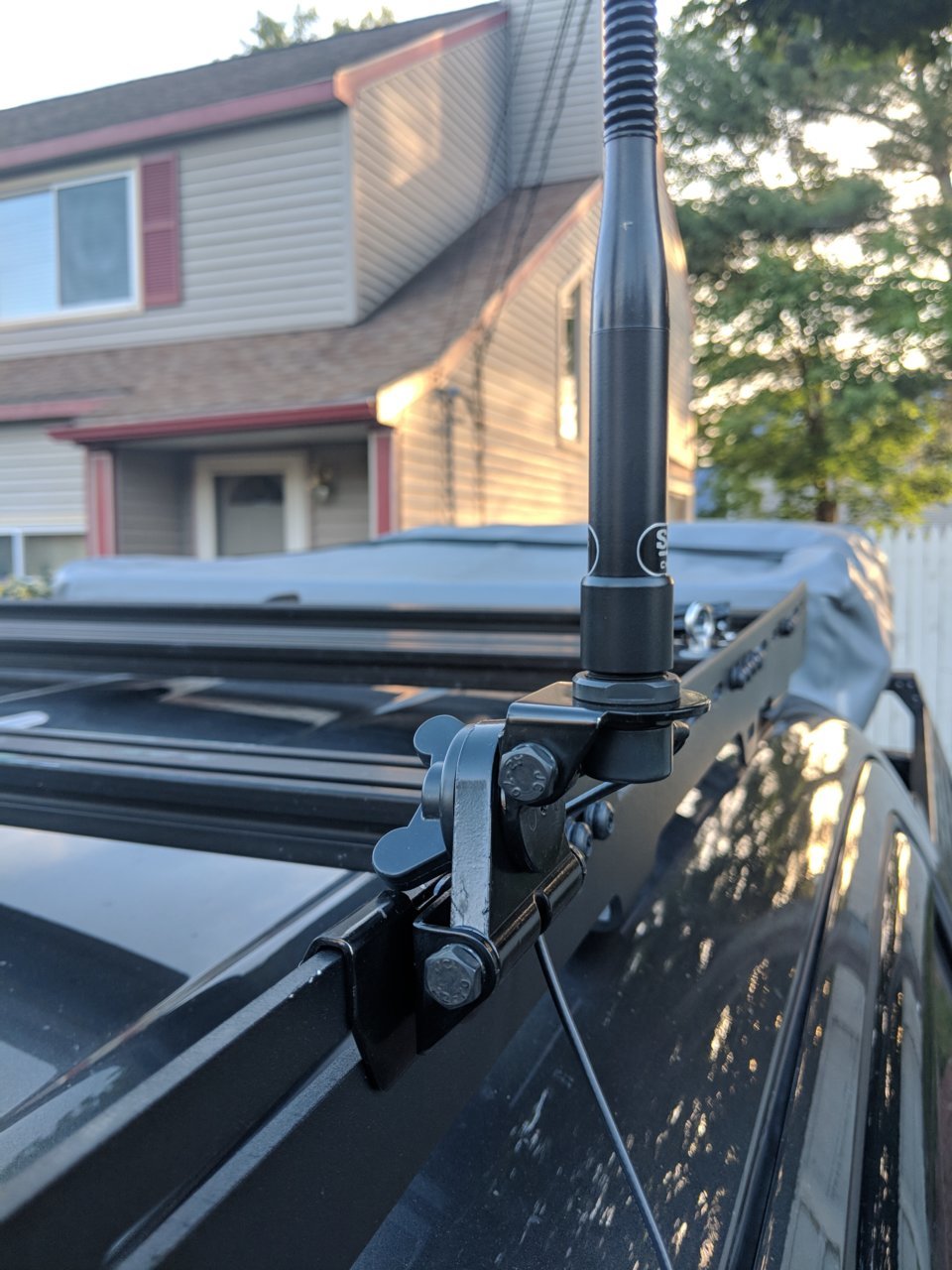

    Also, I can hit guys miles away with my radio. And then you get into the world of repeaters which do what their name suggests. So far I've got 70 miles as my Max distance.

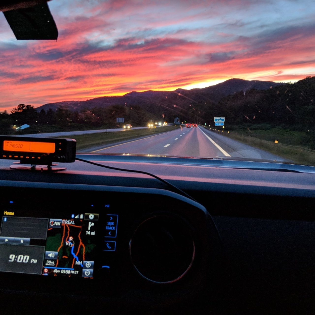

    And here's my radio. I waited a bit to see if it's something I was really into. I found I used it a lot more than expected when not wheeling. This rig covers all my travel needs, emergency needs, and long distance needs. Biggest feature being the dual recieve feature. Key if you're monitoring your group and the area (aka if you're someone's potential only hope but you can't hear them on the national calling freq because you're on a wheeling band).
