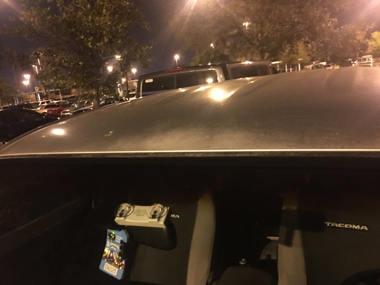

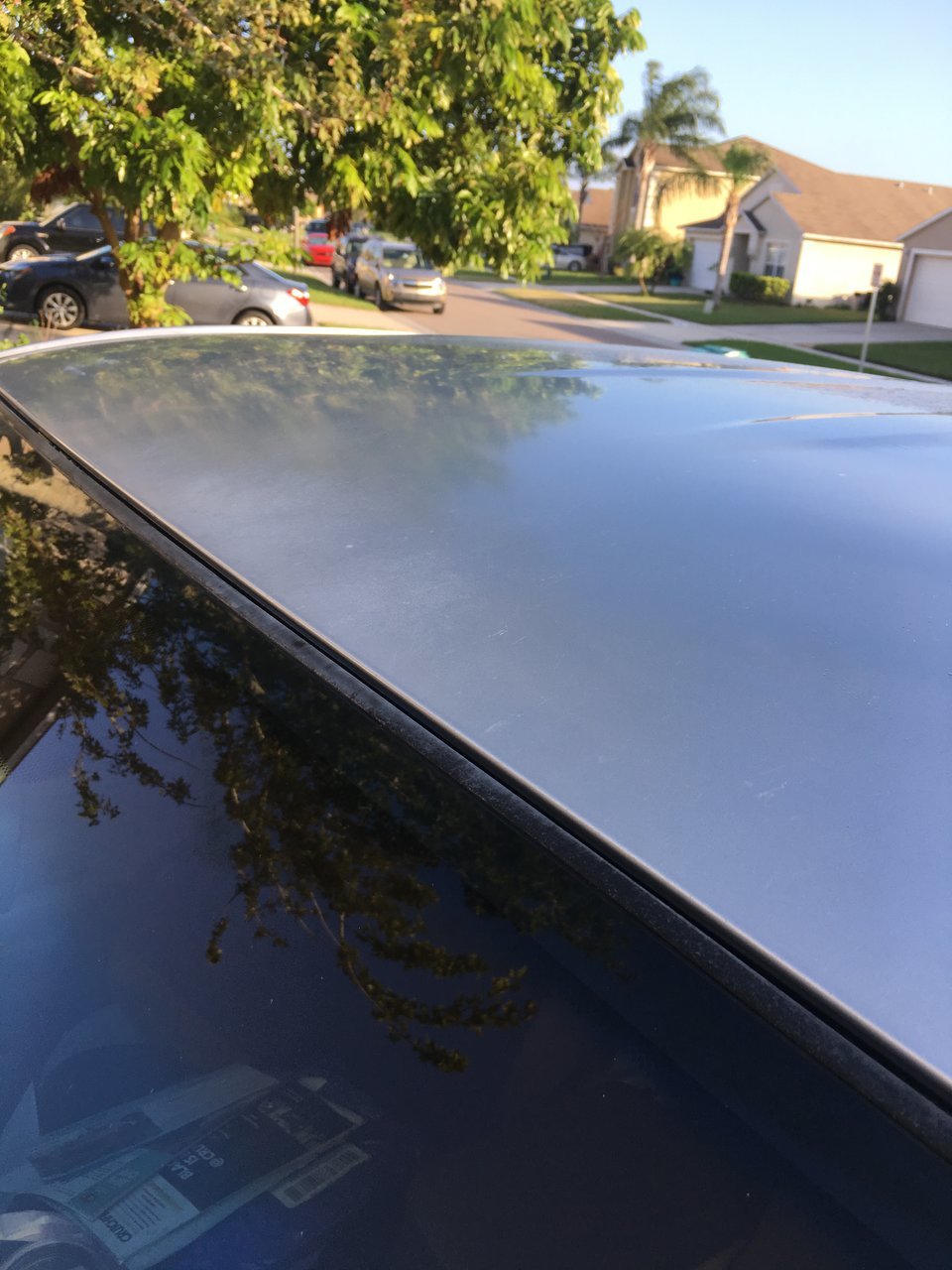

    Hello everyone, I have a 06 double cab. And recently I started to notice a haze on the roof of the truck on the very front in the middle. When I wash and dry it is still there. Here are some pictures at night and day. More visible during the night. Do anyone have any thing to clear this up?

    Try wax. Paint can oxidize and wax can take it off.

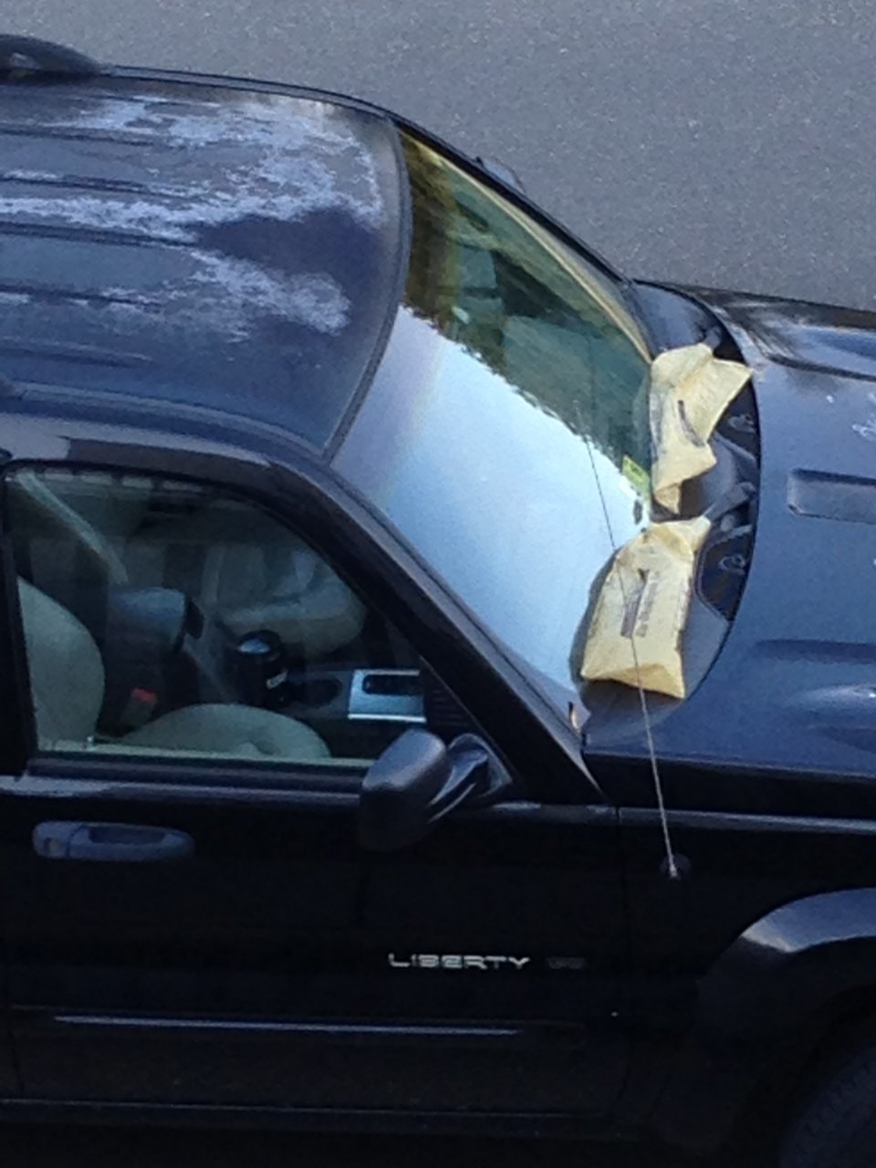

    For a comparison, below is a pic of my idiot neighbor's car that he lets sit in place and rot on the side of my house. It's a good way to study the break down of clear coat and paint. Note the really dark area above the middle part of the windshield.

    Repaint is the only choice.
    That's broken down/peeling clearcoat. No 'elixer' will fix it.

    I use MeGuires Gold twice a year and then touch up between the 6 month paste wax with Lucas quick shine. Both are at Wal-Mart.
    The Megs Gold has carnuba which really works well and goes on easy.
    IMO you most likely have caught this in the early stages. If you use the two products I mentioned above over time and the issue still persists then I would progress to polishing. That's a whole other can of worms to get into and there are threads and websites dedicated to just polishing.
    Throwing a good paste wax on ASAP should at the very least slow down or stop whats happening.

    As others have mentioned it's the start to clear coat failure. Unfortunately our Tacomas don't have that much clear. You can compound/polish the roof and that will make the clear coat failure a bit less noticeable. If you plan to keep the truck get it ceramic, quartz or silica coated and that will help slow down the deterioration of the clear coat. If you do use carnauba wax just wax it at least once every 2 months. A polymer sealant will last up to 6 months so maybe every 4 months (3x a year) and just use a spray wax to maintain it.

    Lovely isn't it LOL...he's kind of a moron. He just lets cars sit and rot. For me it's a spectator sport. It's also an opportunity to study what happens when one totally neglects a car.
    When the clear coat started peeling off it looked like Saran wrap sloughing off. As it sits now the paint layer has third degree sun burn.
    It's interesting that there is a pattern and symmetry to to paint decomposition. The front middle part of the roof just above the center of the windsheild is where it started and where the damage is worst. My pic just shows it as the darkest area but it's the most damaged area.
