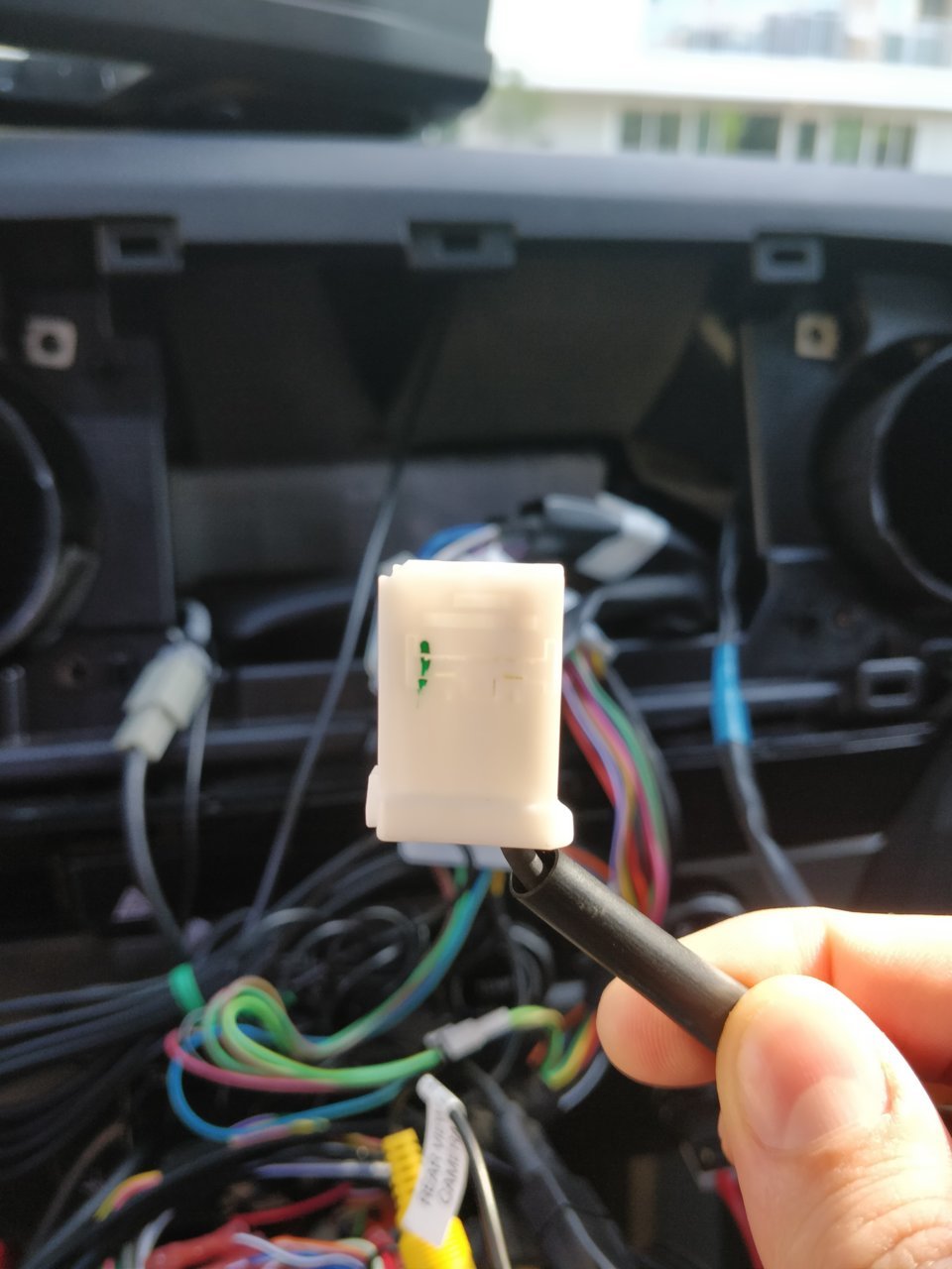

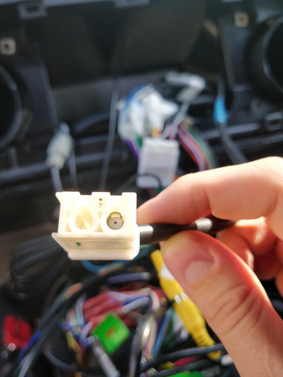

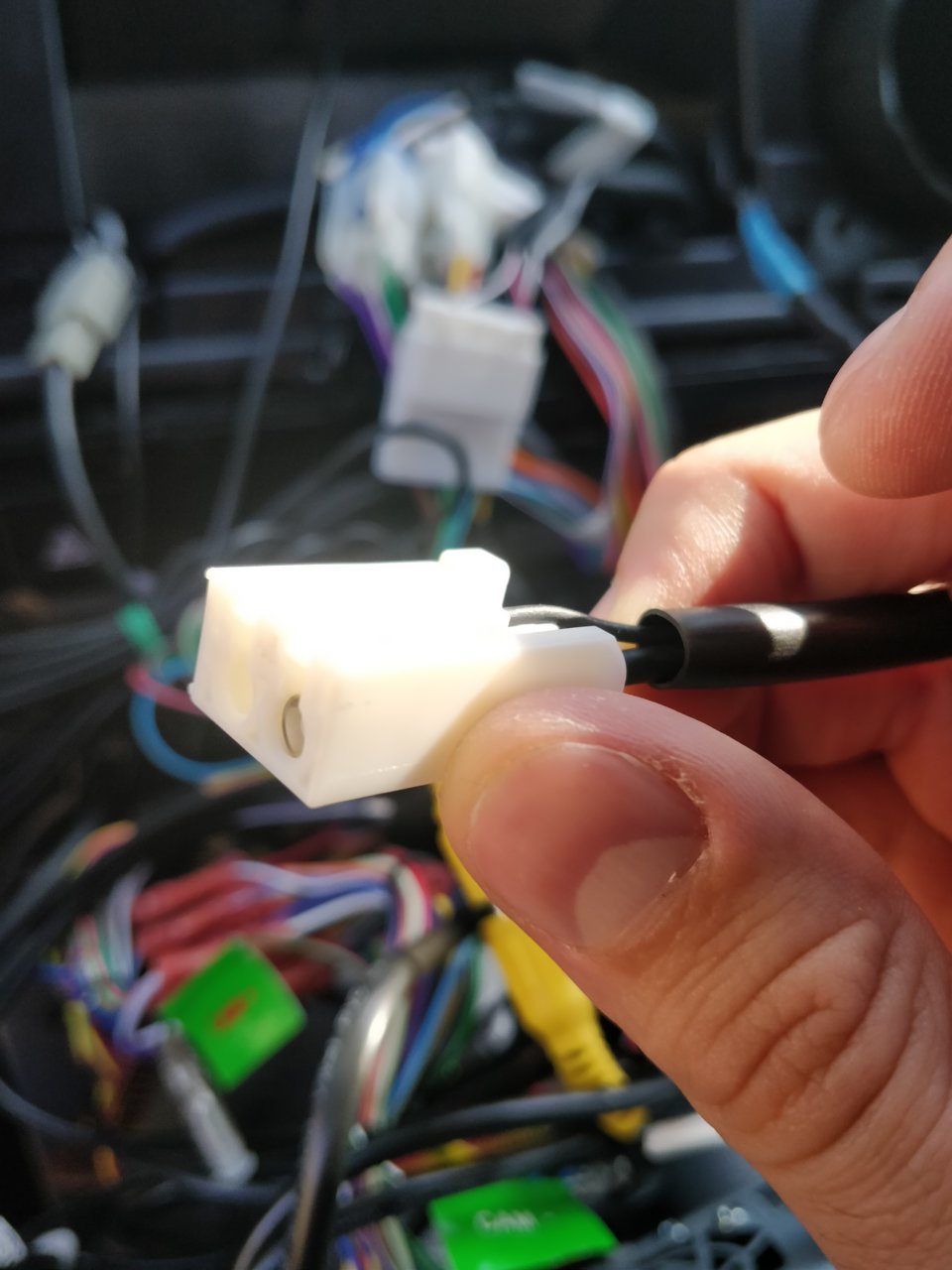

    I've been living in an adapter hell for the last week. I'm trying to hook my SiriusXM to my stock sharkfin antenna. I first bought the Maestro Acc-SAT-TO2 adapter pack: https://www.amazon.com/Maestro-Acc-SAT-TO2-Antenna-adaptors-Vehicles/dp/B01K03PORU. None of these adapters fit my stock antenna port. Then I bought this https://www.amazon.com/Maestro-HRN-ANT-SAT1-Aftermarket-Satellite-Antenna/dp/B012FARZ3M and it didn't work. Do I have a different port than the standard or do I need to modify the port?
    This is my stock antenna port:

    That is not the xm connector, it should be a black connector with a rounded edge. It is the black one in this picture from another thread here. Does your radio have the APPS button on the left side? If not then you do not have XM from the factory. My 19 SR did not have an XM antenna so I ran my own and connected it to the Premium radio I bought from a member here.

    I do not. I just have the base version of the head unit which I replaced with a Kenwood. I didn't see any black connector like the one in the picture when I was working on it

    Then you do not have XM in your stock antenna. You will need to run your own antenna. I was in the same boat, it's a pain.

    Oh shoot... What is the stock sharkfin antenna wired too?

    That large white connector in your first post. It's for FM/AM only unfortunately.

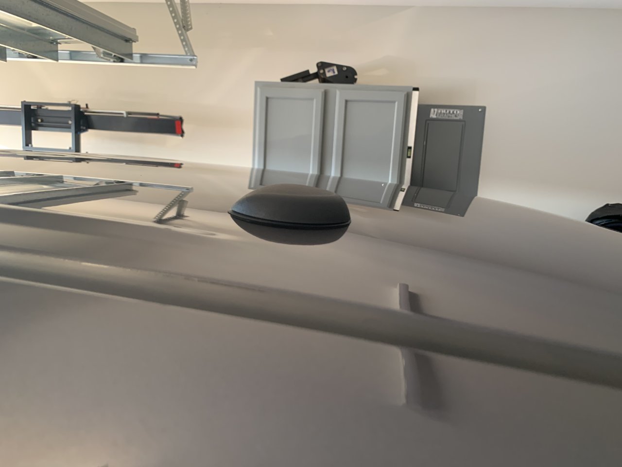

    I actually went all out and used a OEM Ford F150 antenna and drilled another hole in the roof roughly above where the passenger sits. The shark fin still runs the AM/FM.
