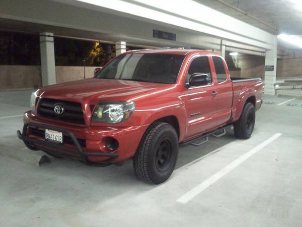

    Im runnin 15x8 rims with 3.75 backspacing ... 30x9.5 tires ... 3mm spacers in front to clear the calipers
    they stuck out about an inch or so from the fender

    Sorry to Jack thread, what's the tint on the truck kdogg

    20% front and 15% rear/back
