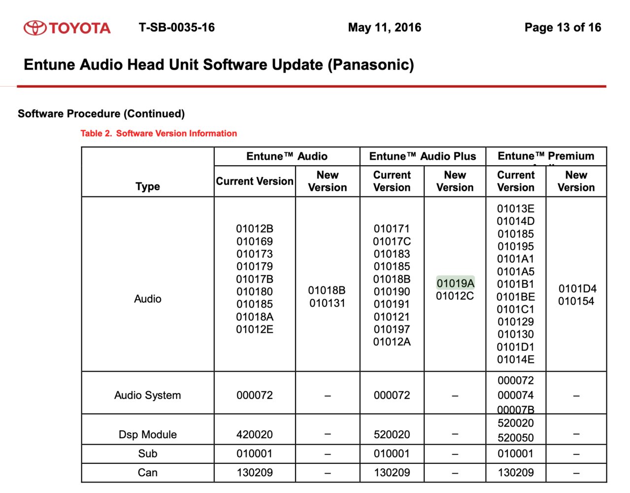

    According to this post, my firmware (01019A) is from 2016: https://www.tacomaworld.com/threads/headunit-reboot-issue.549234/#post-17837722
    I'm guessing Toyota has a factory full of these headunits produced years ago and they just toss them in new cars, just because my truck is a 2019 doesn't mean it has been updated since it was manufactured years ago... I'll try a new flash drive.

    Yup, 01019A is from 2016. Confirmed here: Screenshot 2019-02-13 .jpg

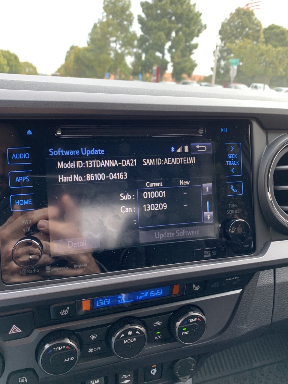

    Anyone else with a MT Pro (or non JBL w/navigation) willing to post their versions?

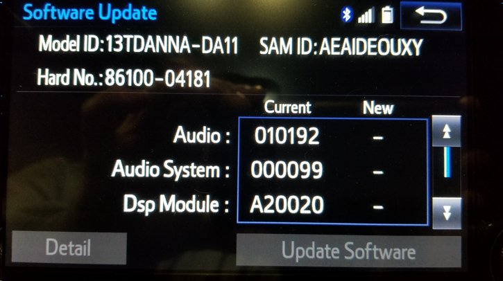

    Here is mine. The last update was done over the air via the Entune app. when they removed Pandora:

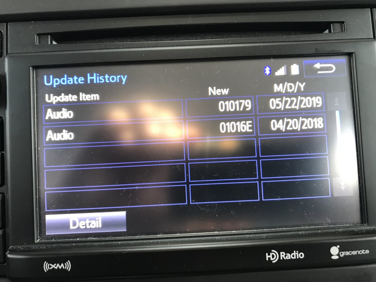

    OK - this is interesting! I have a (EDIT: 2017) Entune Audio Plus, and according to the chart, latest version for that head unit should be either 01012C or 01019A. But after a dealer visit to try to fix an issue where after activating Siri I don't get any album or artist info back on an HD channel, it now shows I have 010179 - which according to the chart is for the Entune AUDIO!! Can I get the link to that chart so if I need to take it to the dealer to show?
