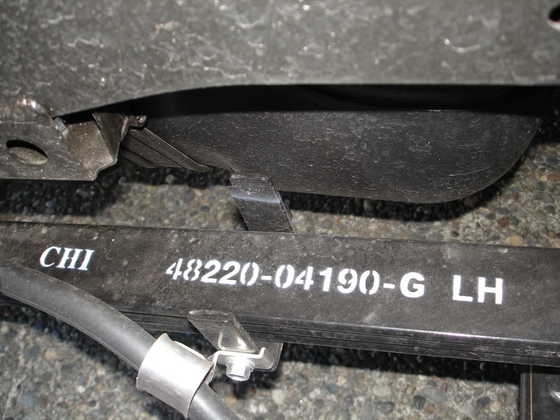

    supposedly the springs on the 09's are fixed so that there isnt a problem with them. however, there are probably some 09's that dont ahve the fixed springs, even though they arent the 4 leaf pack. check your springs and see what the end letters on the springs are and post back. more than likely, you have the updated 3 leaf pack, but i could be wrong. best thing to do is load the bed up and see where the bump stops are....how close they are to the frame. let us know. if they are close, and the truck rides "harsh" with a load.....you may be able to get a dealer to do the tsb done, or you may have to call the toyota 800 number to see if they will help you out.

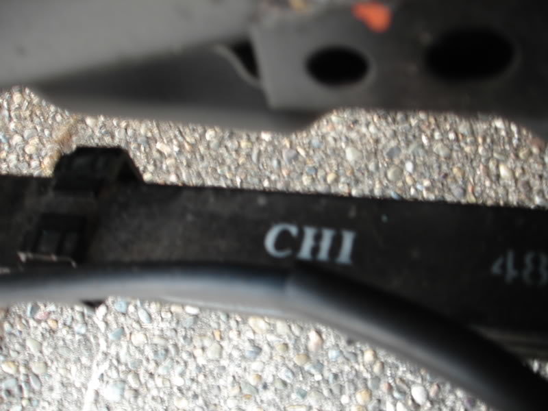

    Thanks! The letter I presume are the ones spray painted (guessing) in a stencil, if so, mine say CHI. Thanks.

    Oh and they are still only 3 leaf springs!

    the end letter on the springs should have a "g" at the end of the numbers. im not sure what chi is, but that soesnt really say anything.
    zero niner.......can you take some pics of the springs and show all the letters and numbers on the springs for identification?? post them on here for us??

    Um, hey I'm new at this, standing outside the wheel and just looking at the spring, all I could see was CHI
    Then I went to take a picture and low and behold, what magical numbers all in a row did appear!
    I could tell you that I built up and did all the suspension work on my 73 land cruiser and 93 land cruiser but I'm sure you wouldn't believe me... doh!
