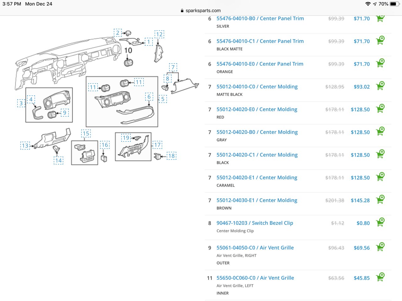

    Hi TW! Anybody know what this part is called and if I can buy one and put it in a Off-Road version to replace the drab black one in mine. Trying to make interior seem less dark.

    Item #7 “Center Molding” on this chart.. check your year/model first

    Picture isn’t my truck, it’s a limited.

    Just s thought. . .could be cover for passenger air bag as well. Might want to check. If so. . . Anything impeding the explosion of the bag would not be good. Or I could be totally wrong.

    I had an upholstery shop change mine out... 2 door panels, and the passenger airbag cover. Cost $267. I guess I like a drab interior.

    It is the airbag cover. I asked the shop if they ever had a problem with them. They said it pretty much just clips on.

    Incorrect, it IS NOT the airbag cover. It clips in and has two screws that must be removed first. One is hidden by the radio bezel. The other is hidden by the dash end piece, next to the glove box.
    The air bag is above this piece, in the dash panel. This piece is plain in the SR and has an appropriate matching material stretched over/glued according to the interior selection.

    Airbag is on top of dash. Just call the dealership with a VIN number for a limited so that you can get that interior color. They can't tell colors just by models. It actually may be cheaper to just have an upholster cover it .
