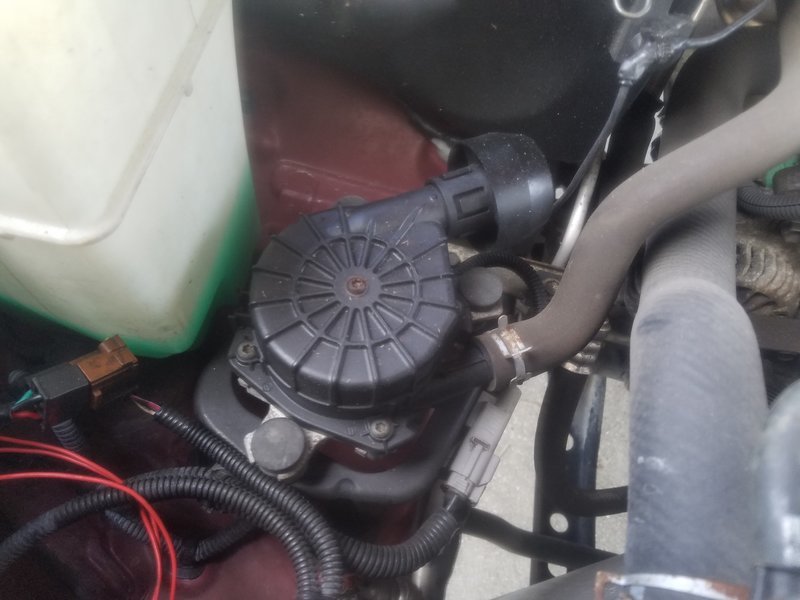

    Hello, I'm new to this forum and I would like to start by asking what is this? I recently bought a 2008 Toyota Tacoma and I looked under the hood and got confused. So what is this?

    Secondary air pump; for emission reasons. The most expensive worthless repair you will do when it fails lol. <--- that's what it is because when it fails your ECU goes into LIMP mode and you can't go above around 40mph, so its a must have, must repair item if it should ever fail.

    I thought only 12+ had those?

    Thanks a lot. Truck has 156k miles.

    Should I install that filter?

    Thanks, and is that filter a good idea to install on the secondary air filter?

    Seems like a good fix for something that could be an expensive problem. There is lots of chatter about it on this site, read up about it and decide for yourself. If I had one on mine I would do it.

    Yeah those started on the 2012 model year, shouldn't be on a 2008 unless someone changed the engine/ecu out.

    Unless it's a 4cyl. All the 4cyl. 2nd gen.'s had them

    Install the uni filter, but remove the little foam factory filter which reportedly breaks apart and damages the pump.
