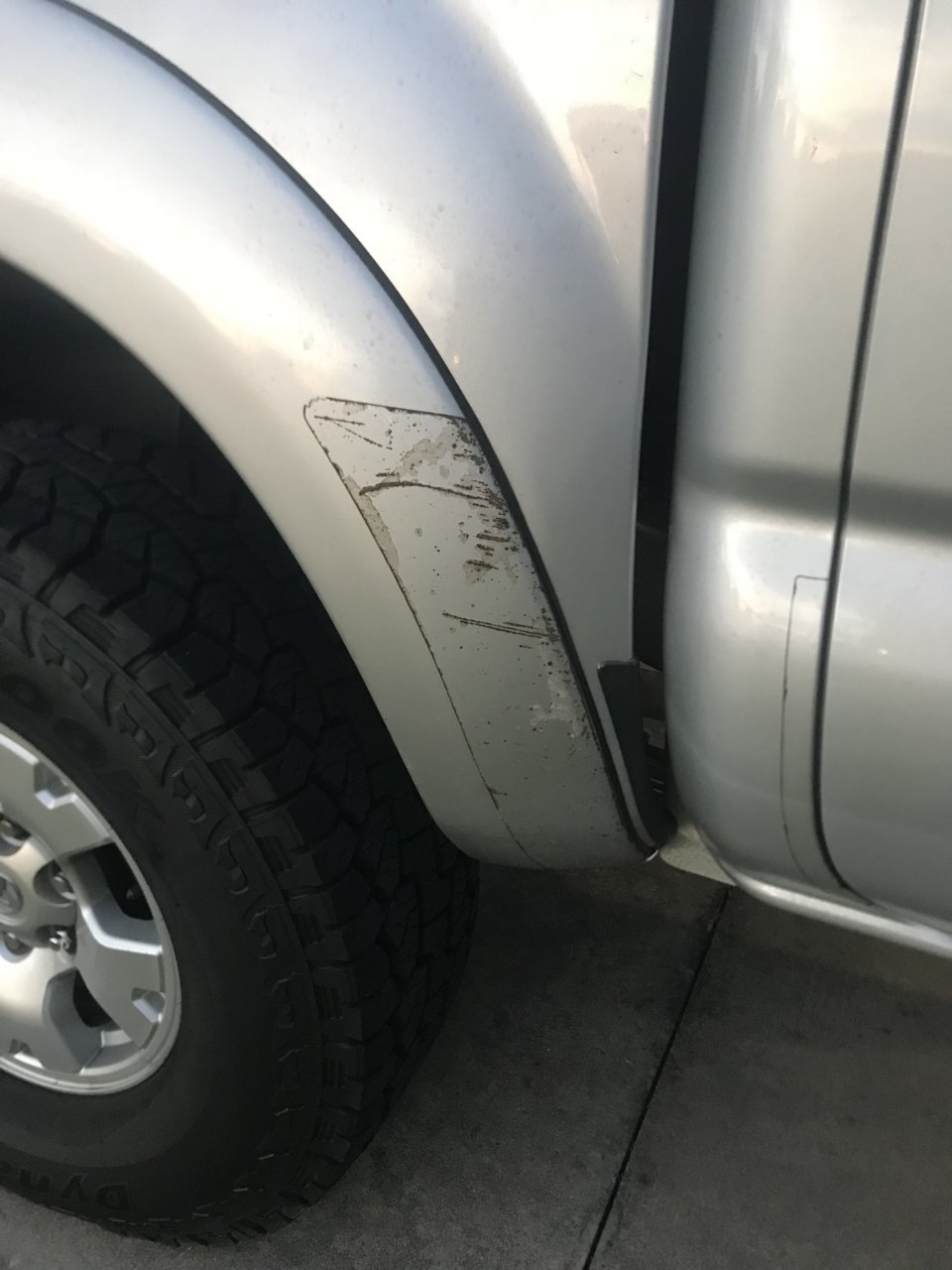

    I am curious about what you see in the picture. What is it called? I would like to remove it and replace it with a new/clean film or something more durable. On that, how do I remove this film? Anyone care to share what they did?IMG_0149.jpg

    Try removing with a heat gun. Its just a thin plastic protective film, looks like its seen better days.

    Yep its ready to go. By the looks of it, it did its job. Im trying to find a replacement to order so Im not driving around without something protecting that area. Any ideas what to put there or what to order?

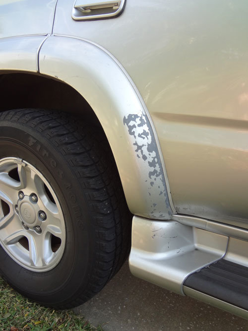

    Chip protection film. To prevent this.
    70% isopropyl alcohol will cause it to release. The dealership has replacement pieces

    it's "clear bra" or something like that. check Amazon. I ordered some for my tailgate so my trasheroo would not f it up while I wait for the eventual awesome bumper replacement.

    I removed all the factory clear film from my truck. I had someone to do it for me because I’m lazy but it will come off with a heat gun.

    It's not like clear bra, it is definitely glue underneath. I had a heck of a time getting it off a 10 year old Tundra, maybe easier for a newer truck but I doubt it. I used a heat gun, a lot of fingernail scraping and goo gone in a spraycan.

    Rock guard,Google it next time.or use the search function.

    I'm pretty sure this is the part number for one side on the double cab long bed 58741-04100
    They are pretty expensive for what they are. I bought my truck used and noticed that one side was missing one. So I researched and found that part number, but haven't bought it due to the much higher than expected cost. So, you may want to double check that it is indeed the part you need, the side you need, and if there's any difference with the DCLB, DCSB, and Access Cabs.
