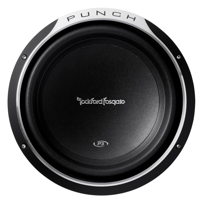

    I got two 10" rockford fosgate p3's dual 4 ohm. The guy at the place i bought it from has me down for a rockford power amp 500 watt, but i can change anything if i want to. Is that enough? I thought i would need like 800 watts. But I'm new to this type of thing.

    I have 2 10" rockford p3 shallows in my access cab tacoma. I have them running on 4 ohms with a 700 watt rockford amp. Its more than enough and can hardly turn it up. I'm sure 500 would push them well, as the max for those subs is around 300-400 watts each.

    Those subs are rated at 400RMS each so in order to get the "most" from them an amp around 800 watts rms at 4 ohms or 1 ohm would be good. Also, if you hear a sub "pop" at high volumes it is getting too much power/bottoming out and if you don't turn it down you will run the risk of letting out "the magic smoke" (in others words you'll blow it up)

    This Power T1000-1bdC does 700rms @ 4 ohms and 1000rms @ 1 ohm. They have been known for putting out more than rated power so personally I would run it at 4 ohms on those subs to be safe. :)
