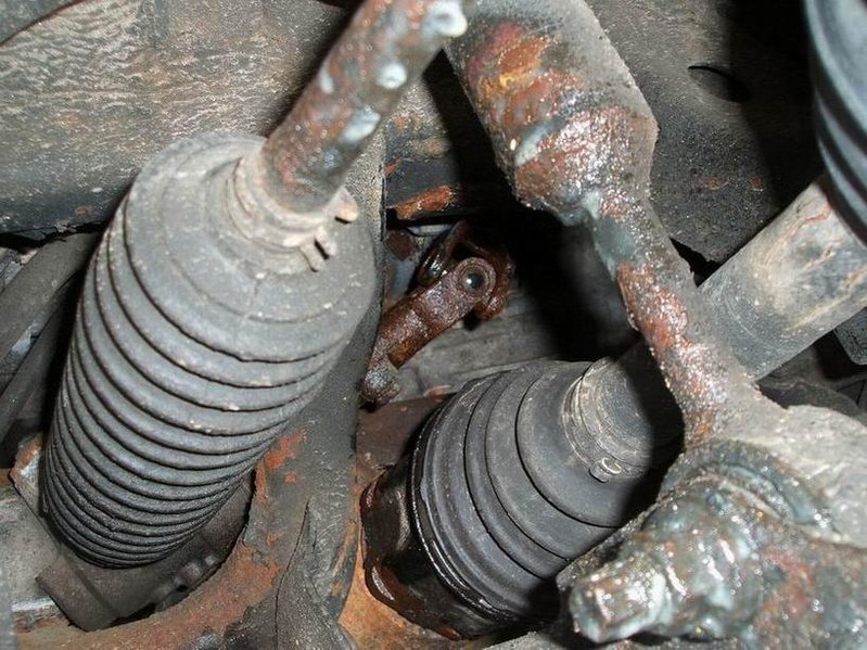

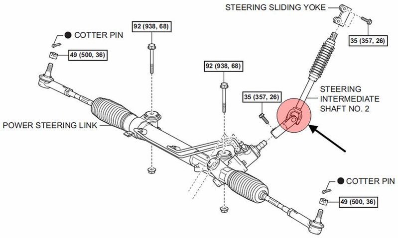

    My steering was getting a little stiff and (based on this thread) I did a flush in hopes that my power steering pump is ok. Fluid was gnarly! Totally black, no sunlight would penetrate it. New fluid helped, but steering is still stiff and every so often there is a chalky sounding squeak when turning that sounds like it’s behind the brake pedal. I’m guessing it’s the pump, but any thoughts would be appreciated. Thanks!

    Sounds like the joints in the steering intermediate shaft may be seizing up, @TnShooter can probably post a picture and link.

    Above CV axle on driver side

    Oh man. Never messed with that before. Thanks. Is that a lubrication issue, or will I have to replace it?

    I’d take a look and see if it is rusted first.
    Then soak it with some penetrating oil.
    If that helps your problem, then you’ve bought yourself some time until you can get it fixed.

    If some penetrating lube helps loosen it up great, but if it gets sticky again I'd replace it. Don't keep spraying it over and over

    I agree.
    Spraying it down is just buying yourself time.

    Thanks for the info! I’ve had a ton of rust issues. Evidently this truck spent most of its life in Saskatchewan and wasn’t very well maintained. I’ll keep you posted!
