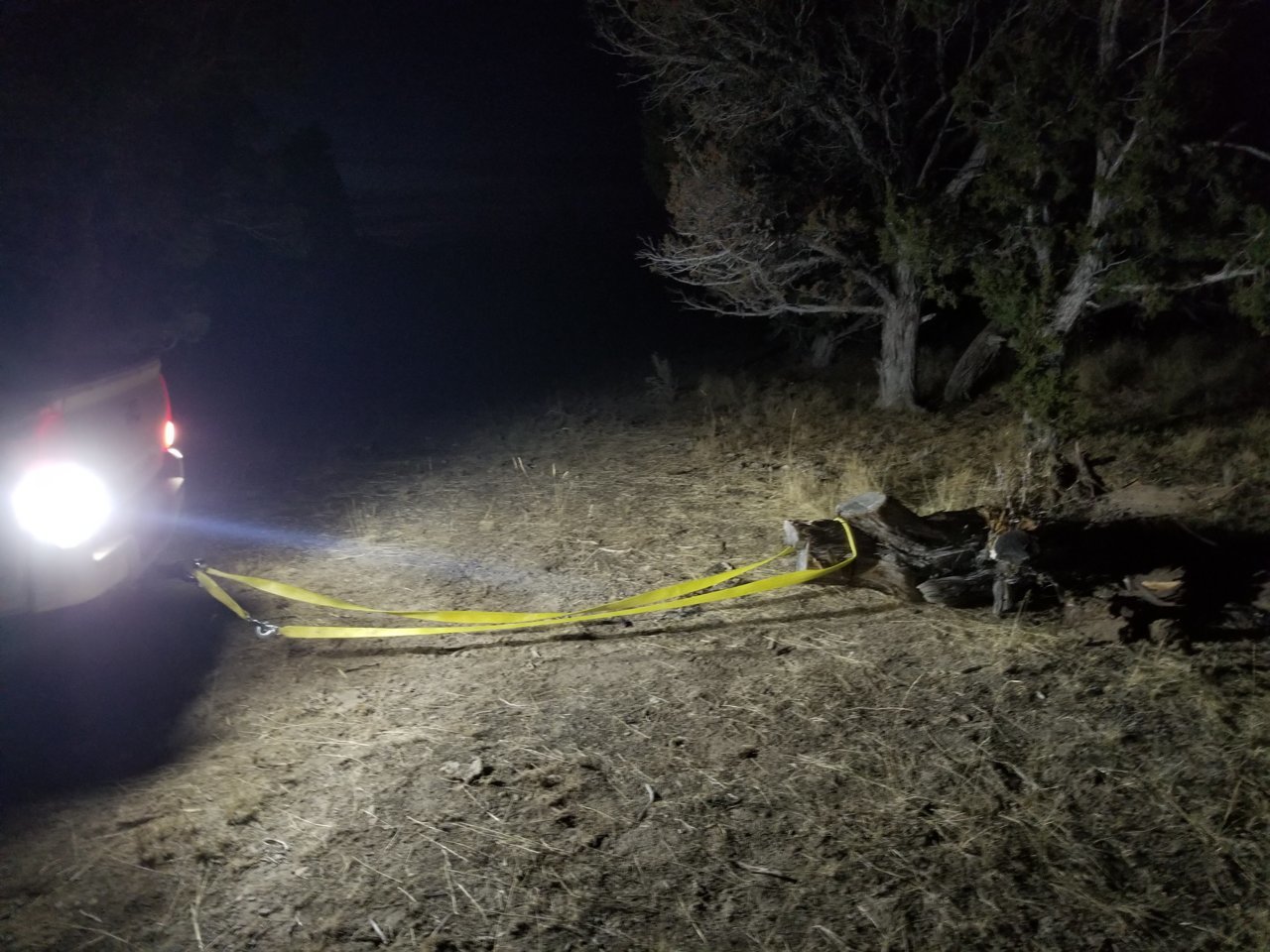

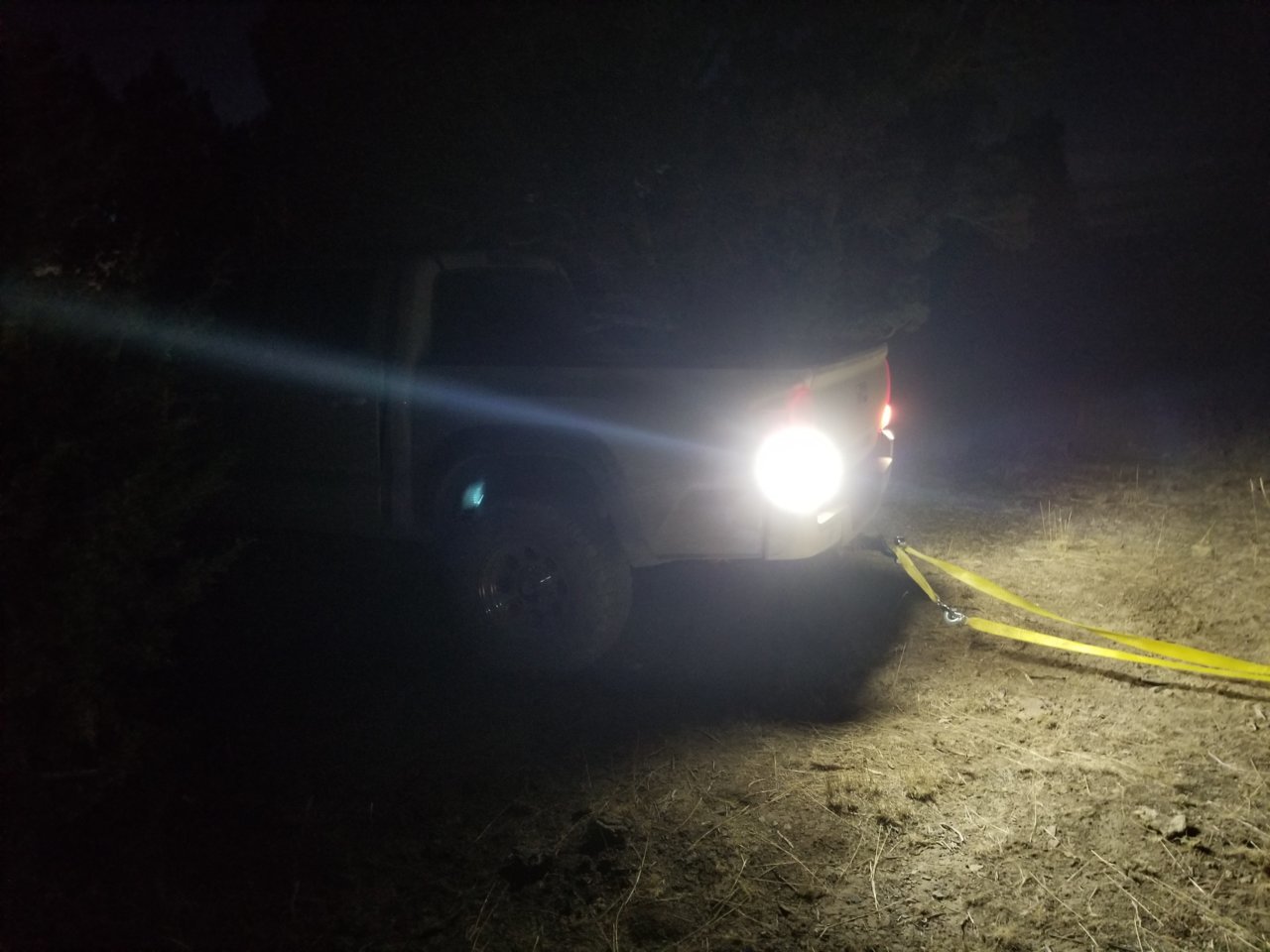

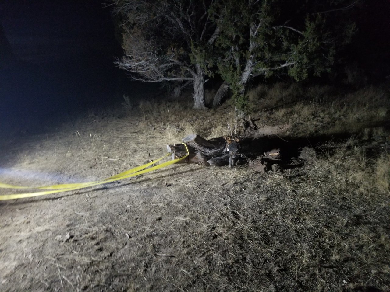

    I put one Baja Design S2 flush mount into my bumper;
    I put it on it's own circuit but you could easily wire it into the reverse lights.

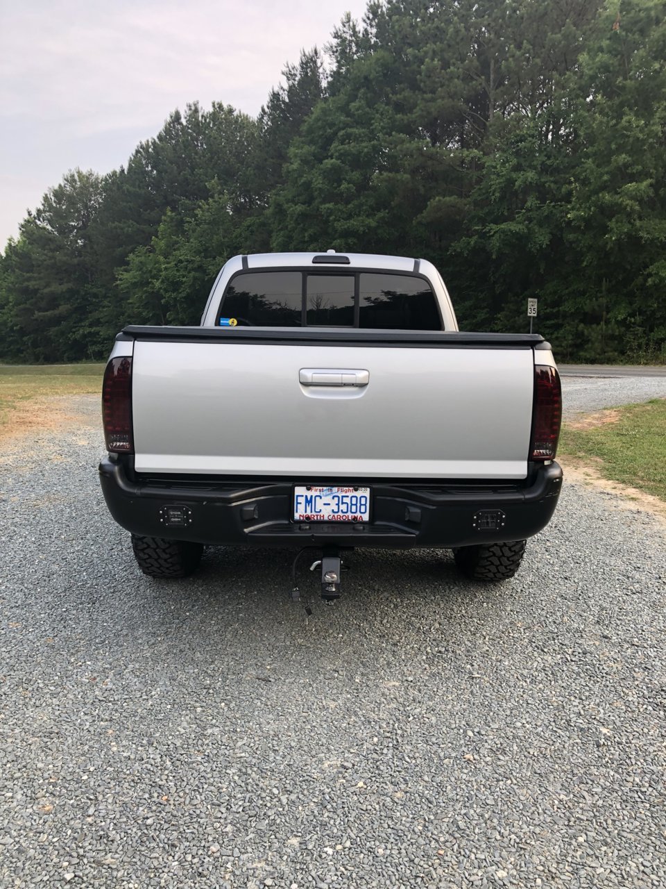

    eBay flush mounts

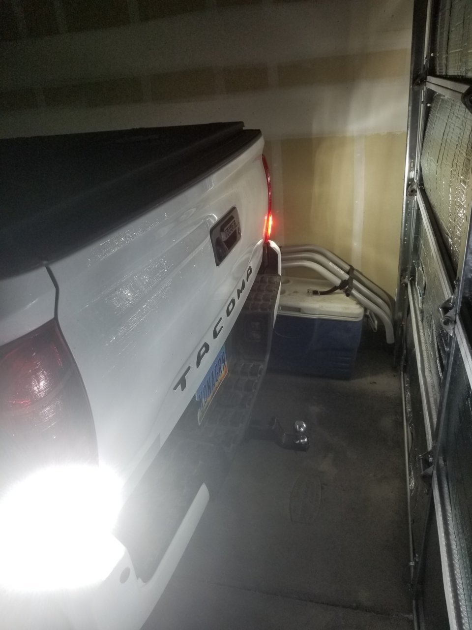

    Thanks bagleboy. These auxitos are bright!

    I wanted to buy these, but I've been told they tend to go out if you leave it in reverse for too long. I.E backing out of a trail

    LOVE this. What model? Thank you. Do you have a write up? I’ve been wanting to do this but semi nervous to cut into my 8 month old truck ha

    I picked the combo yellow lens for both distance and close;
    https://www.bajadesigns.com/products/S2-Sport-LED-Driving-Combo-Amber-Flush-Mount.asp
    Someone did an install how to for the Rigids in that spot. I poked around up there and found where I wanted it. Template came with the light, drilled the corners and then used a dremel with a cutting bit to take out the rest. It's easy, protected, and very bright.
    I chose to wire mine on it's own switch - and not tied into the reverse lights. I figured that using it for hooking up the trailer in the dark, and getting out of the ski parking lot in the dark made more sense to keep it on. I also was wiring in the BD interior light into the bed so routing the harness went in together.

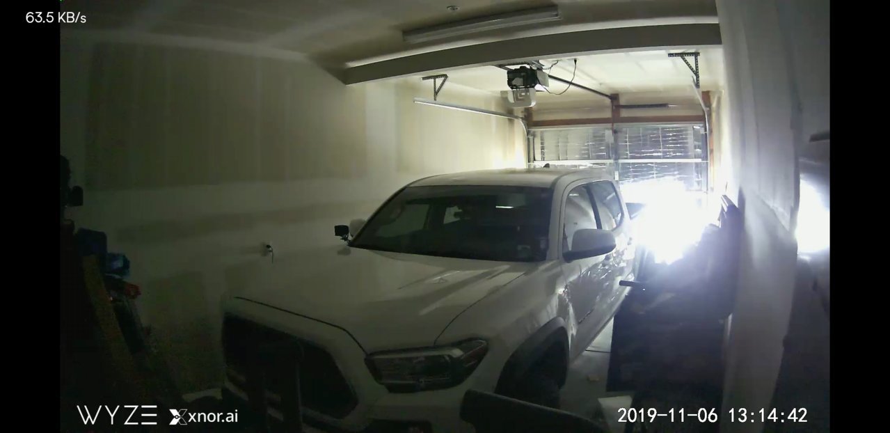

    I'll test em out for you. It's noon now.

    Still on at 1:14. I think they're good. Truck still started.

    Any night shots? Looks like rigid igniter, is it diffused, spot or flood? Thanks
