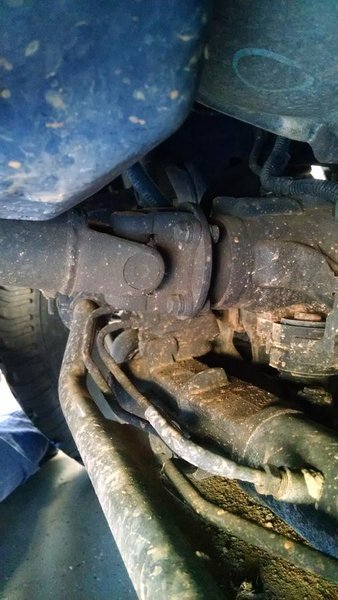

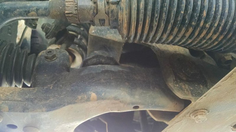

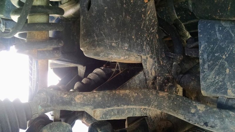

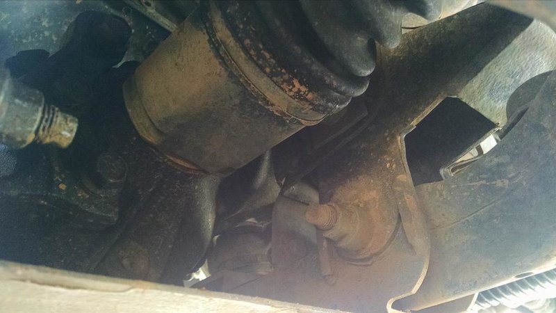

    I don't see any evidence of cutting so maybe it has been unaltered? uploadfromtaptalk1424284011363.jpguploadfromtaptalk1424284181598.jpg

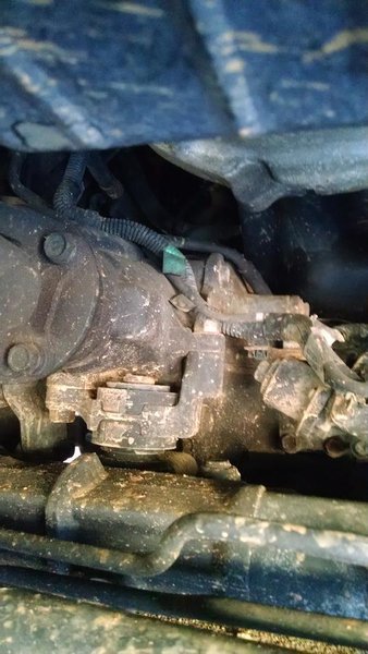

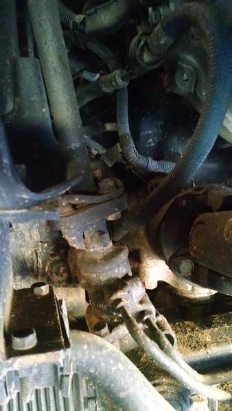

    take a picture of the rear of the differential where the driveshaft bolts onto the differential

    Done, it's a little dirty...uploadfromtaptalk1424293789222.jpguploadfromtaptalk1424293847043.jpguploadfromtaptalk1424293883628.jpg

    Your rear crossmember has been cut.

    You will have to remove all the pro comp parts and replace the large section of factory crossmember that was cut out which may be complicated since you don't have the piece that was cut out.
