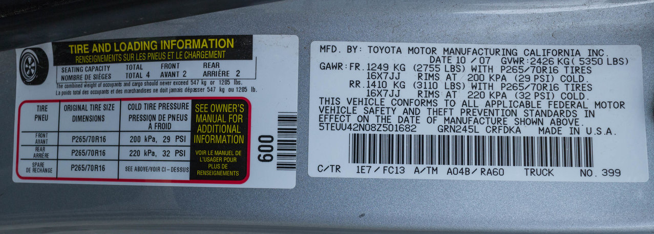

    It's on the build plate on your driver's door jamb. The 'G' part of GRN225/245/265 designated that you have a 1GR-FE engine.

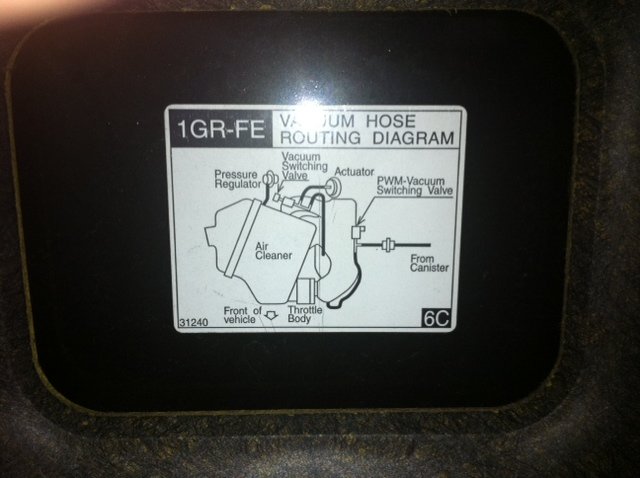

    But it's also under the hood on the emissions and vacuum hose stickers.
