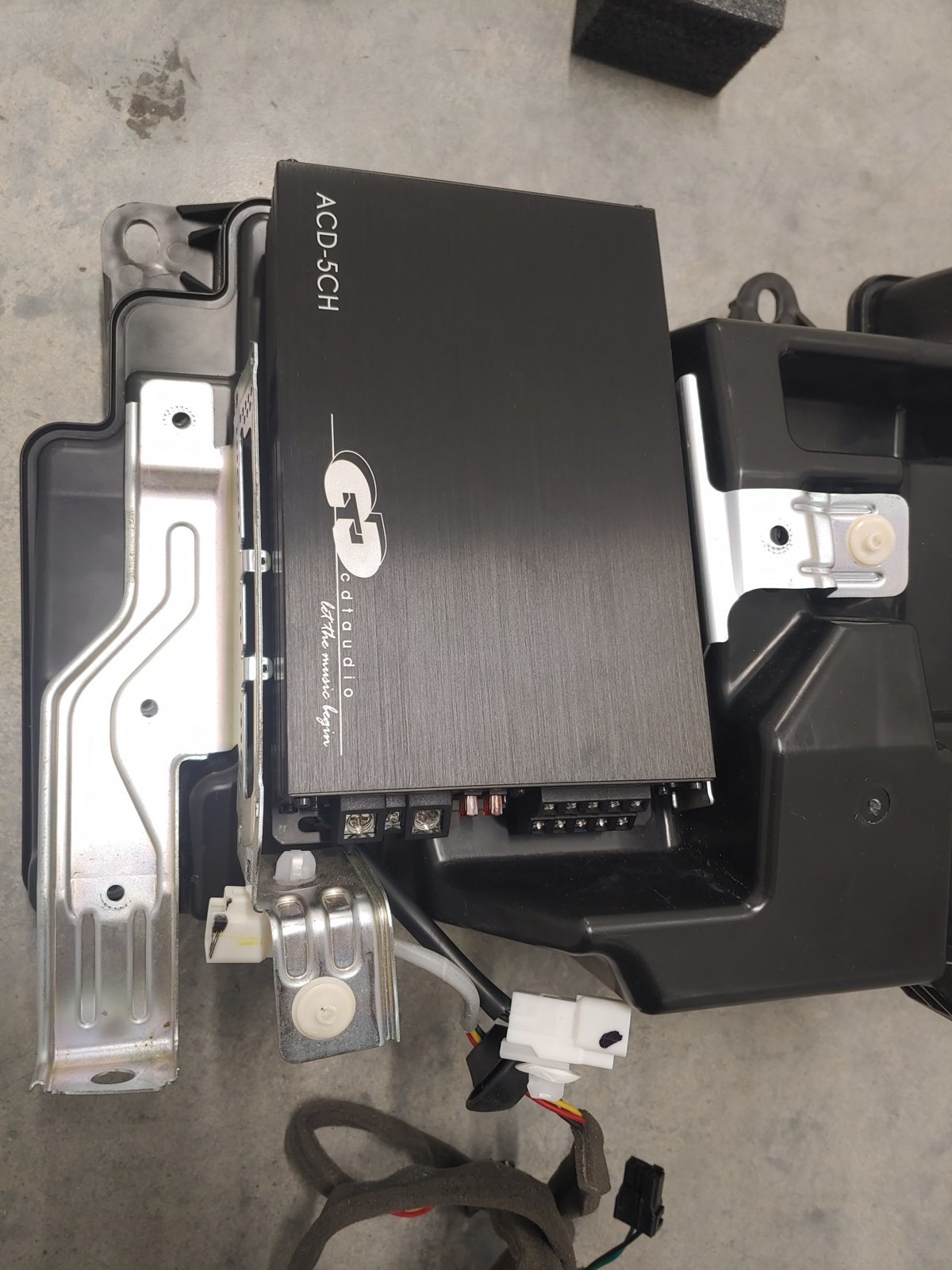

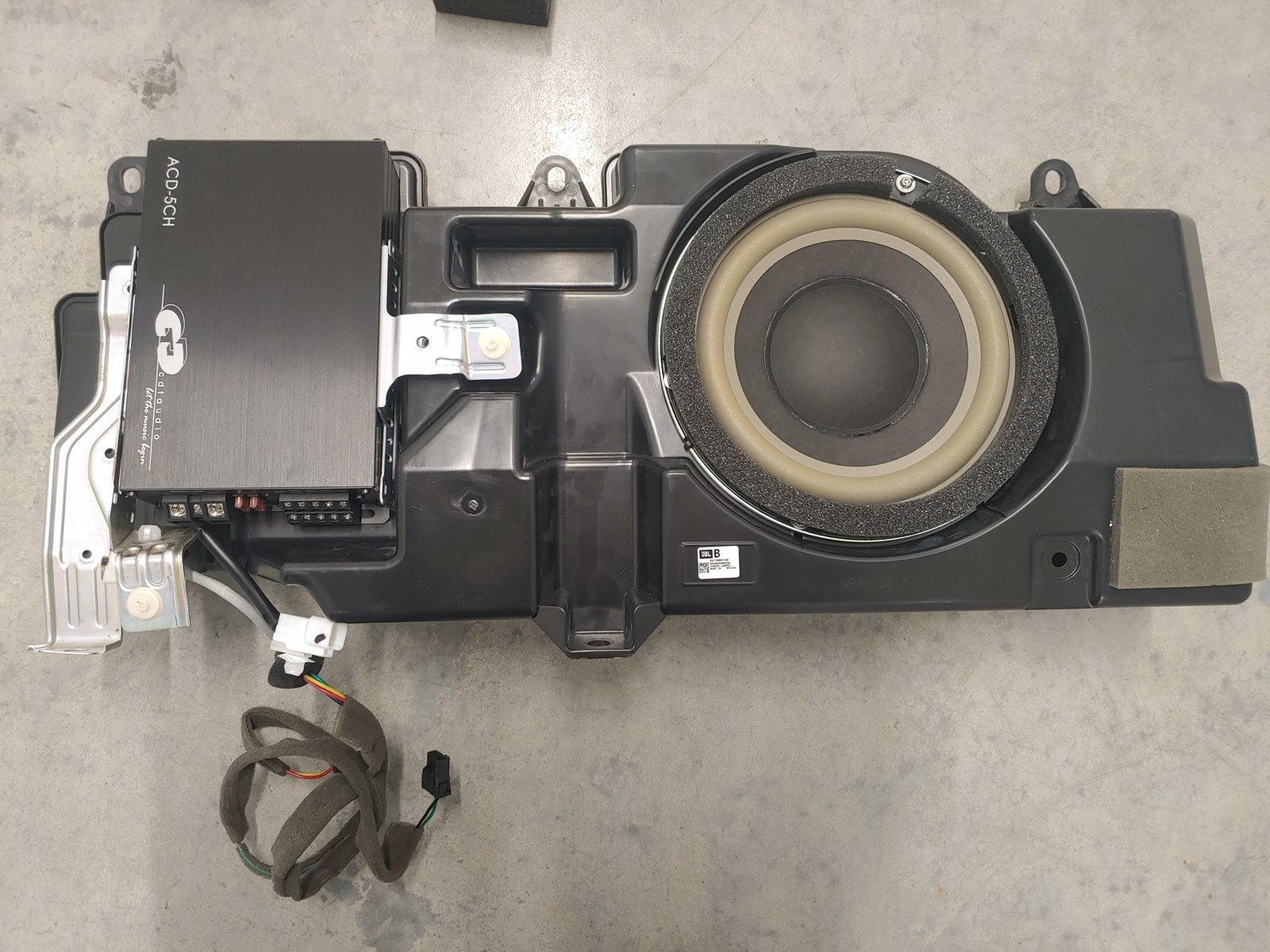

    I bought this one specifically because it fits in the oem location,
    https://www.cdtaudio.com/cdtnew22/products/components/amps/acd5ch.php
    Im gonna be 100% clear, I have not installed it yet and there is very little info if any out there, at least that I could find. I shipped it off to theamplab to have them test it for me and verify CDT power claims and still waiting to get it back with the results. Supposed to get it back next week sometime.
    I do have a pic of it in the oem location to show fitment, youd have to get a bit custom with the brackets to make a cradle with some vibration reduction but fits incredibly well
    JPTx and Rusty66 like this.
