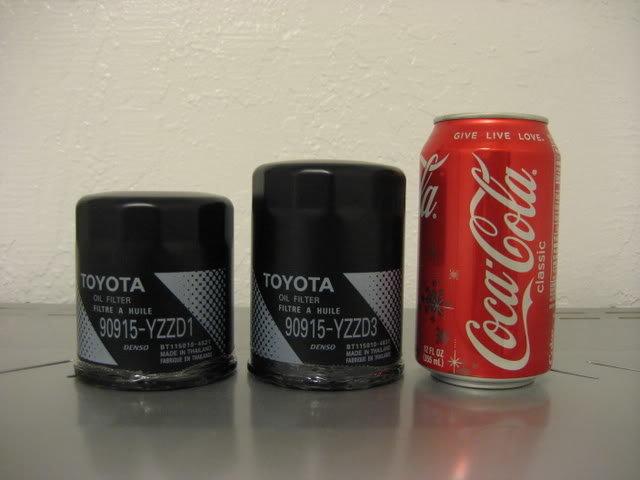

    You can use the 4.0L V6 filter on a 3.4L V6. It's slightly longer than the stock one.
