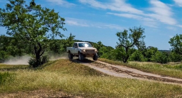

    I am running Icon 56501/56502 on my Dakars. They say they are for 0" to 3" lift. Stock bumpstops. No issues. Feel way better than the Nitrochargers to me.
    9.5"travel
    13.55" compressed length
    23.05" extended length

    You beat on the truck at all?? How impressive is the rear setup ?

    Ran it about as fast as it would go (65mph flat sections, and jumped the shit out of it) on 2 back to back 37 mile runs, and a short course in the second half of the day TRR in May. It made the shocks pretty hot, but the seals held and there was only a little fade. If I were to do it again I would get the reservoir version of the same shock. I run it as hard as it will go, and daily drive it. I keep a full set of tools in the bed box also (200lbs). I was and still am pretty impressed with I just need more oil for combatting heat soak and fade. Other than the resis, it's as much as you can get out of it with the shock mounts still in their stock locations.

    Nice man, that's badass. What front setup are you running ?? So you just have the icon 0-3s no resis?

    Fronts are extended travel King 2.5 coilovers (600# springs) valves by Micah @Downsouth Motorsports on Total Chaos arms poly bumpstops. The rears are Icon 2.0 no reservoir part number: 56501 and 56502 (left and right are different for stock mounting locations). And Dakar leaf packs. Braided extended brake lines all around.
    I learned the hard way about not carrying tools. I live rural so there is no help coming.
