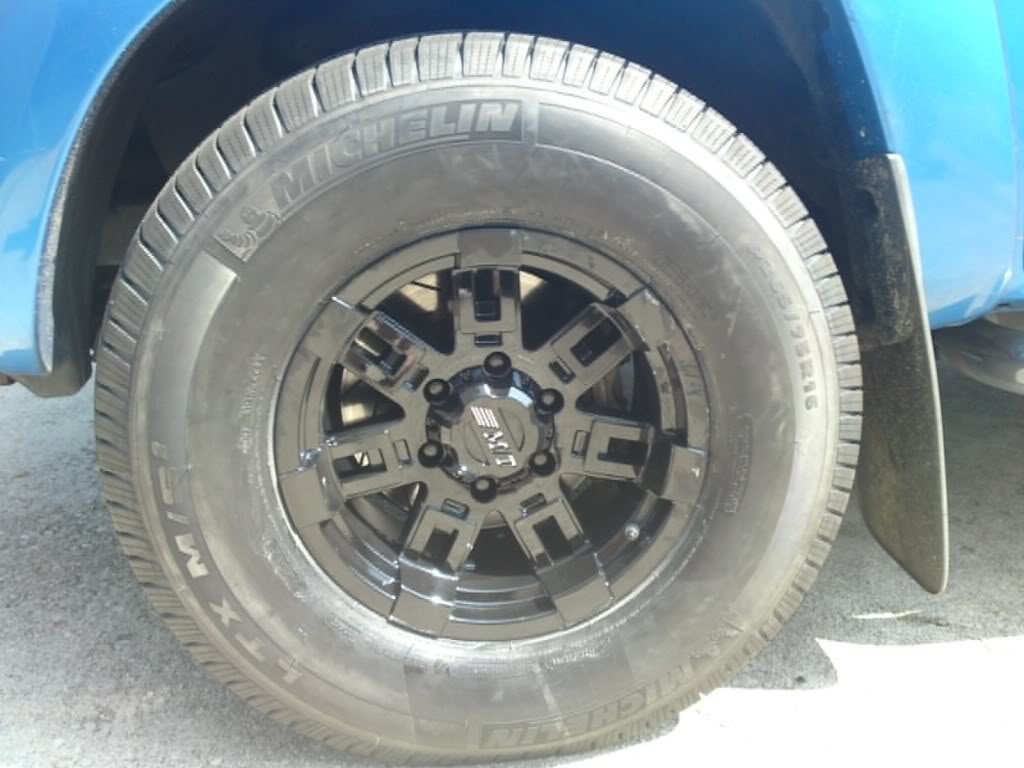

    I have the Gorilla's in black as well. You'll want 12mm x 1.50 RH conical seat. Summit Racing sells the set with the locking wrench for $64.99. If you want other colors, chrome, etc. they have those too.
    Summit Part number 71634NBC. Pic is before lift but you get the idea.
