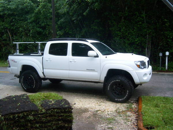

    These wheels are -6 offset and 4.75 bs and look really nice on the truck. They definitely do have a wider stance...you wont be disappointed.
