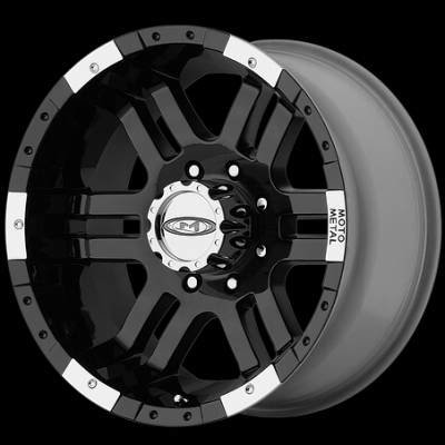

what size/lug pattern do i need if i order this wheel?
Discussion in 'Wheels & Tires' started by TacoTitan11, May 21, 2012.
  1. May 21, 2012 at 5:31 PM
    TacoTitan11
    TacoTitan11 [OP] Well-Known Member
    Nov 28, 2011
    #67842
    579
    Mr. C
    North Carolina
    2012 Tacoma
    i have a 2012 double cab prerunner v6. i have 16 inch steel wheels. what size do i need to order as far as lug pattern goes. i think these are moto metal 951s. thanks i want to stick with 16 inch size. also, if i got a larger tire, what the biggest i can go on stock size.:D

    this is a 16x8 wheel. my current wheel is 16x7
  3. May 21, 2012 at 5:38 PM
    tostidos
    tostidos Well-Known Member
    Dec 24, 2010
    #48149
    4,755
    Apple Valley, CA
    07 LT 6spd
    6 on 5.5
  4. May 21, 2012 at 5:57 PM
    TacoTitan11
    Nov 28, 2011
    #67842
    579
    Mr. C
    North Carolina
    2012 Tacoma
    is that like 114.3?

    Not it is more 6x139.7

    I think these are one in the same if I remember correctly. I have them too. I stayed with the stock size for the 16's personally. I got mixed opinions of going with a 265/75/16 about them clearing and not. So for price, mpg's and knowing they wouldn't scrub I stayed with the 265/70/16. Search the forums for more opinions. I know they're on here because I read about the same questions when I did mine.

    Just so you know, you will need new lugs as well. The set will cost you around $25.

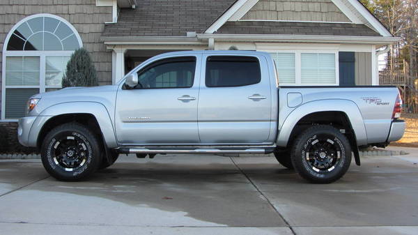

    good looking setup Mr. Opponent ! what kind of tires are those with the wgite letters you got? do the 265/70's rub???? or is the 265/70/16 the best size

    Stock size 265-70-R16. But they are the BFG All Terrain T/A KO. Not sure that the larger 265-75-R16 would clear at full lock or at the fenders...
