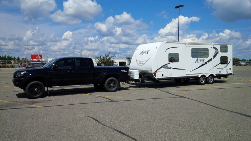

    I pull this around all summer, it's dry weight is around 4300lbs and is 23.5'. Even with a head wind the torque convertor stays locked in in fourth around 60mph. I added a bigger tranny cooler and use factory wheels/tires when I pull it.
