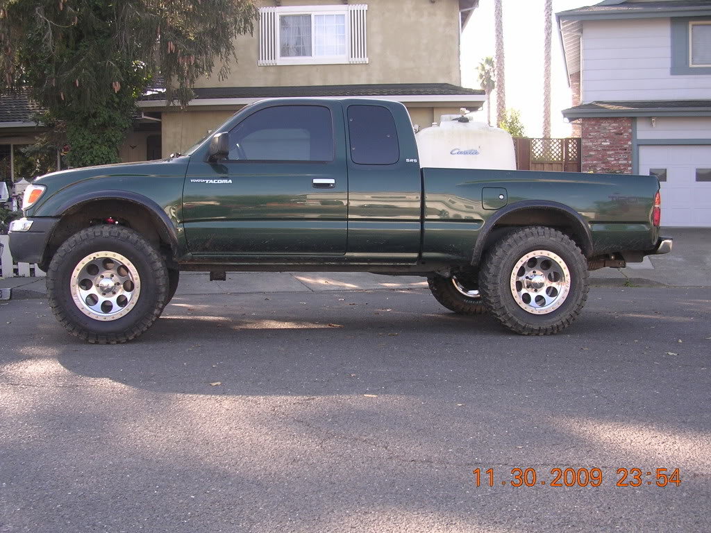

    I don't know if i can help cause mine is a fist gen but i have a 1st gen and i have the same size rim and tire and i have the Camburg 2.5 up front cranked to about 3in and the 5100s in the rear and i had to trim the front a bit... i have no spacers just the wheel offset of 4.5, i would not try and run spacers i have heard a lot of bad things about them if you are going to go off road or anything.
    here is a pic
