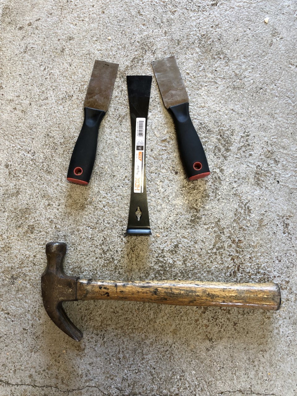

    It took just the lightest bit of prying. It was definitely the alignment dowel on the driver side.
    The paint scrapers were super helpful, especially in gauging where I was still tight. 1 scraper fitting is good, 2 scrapers is progress. In super paranoid of damaging stuff so my prying solution was to use my 2 paint scrapers combined with a tiny pry bar from the home Depot paint isle.
    I inserted the two scrapers then tapped the pry bar in between the two. The wedge shaped pry bar tip really only contacted the steel scrapers so I wasn't concerned with damaging the bell housing.
    I widened my gap on the driver side where the pin was stuck, then moved over to the passenger side and slightly wedged it a little. I felt something the immediately let me know it was ready to come out.

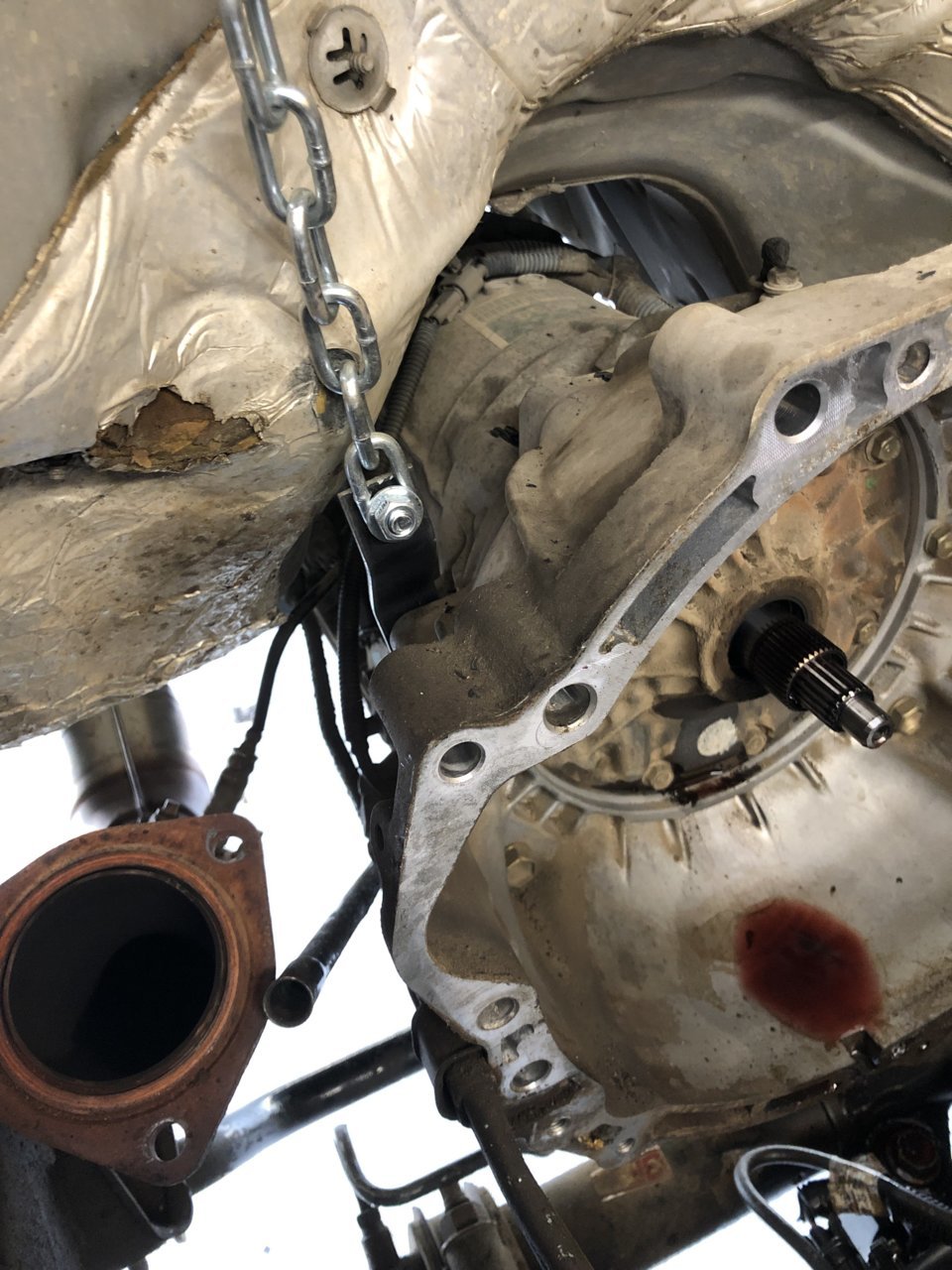

    Yeah I got a sweet tip on Tacomaworld from a guy about supporting the transmission. :thumbsup:

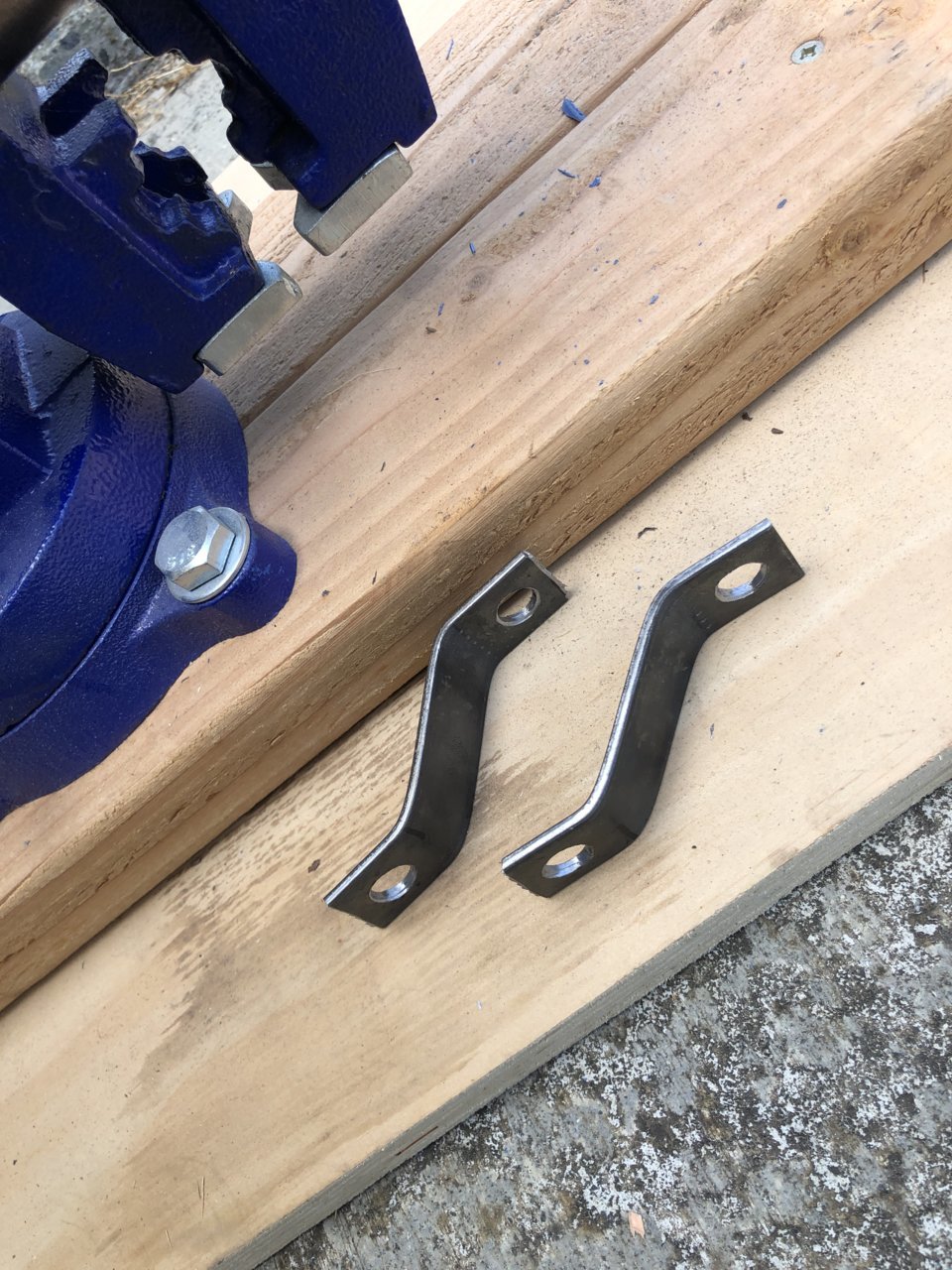

    Did a little metal fabrication today as well:
    Those are my brackets I used to hang my tranny.
    CS_AR[QUOTED] and Dalandser like this.

    They look GREAT! I think you need to start SELLING those brackets.

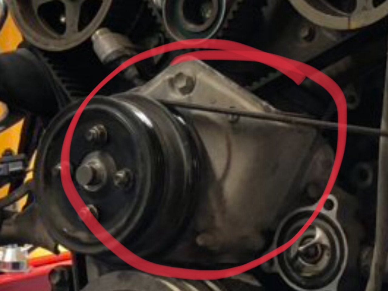

    If it has not been brought up you might consider a new fan bracket bearing assembly.
    You can’t buy just the bearing, you have to buy the complete bracket with bearing.
    Rockauto price for Asian is 100 or so.
    They can fail anytime after 100,000
