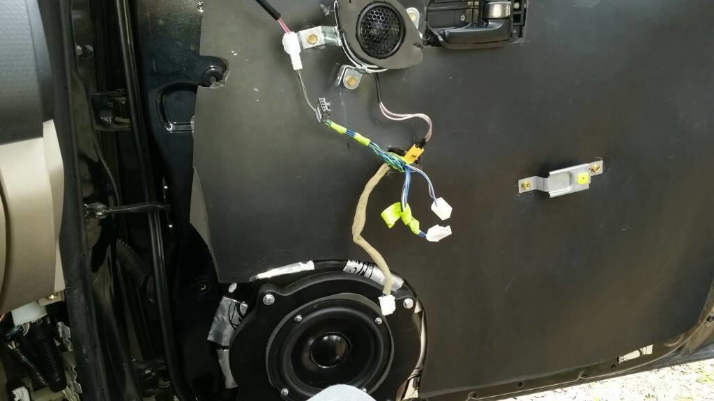

    I just finished the sound deadening and running all the cables for my amp/sub/audiocontroller setup. I am going to do a whole build thread when I get it done. I have done Dynamat, DynaLiner and acoustic foam everywhere except the headliner area, but I will do that later. I am running Focal Performance 165V components with the 165 coaxials. I have a Kenwood Excelon KFC-1000W sub with an Alpine PDR-V75 amp with a AudioControl LC6i to use the stock headunit. I am wiring running the speaker wire to the doors tomorrow and installing everything.
