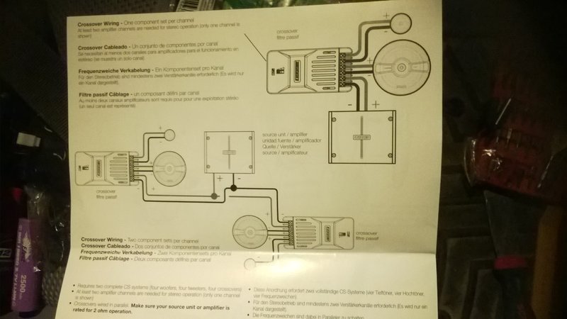

    I just want door speakers and tweeters because my passengers side speakers are blown, I purchased a front door kit with kicker kss67 kit and mounts through *********, I plan on keeping the stock hu, the kit came with crossovers, do I need to install those too? I'm not planning to add an amp or sub

    Why would I need to? And where would I hook them up to if I'm going to keep my stock hu? The diagram shows I need to have an amp, can't I just use the speakers as just speakers and tweeters?

    The crossovers route the proper frequencies to speakers to not only protect the tweet, but keep them from sounding harsh. You don't need to have an amp although at least a little more power would help dynamics.
    The crossovers go before the speakers. It splits from there. Behind the door panel in a nook somewhere safe from moisture would be ideal.

    Ok, I'm trying to understand.
    The tweeters have individual connections going to them, do I not connect them to the original connections and connect them directly to the crossovers and as well as the speakers?
    I feel I'm over thinking this, I just feel confused by the wiring instructions provided by the kit

    Here's the kits suggestions

    Yes. Now in your mind, erase the amp and place the headunit in it's place. The wiring is already in the door. Stock wire to crossover. Crossover to speakers. Simple.

    Would I need to run both stock wiring from tweeters and speakers to xover? Or just the stock wiring from the speakers? Hopefully that makes sense

    Only the stock wiring feeding the crossover. From the crossover to the speakers use new wiring
